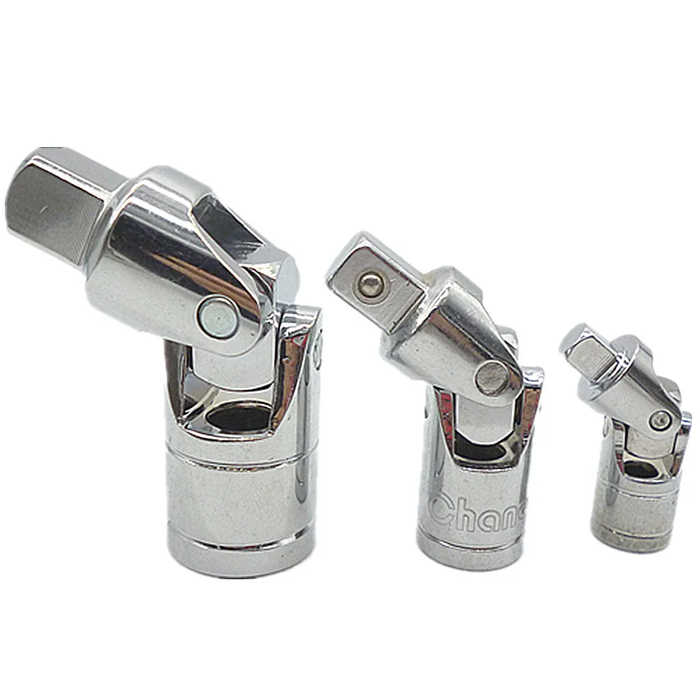

Well when i had to replace my starter on my 05 Colorado i had to remove the manifold to gain access. I did not touch the alternator and serpentine belt to get this done though. You will have to remove the wheel well cover to gain access to the a few of the bolts underneath the manifold. What really helped me out a lot was some swivel sockets like these and some extensions. As for the battery and battery box i removed them just get to a better angle on some of the bolts.

If your just checking/tightening bolts, should be able to only remove battery and box. Part of the process to remove the intake manifold is to remove driver's tire and wheel well cover, but that's only so you can get to the bottom bolt to remove the alternator. Might be able to get to the first manifold bolt behind the alternator using a universal joint and playing with different lengths of socket extensions.
