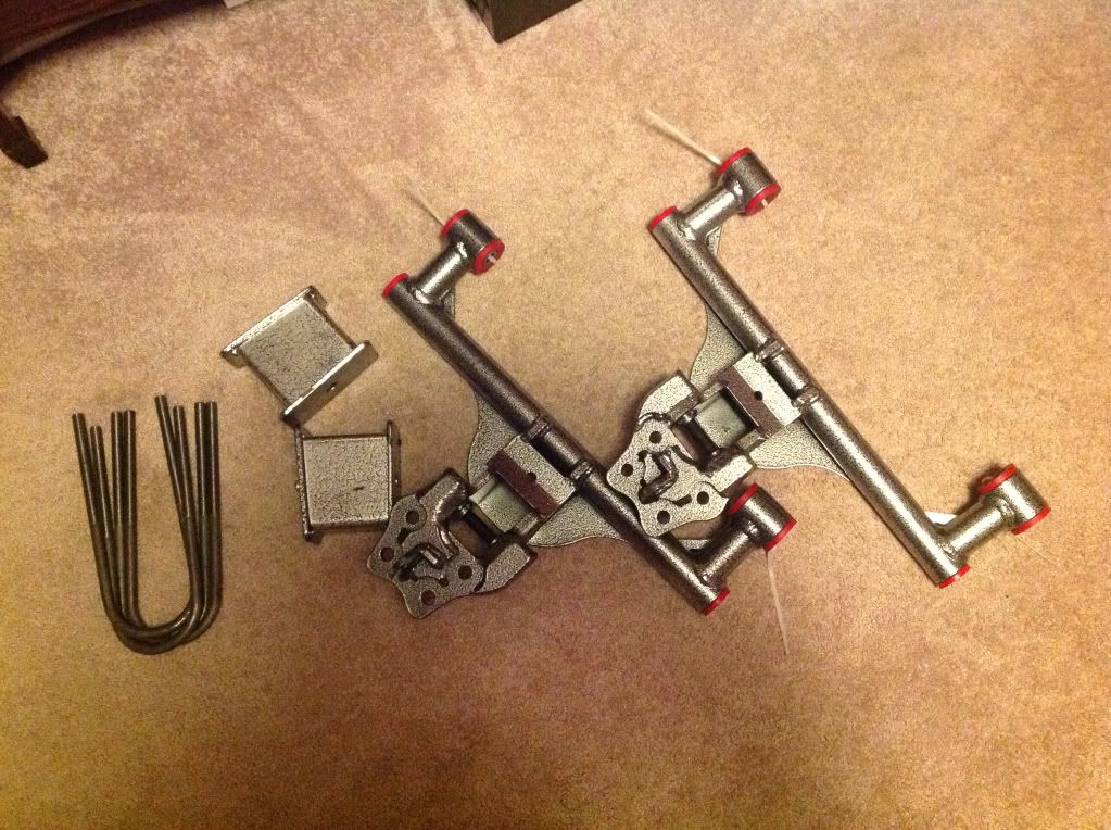

Ordered a DJM 3/4 kit (arms/blocks) from SS Colly earlier this week. Should be in tomorrow!

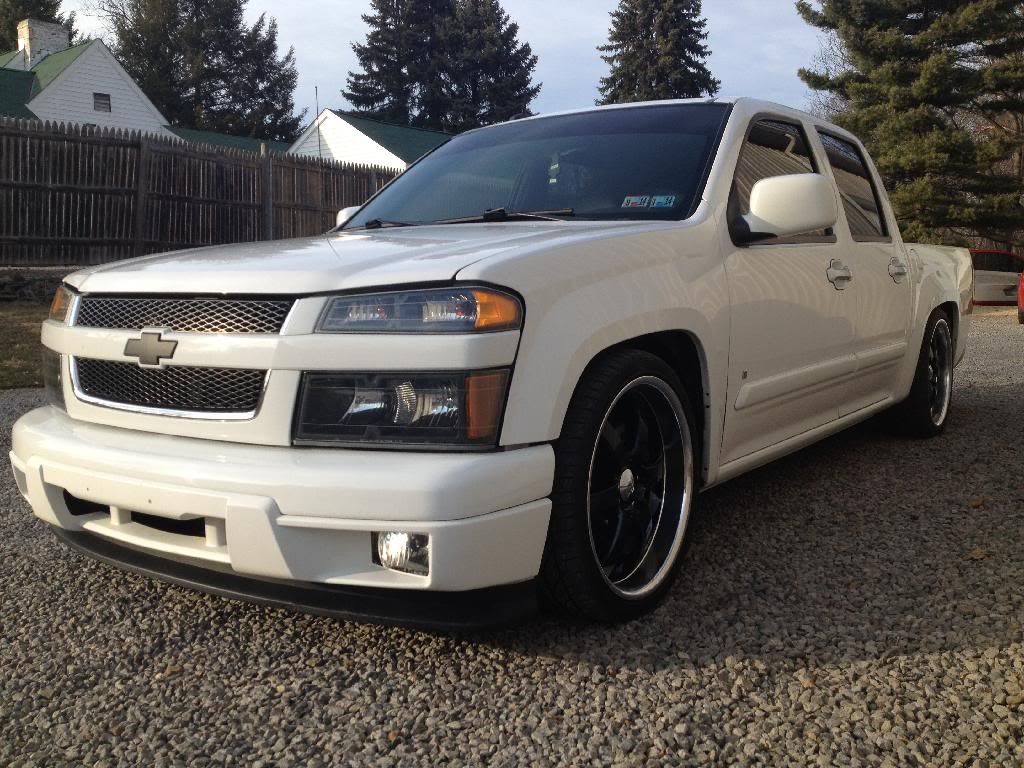

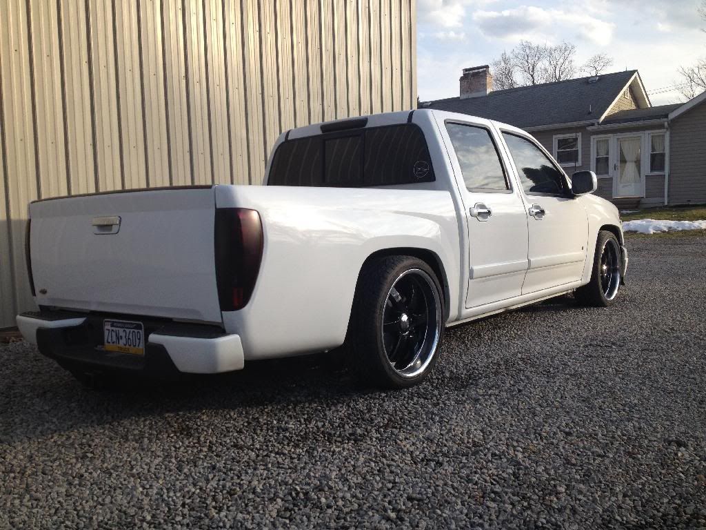

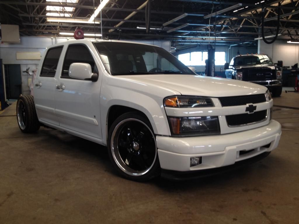

Got her closer to Mother Earth over the weekend. As of now its resting on the smaller bump stops, so the next step is to notch the fame.

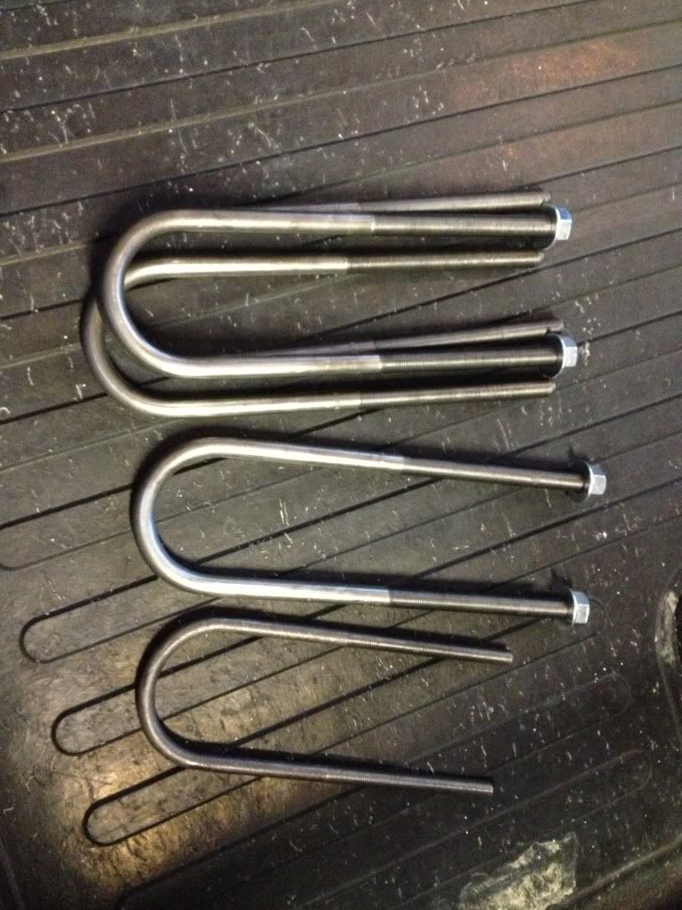

Front was easy peasy. Rear didn't go as planned due the junk u-bolts that block kits come with. So I had some beefy ones made
Mid way through with my uncles canyon
Filthy, post lowering, glory shot
In the weeds...
With my brothers S10

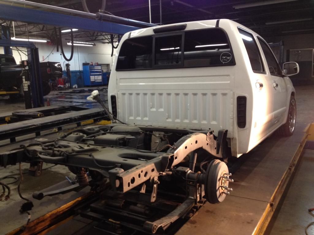

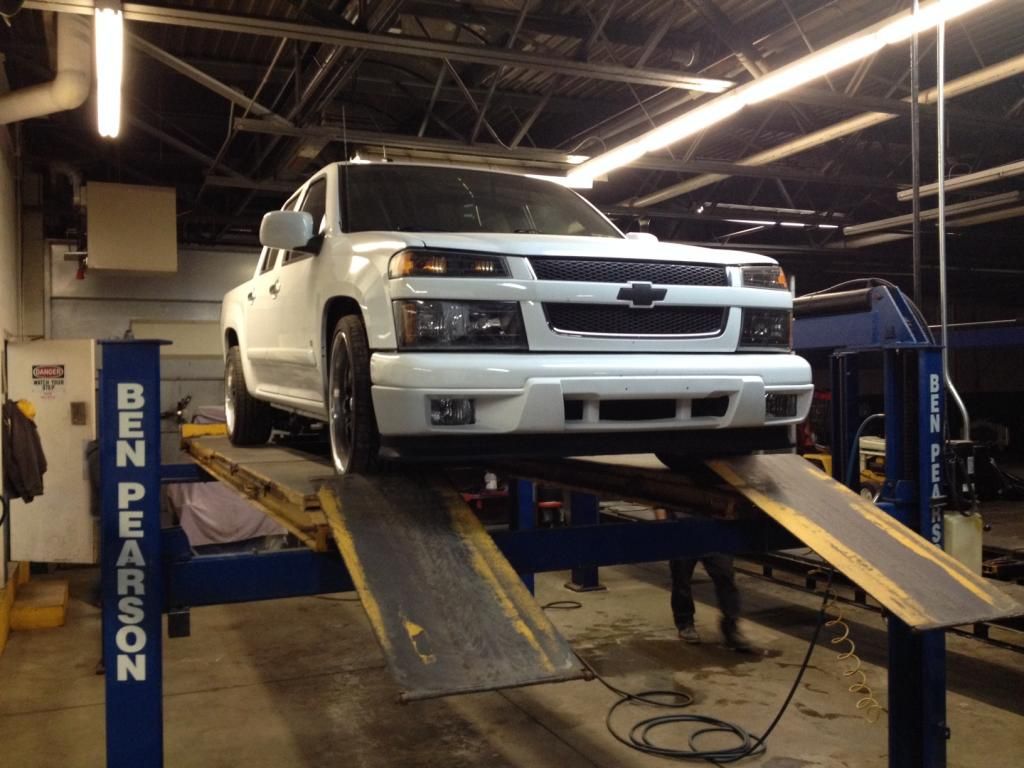

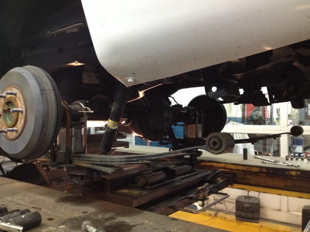

Got her up on the rack. Dropped the rear end a little by unbolting the rear leaf hangers.
Bed off.

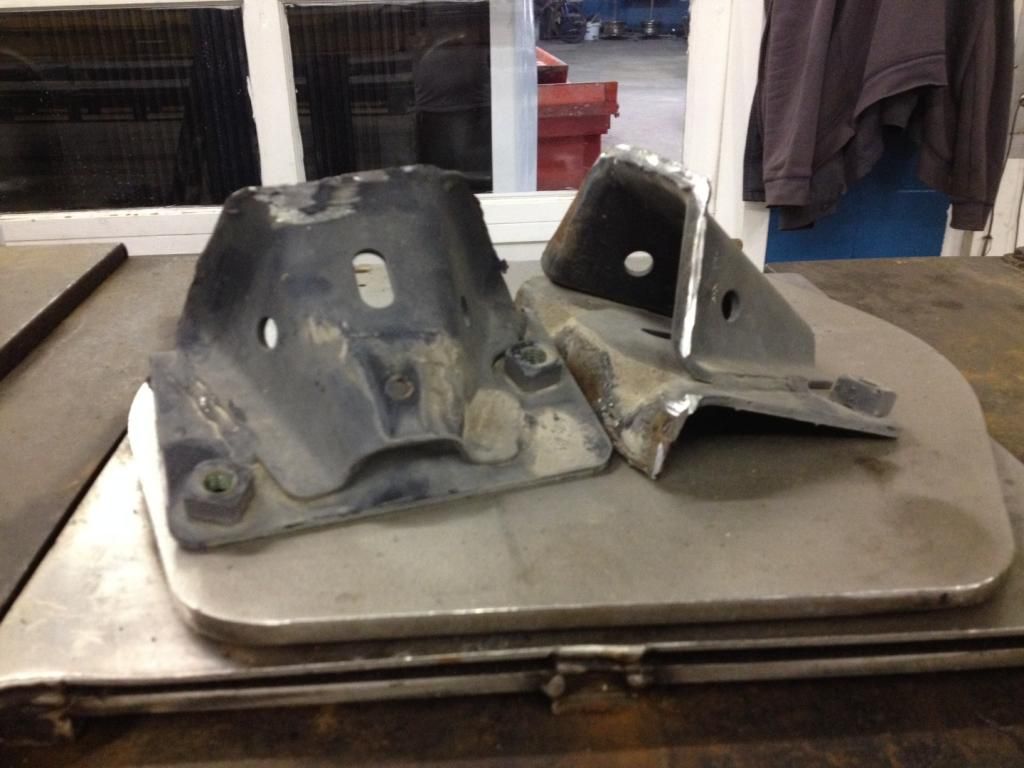

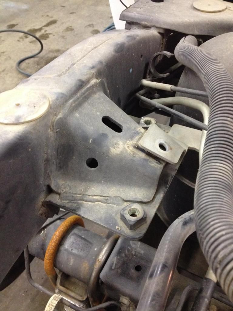

Bump-stop brackets. These had to go. I don't have a picture, but an extension bracket had to be made for the brake lines.

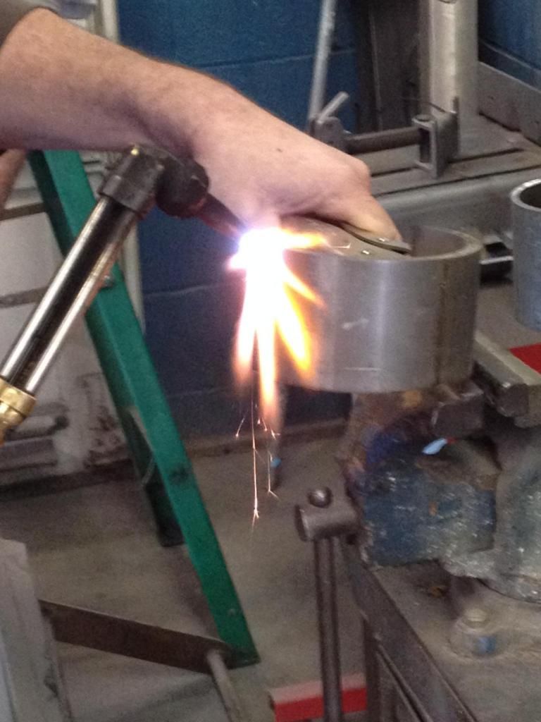

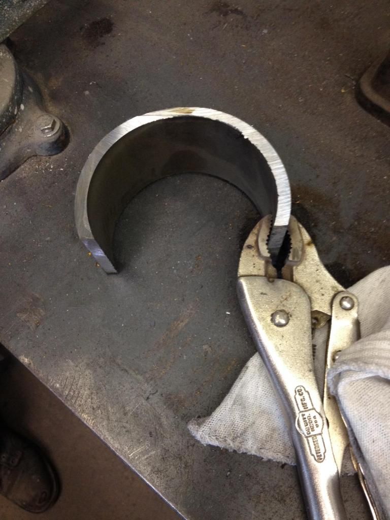

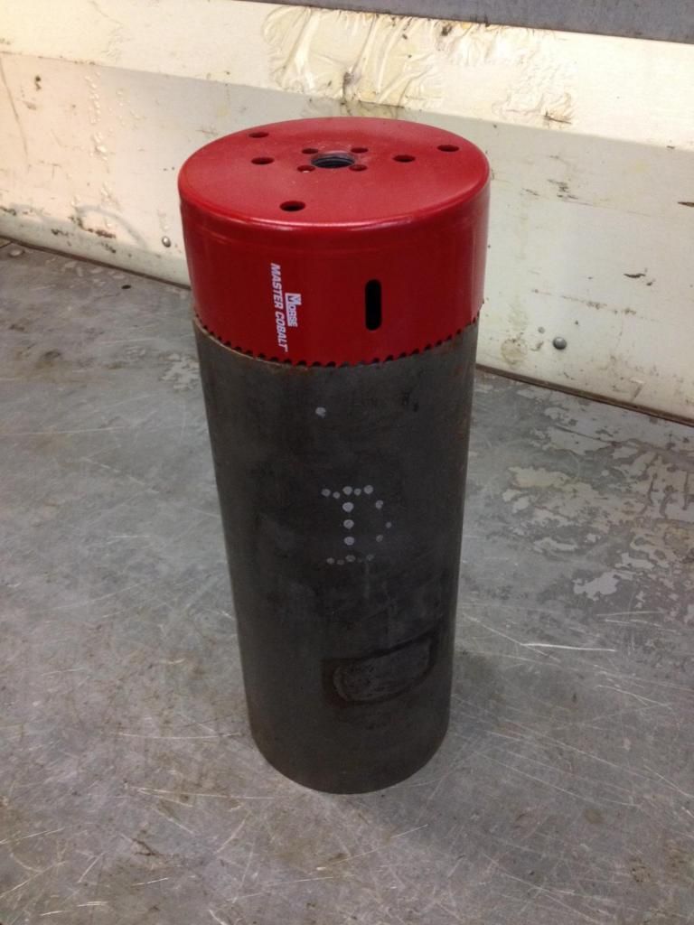

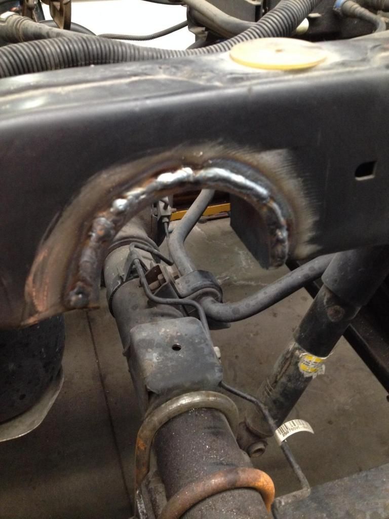

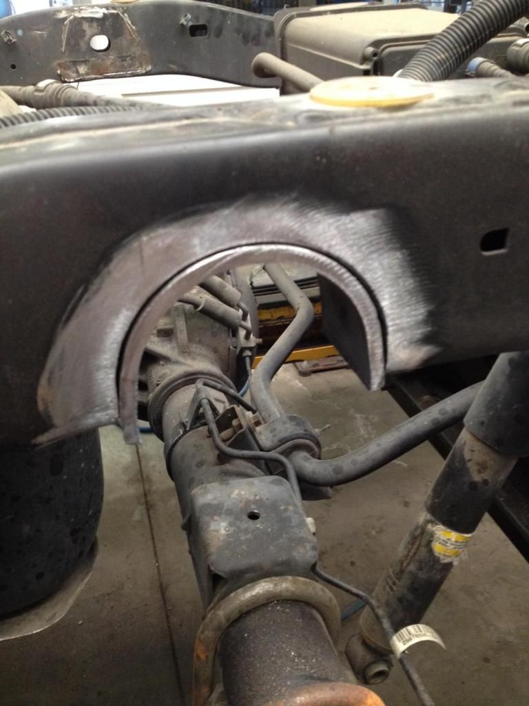

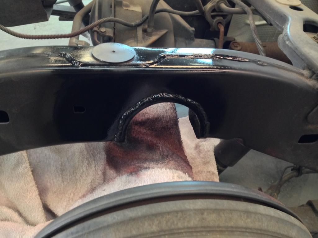

Notch material. 4in pipe with 1/4" sidewall, giving a 4 1/2" OD. That's a 4 1/2" holesaw on top.

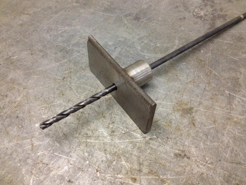

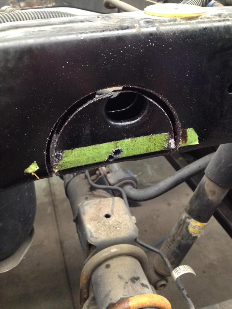

Used this little jig that my dad's friend made. It clamps to the side of the frame so you can drill a nice, straight pilot hole.
Cut the pipe down to 2 1/2" wide, and zipped off some of the bottom. Then heated with a torch to straighten out the bottoms.
Marked the pilot hole using a bob centered over the axle. The hole is 1/2" from the bottom of the frame IIRC. Right where the frame had to be cut, there is a 3rd wall in the middle. What a bitch that was to cut. The hole-saw is missing some teeth needless to say.
Got everything ground down and test fit the pipe.
Welded up.

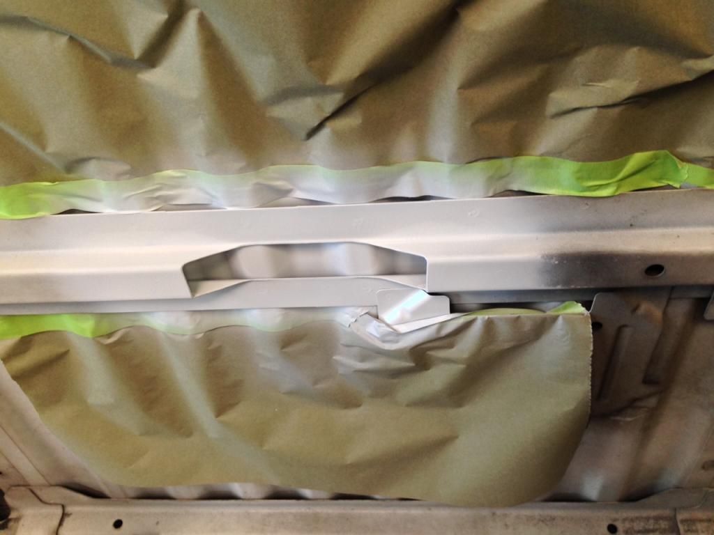

Notch in bed brace for extra clearance.
Back on the ground. :bestest:

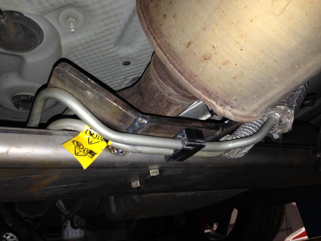

Next step is to tackle a JTR lo-pro tranny cross member.

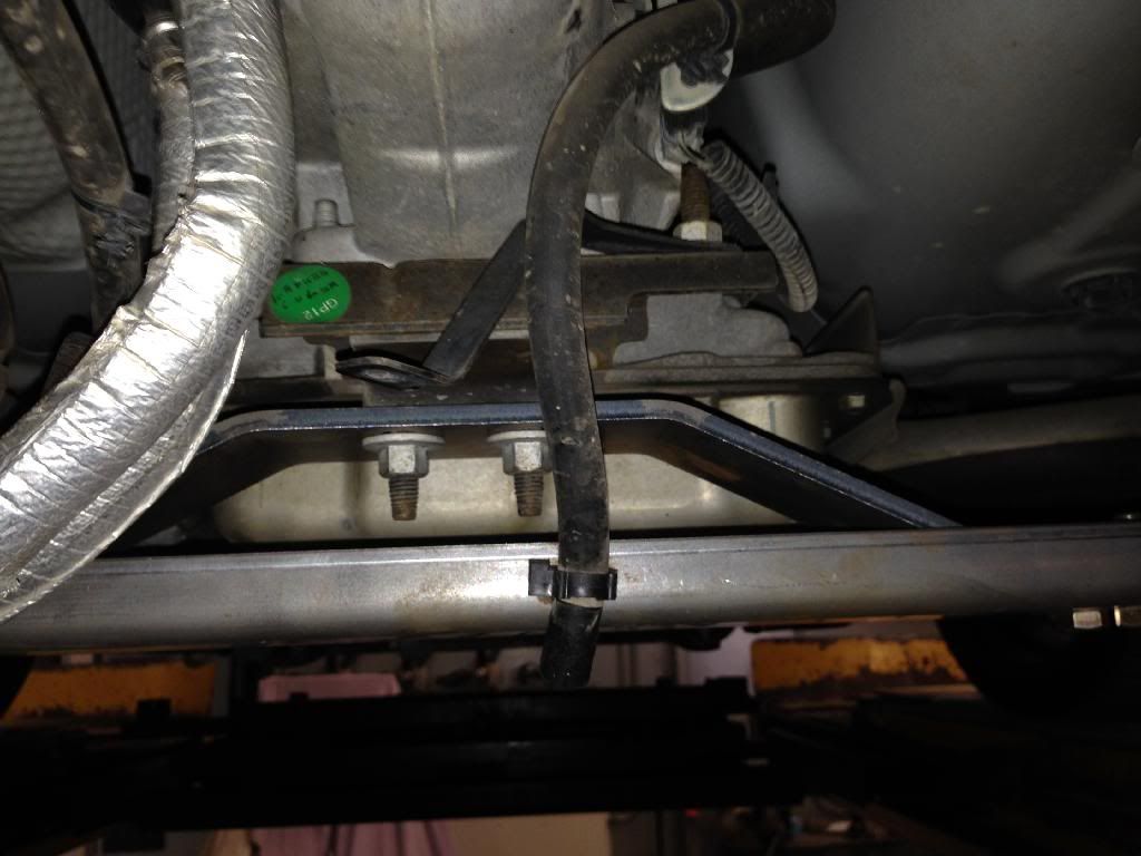

I wasn't able to make it to the shop this weekend, but my dad kept making progress. Got the JTR crossmember on. He had to fab up a couple extra brackets to address the fuel lines. I plan on getting it powder coated so I'll take some better pics once it comes back out.

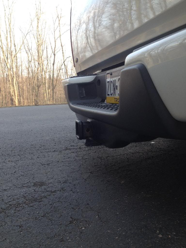

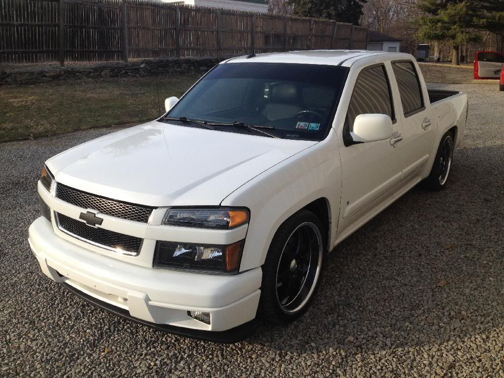

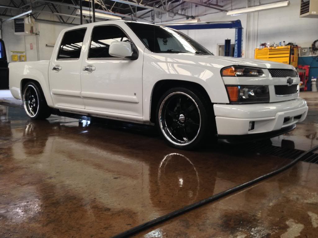

Finally got to take it out on the highway for the first time since the drop. It rides much better than expected. No rubbing other then the plastic fender liners so far. Going to toss a couple spacers in the front to level it out from side to side.
My hitch drags allover the pace though...

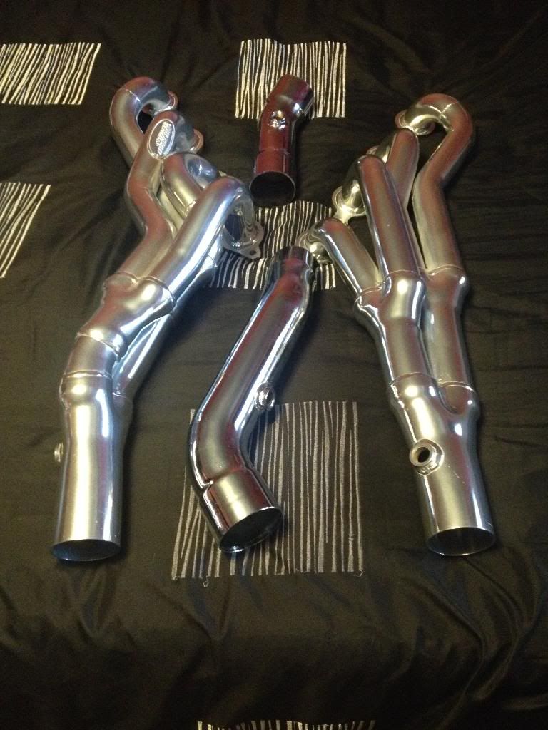

These showed up!
Got the headers in, and truck should be getting exhaust as I type this.

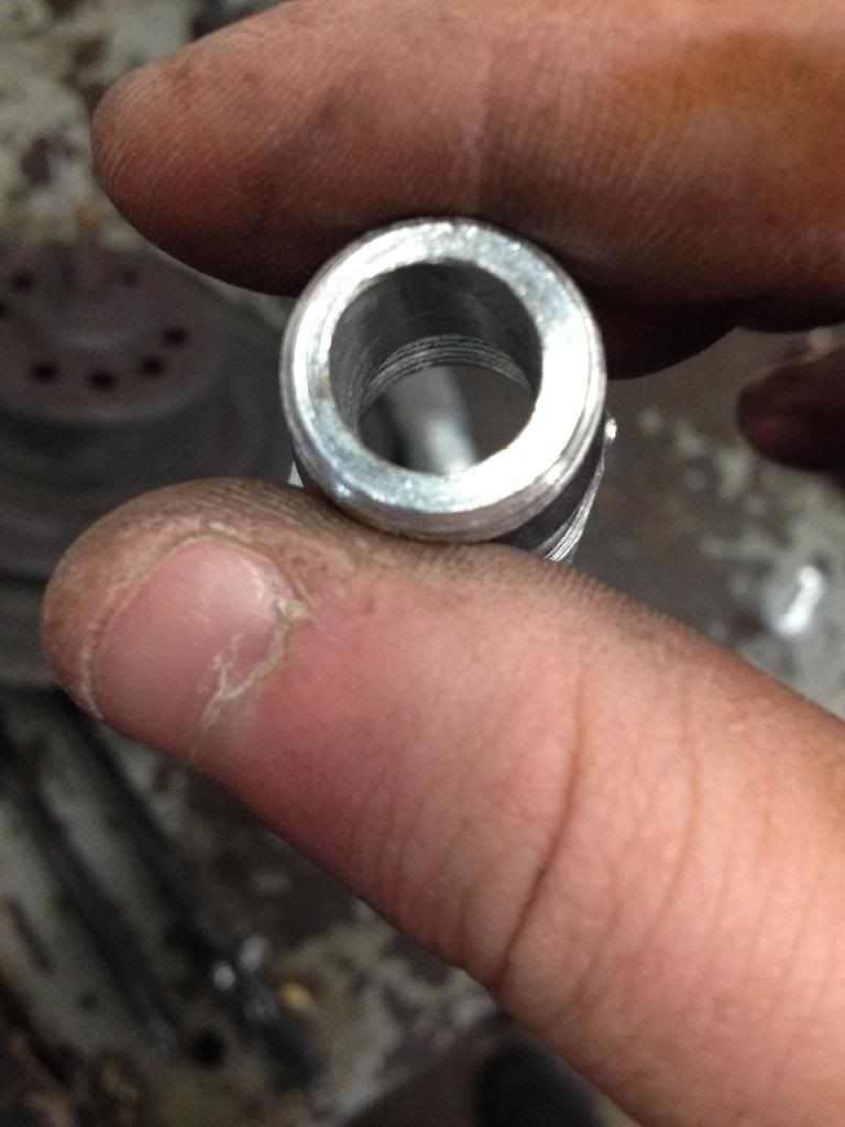

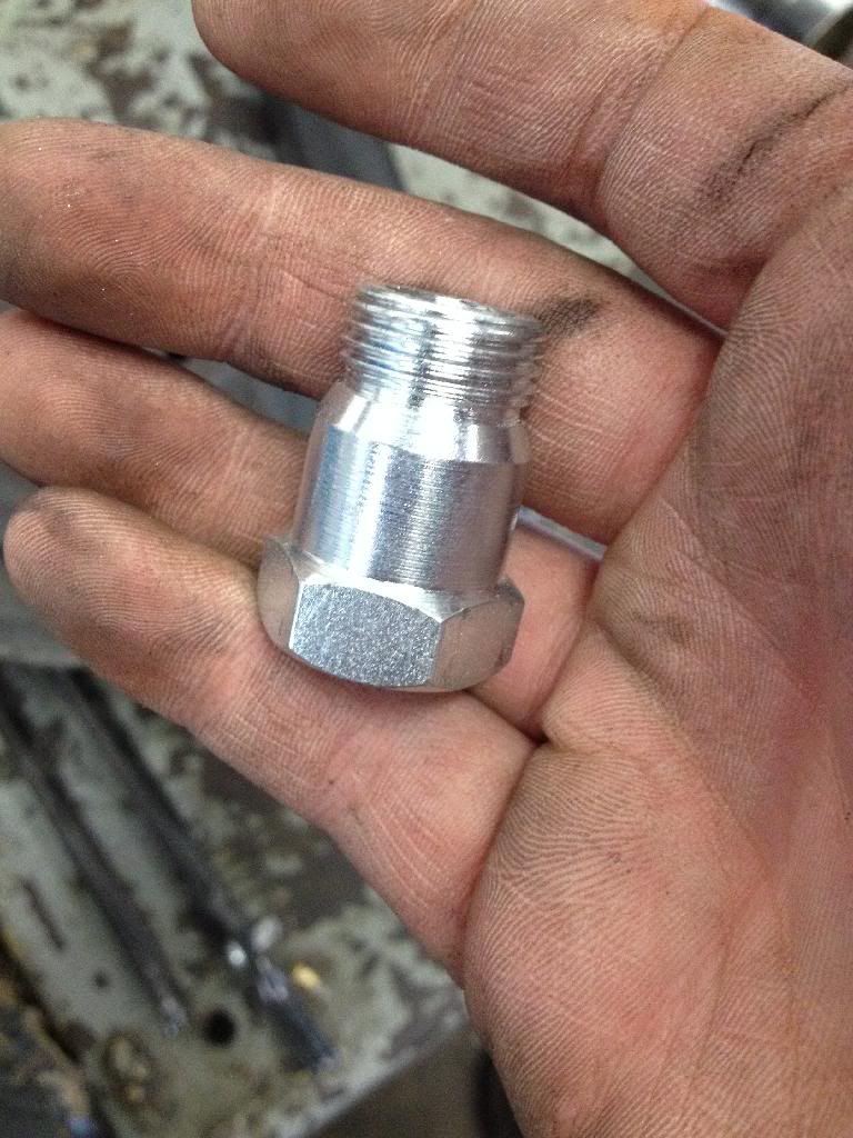

Going to try and use these little adaptors to prevent the O2 sensors from throwing ny codes. All they do is lift the sensor up out of the exhaust.

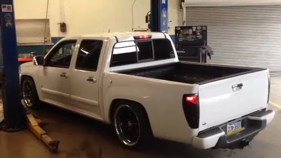

Little open header video
