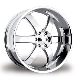

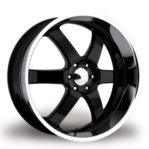

those would look hella kool wrapped in BFG ATs :D
757 Posts
nice those would like nice as hell on your ride if they fit get em!!!
98 Posts
they will not fit.... i wanted these rims originally when i bought my rims and they only make a +20 offset... my offset is +40 and my tires rubbed off about a half inch into my fender flares no big deal... now my rims fit perfectly
CALI BOSS
6,312 Posts
+20mm on a 20x8.5 should fit fine with a 255/35.20 tire size.
I have +10 mm on my 20x8.5 with 255/35.20 Goodyear F1 AS tires and they sit flush with the edge of the flares. They rubbed the inner edge of the flares at first but don't anymore.
10 Posts
So what is the consensus? not enough offset and the stick out? What is the lug spacing for colorados? is it 6x115mm?
CALI BOSS
6,312 Posts
The +20mm offset on an 8.5" wide whell will work on 355s with flares. w/o flares, they may stick out .25"
The blot circle is 5.5" or 139.7mm
