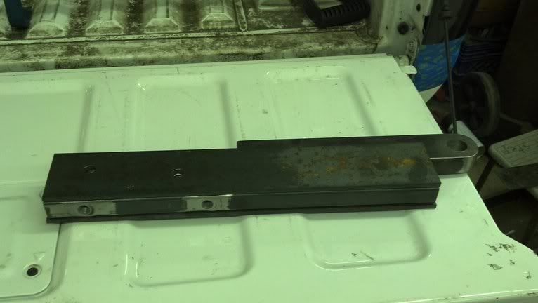

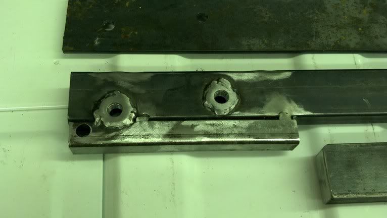

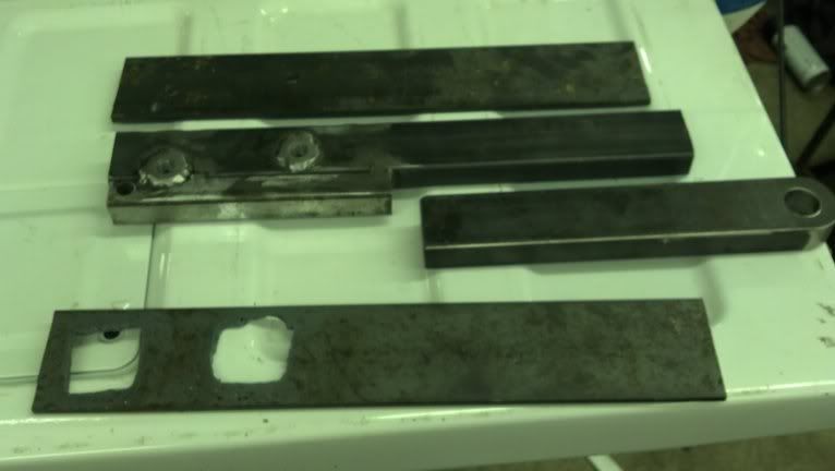

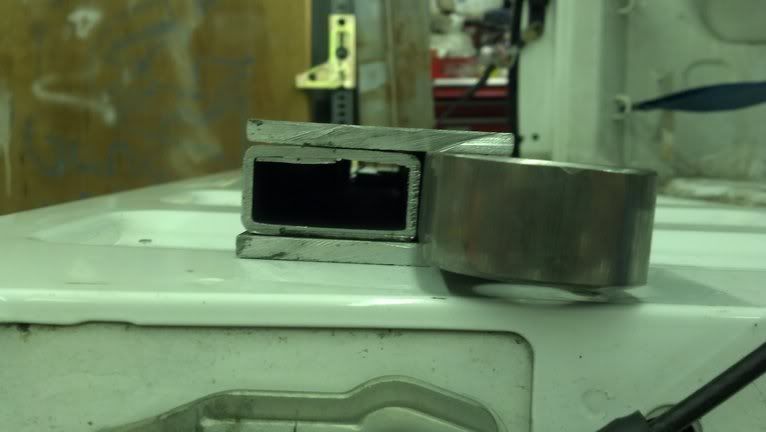

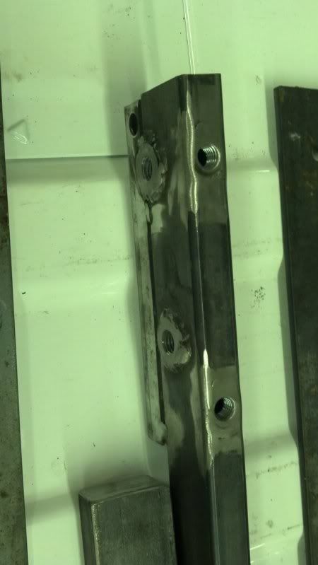

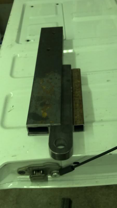

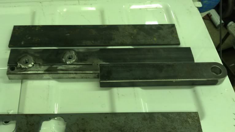

I started working on the rear bumper tonight all I did was figure out where to cut the bed sides and how I was going to make the mounts and I went and got some nuts to weld into the mount and made the passenger side mount and started the driver here are some pix of the mount un welded

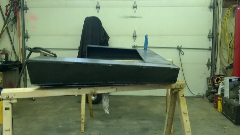

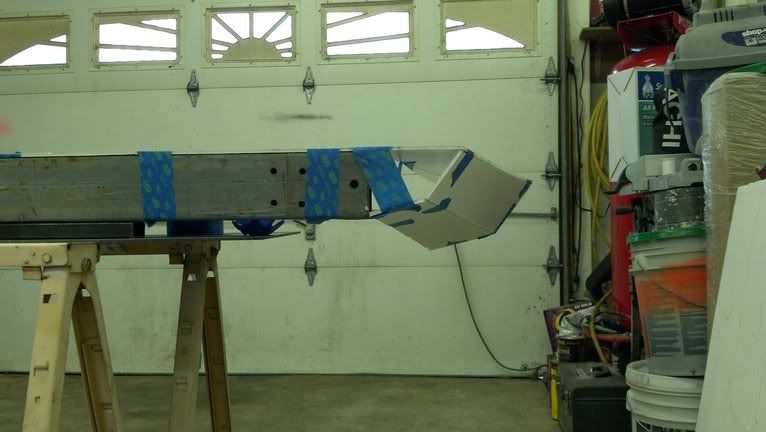

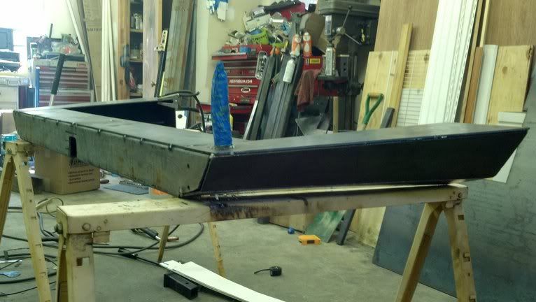

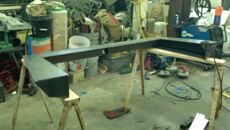

So I only got a few hours in on the bumper today and I have to work a double tomorrow so I'll try to get motivated during the week to finish it but here is a pic of what I got so far
Pix from earlier today, I have it all welded up and ready to paint just did not get pix of that yet

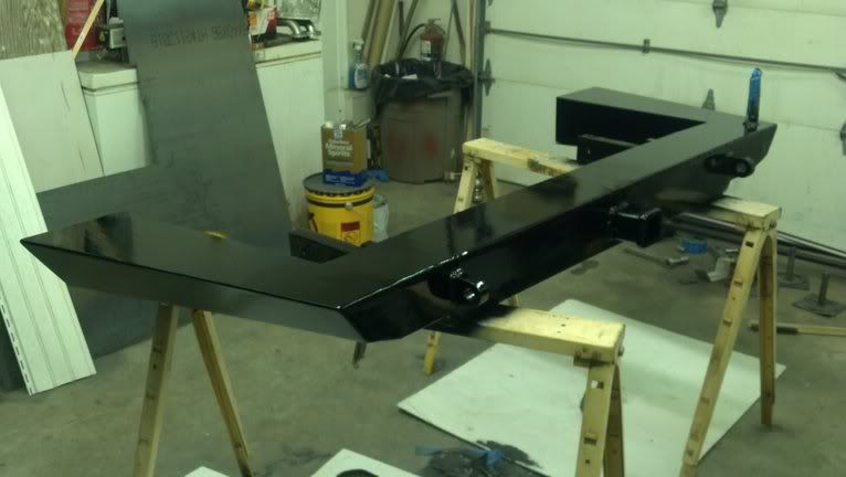

More pix with the chassis saver

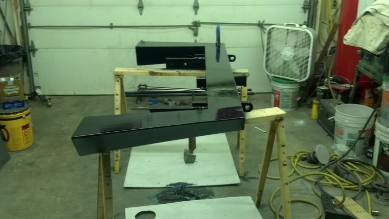

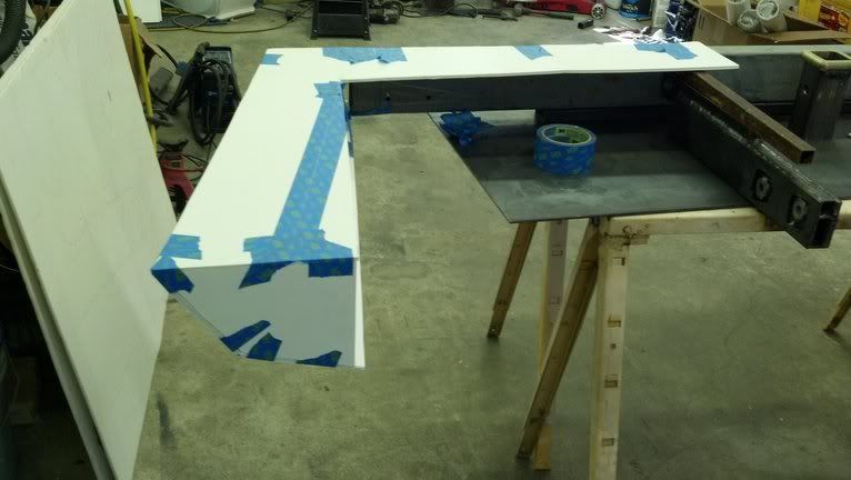

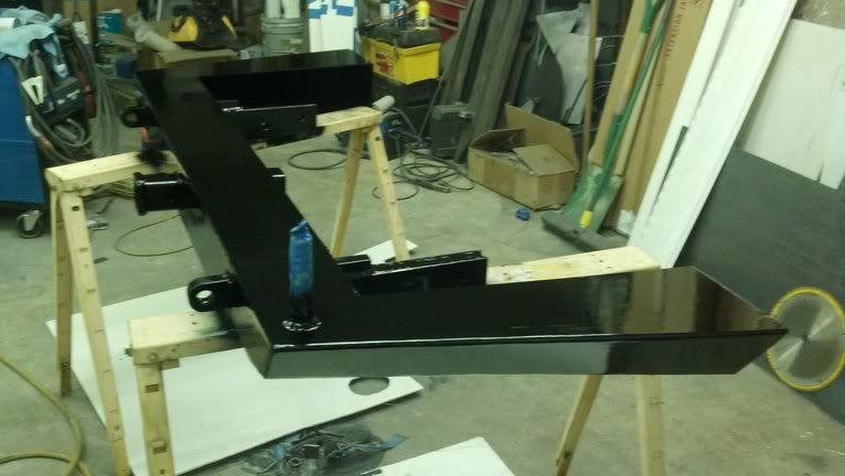

Not much but put a coat of black on it tonight and I'll run out and get more paint in the morning so I can try to put it on this week

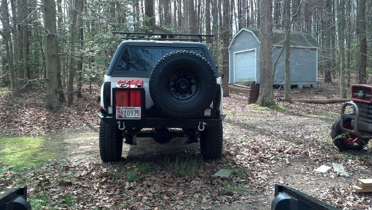

Ok here are some day time pix and I hacked the exhaust off right after the rear hangers for now but I'm still going to do something with it later and I put the tips on for s&g
Before exhaust chop
After chop
And for anyone interested getting rid of the stock bumper/hitch and adding this bumper gave me 9" more ground clearance at the lowest point on the bumper and that gave me 10* more departure angle
Before bumper hight 21" and 28* departure
After with new bumper is 30" and 38* departure

Yeah I cut the bedside offLooking good man did you cut a bit off the bottom of the bed in the rear?
For now it's just off the rest of the bumper but once I put longer leaf springs on I'll make a mount that supports the front more thanlooks real good.
is it going to attach back to the frame right behind the tire? or just mounting it to the bumper/hitch locations?
Before exhaust chop
After chop
