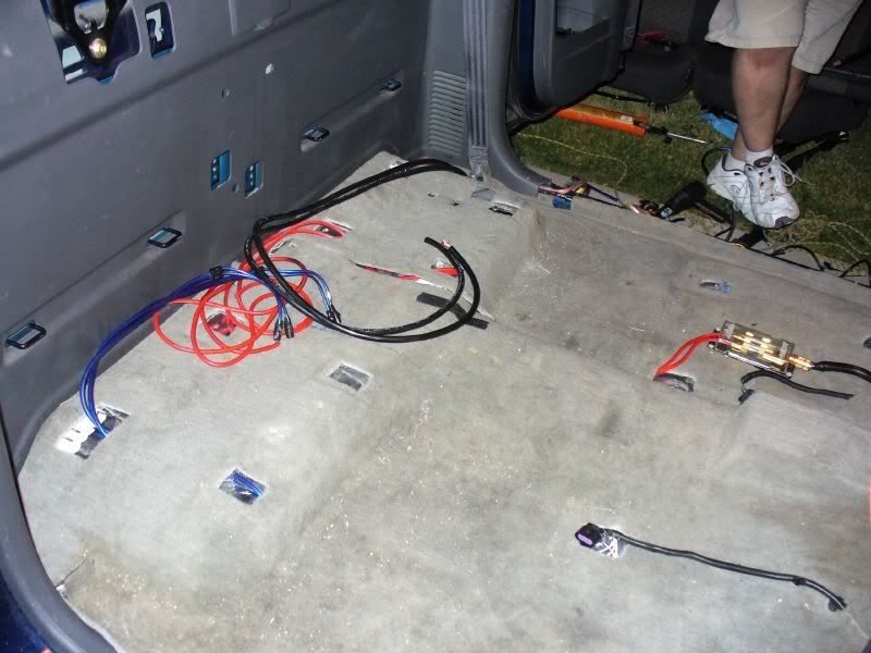

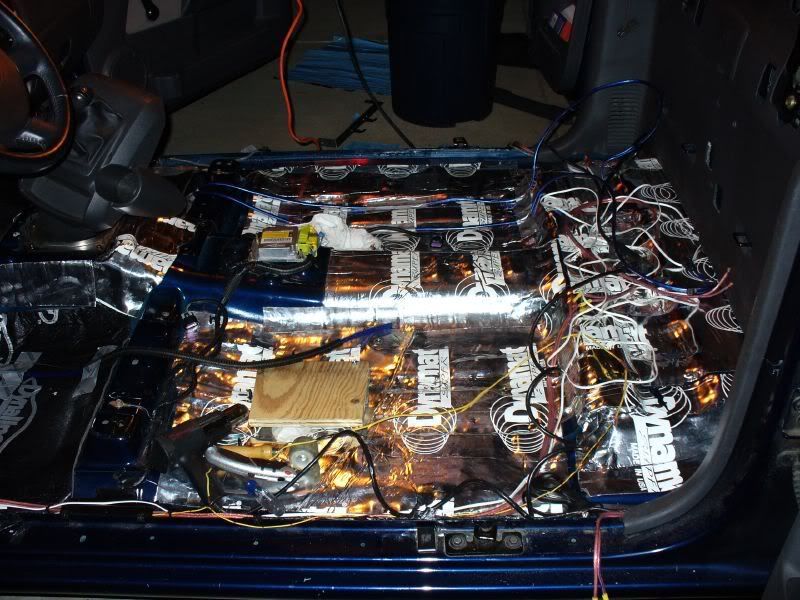

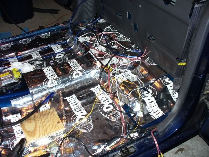

Well my buddy just had it laying around in his garage and said I could have it since he didn't need it. It took 2 boxes of 36 square feet dynamat super.

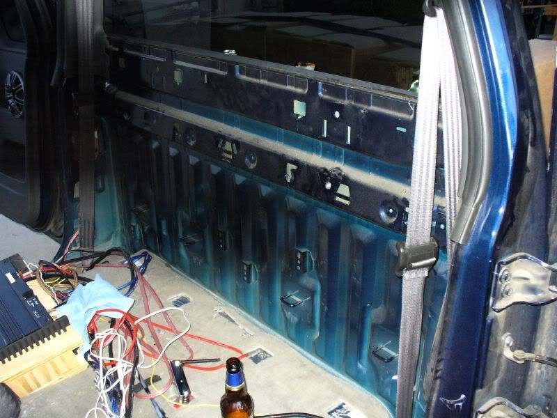

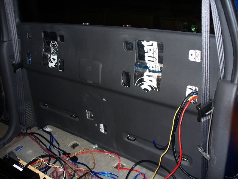

Real easy to pull the interior...just take the seats out and pull up on the carpet. The roof takes a while to get off because you need to take all the clips out and the oh shit handles, etc but its still not a big deal...you could do the whole thing in one day if you wanted to.. I just took my time doing mine since it was the first time I did it.

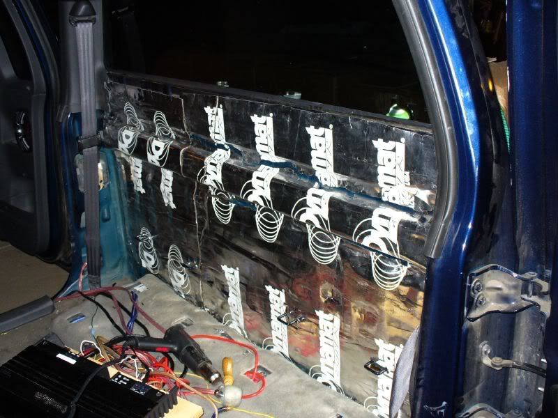

Will let you know next weekend...going to start building my new box for 4 Pioneer Premier 10" 2500 max watt subs tonight :D and mounting the two amps for the subs on the back wall and the 4 channel on the side of the box and not sure about the Audio Control 6xs and the Audio Control Epicenter yet...probably on the side of the box as well ;)
I can definately tell a difference with exhaust noise though...it was way louder before and the wind noise on the freeway is greatly improved...well worth it even if you don't do it for audio do it for the sound reduction.

Yeah it really cut down on the "squeaks" I had coming from the back of the cab while driving without music. I haven't heard anything rattle or squeak since I did this :D
