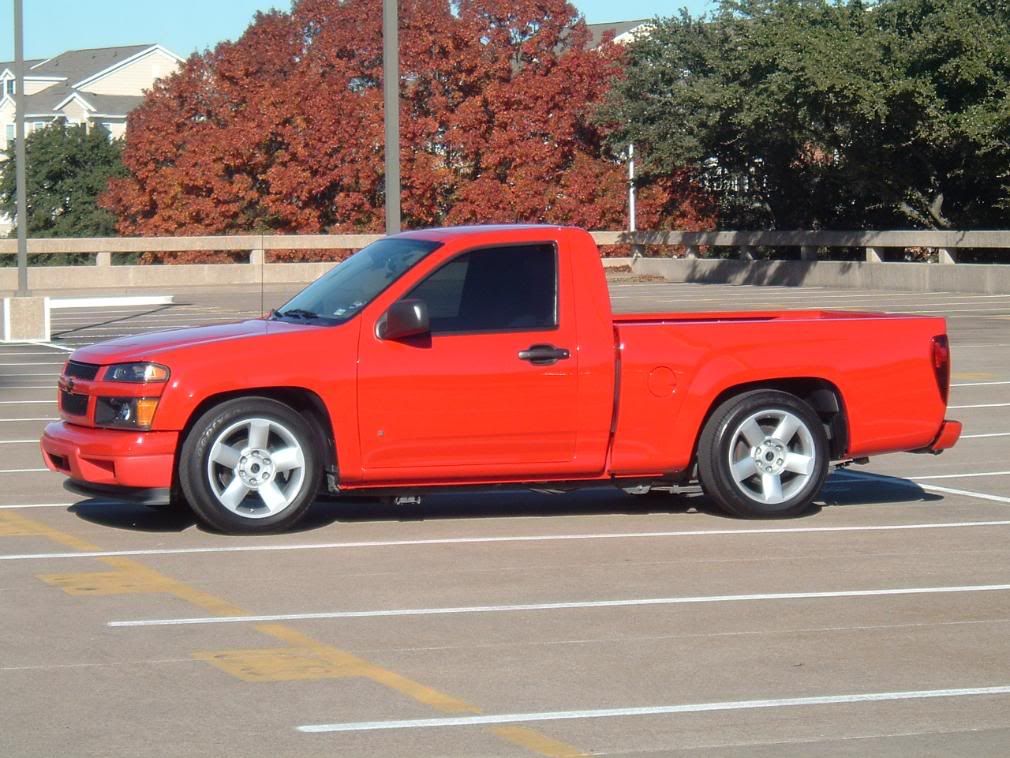

Well, I finally got my truck lower. I went from a 2/3 to a 3/4 with the DJM control arms and 4" blocks. Install wasn't bad except that my friend and I ended up aligning it ourselves and that took a while. All in all pretty easy and smooth sailing. The ride isn't much different, although I hit a HUGE dip on the highway this mornng and scrubbed my front fenders pretty hard and hit my bump stops in the back pretty good too. I may need to cut them down if it happens frequenly. I think it looks TONS better and the thing I am most happy about is that I can go lower pretty easily in the future now! :D
Well, on to the pictures.

The round ones in the back? (thanks) :D
Yeah, I'm talking about the rears. Were those the ones you were hitting? Or were you talking about the fronts?
I have balljoints, so I'm not used to hitting the bumpstops in the front. lol.
You have two bumpstops back there.
The large ones and the small pads on the frame. Remove the large ones and keep the ones on the frame.
I didn't hit the bumpstops in the front...just the fender liners. The back slapped pretty hard... :kiki: I will take those off tonight if I get the time.
Next is a crossmember. Maybe I will get one for Christmas! :noes:
