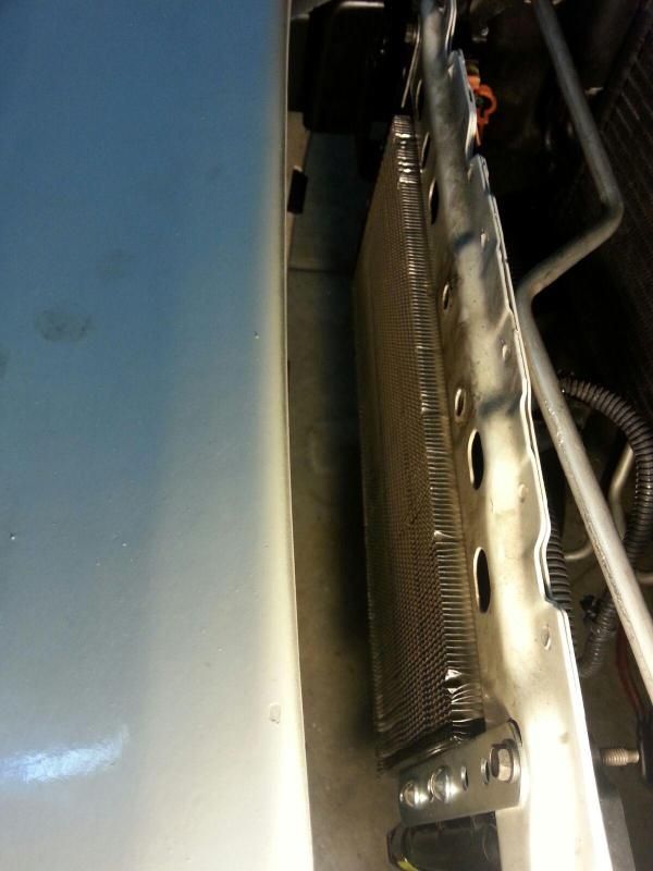

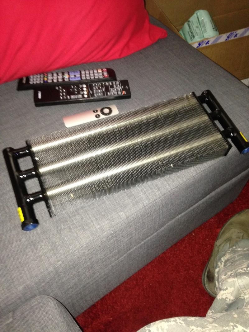

I used a Hayden oil cooler since I didn't run it in series with the stock radiator trans cooler. The Hayden oil cooler is a lot bigger. If you're not going to run a trans cooler in series they recommend a cooler twice as big. I tried to run a smaller b&m cooler in series but the line kept blowing of the stock connection, so I decided to do a bigger cooler with Russell braided ded lines and AN fittings.

I've been using a B&M stack plate cooler for a few years now. I have it in series with my OEM trans cooler and a Auto Meter trans temps gauge.
My trans temps stay between 125-165 depending on the time of year
