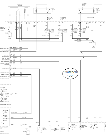

Bringing this back from the dead... I was thinking about getting the power of the third brake light and switching the buttons in the switch in the OEM switch to make it work...
Any thoughts? I really want an OEM switch but don't want to pay the Stealership $100 to reprogram my BCM for some fog lights.
Thanks guys.
I think that I'm actually gonna do this to get the results I want.
Let me know what you guys think.
