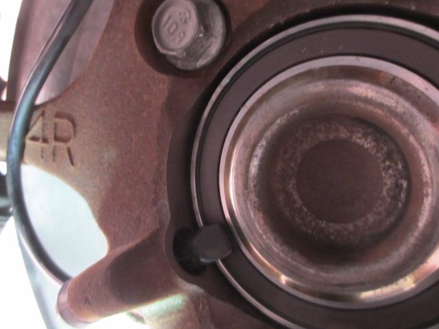

If you have a 2010, the antiskid sensors are not even close in configuration to a 2006. On the 2010, the sensor is mounted in a hole in the knuckle and is not attached to the hub assembly. It does not need to be disturbed when removing the hub assembly.

ok there is no play in the bearings i thought the growling was coming from the bearings but i don't think so any more, i pulled the brakes apart there is still a good 1/4 to 5/16 of an inch in the groove down the center of the pads and the rotors are looking real good so i figure i have at least another 10,000 on the pads while apart i greased the pins and the pads were pretty tight in the bracket that they sit in so i pulled the sheet metal clips off and knocked off the rust build up where the ends of the pads mount into everything is a little quieter when back together so it does not bother me as much now, buuuuut i have a new issue that should be started under wheels but as long as i am here, i have always ran snow tires on the back well this year i found another set of wheels for the front to run snows all the way around, yep they are 15" same as the extra rims i have for the back, hmmmmp did not know that there is an issue with 15" rims going on the front well i already have the new snows mounted, from what i could see (i did read later that there are bigger rotors on the newer trucks hence the 16" wheels) the bracket that the caliper mounts to is the issue, the outer edge where the pins slide in and out, again not the side where the pins enter but the outer most edge is what is hitting the rim has anyone tried wheel spacers i think 1/2" might be enough or what about taking a little off the outer edge of the bracket that the caliper mounts to yeah that sounds extreme any ideas
