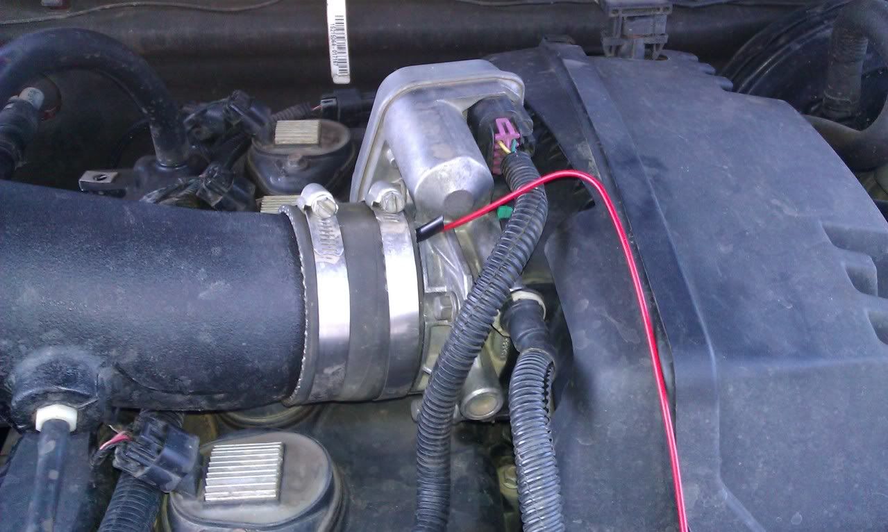

So for the spray, would you have to take the resonator box off, and spray directly into the throttle body? Where is the proper location to spray?

As following the directions on the can, this is how i did it, mind you. i have the full K&N intake system....
Also, per the can, you have to keep the RPMs up some. either have a hlper keep the rpm up, or do what i did and prop the gas pedel.

I've done the same as this photo. The straw goes right into the throttle body, so yes the resonator has to be removed (or at least pulled away to access the throat). The can also instructs how far to insert the straw. It is like 1/8 or1/16" from the throttle plate.
I propped a 2x4 against the gas pedal and held the RPM just around 2,000. The can also suggest an RPM range. I think you want it low enough that it's not burned off to quickly. If you just allow it to idle, it will stall (flood out). You can regulate the nozzle a little too to ensure you don't flood the engine with too much spray at once.
I try to kill the engine as quickly as possible too so it doesn't stay at high RPM for long before I can get to the key. Find yourself a good spot to lay the can while the engine is running so it doesn't fall.
