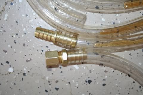

Step 2 - Take your short piece of 3/8" tubing, insert the barbed fitting and cap the end. (Bottom)
Step 3 - Take your long piece of 3/8" tubing and insert the double barbed end fitting at one end. (Top)

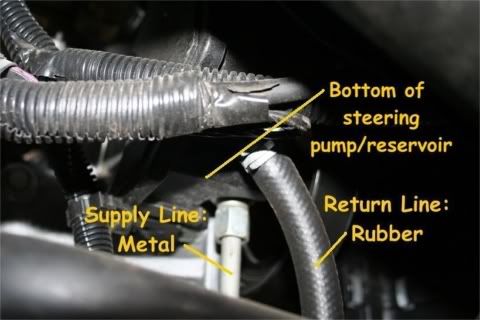

Step 4 - Locate the metal supply and rubber return lines on the steering pump reservoir.

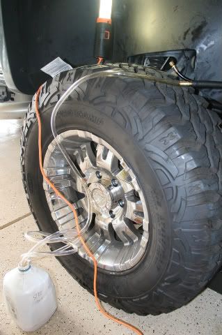

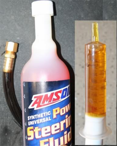

Step 5 - With a drain pan under the truck, disconnect the rubber return line and quickly slide the short piece of 3/8" tubing capped on the end over the return connection on the bottom of the pump/reservoir. This section of tubing will fill up with the old steering fluid in the reservoir. If you have had your truck 2 or more years and have never changed your power steering fluid then it will probably look dirty but that is why you are flushing it. Picture below is with the tubing sticking out under the fender wheel well. The fluid color in the bottle was not accurately shown in the picture so I photoshopped the fluid in a syringe for a better representation. Only 2 years on the steering fluid in the truck and as you can see it was almost black.

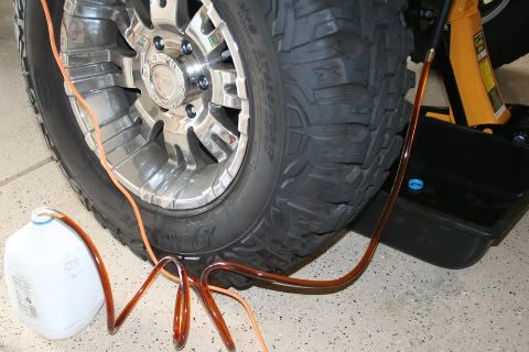

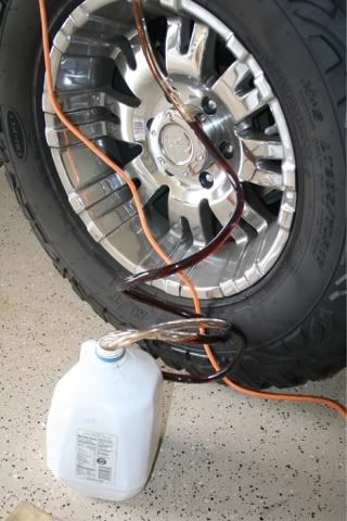

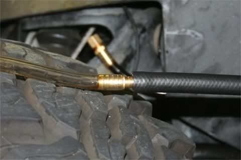

Step 6 - Quickly slide the long piece of 3/8" tubing with the double barbed fitting and slide it over the other end of the return hose tubing. Put the end of tubing with no fitting into a milk jug or other container to catch the old fluid.

Step 8 - Turn the steering wheel a few cycles back and forth to pump the old fluid out of the system. It does not take many turns. Continue to do this till the fluid starts to spit and sputter.
Step 9 – Add new fluid to the reservoir and turn the steering wheel a few cycles back and forth to pump the new fluid thru the system. Continue to do this till you see new fluid starts to come out of the tubing. The fluid will continue to lighten up as you flush the old fluid out. Do this till you are satisfied that old fluid is flushed out enough.
