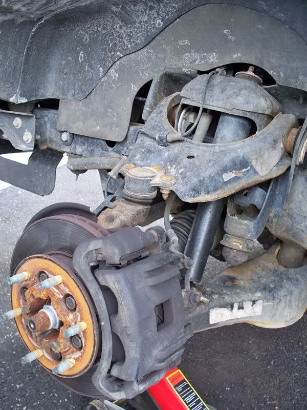

Step 1: Remove your front tire

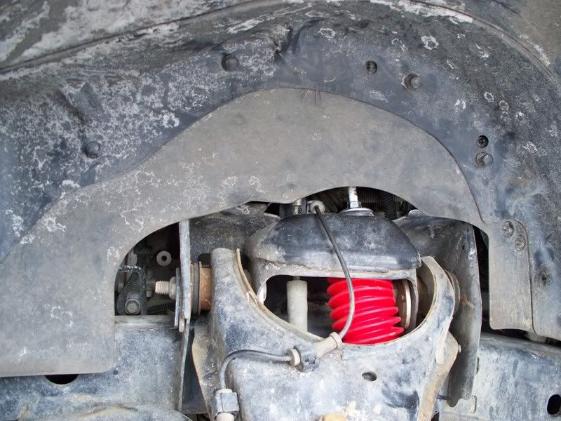

Step 2: Remove the 4 plastic clips holding in the engine bay covers in the wheel wells with the flat head screw driver and remove the cover.
Once removed you will have better access to the upper shock bolt.
Step 3: With the 16mm wrench or socket, remove the nut from the shock stem.
*NOTE* I had to use WD40 to loosen the nut from the threads due to rust build up.
*If the nut and shock stem both start to rotate when trying to loosen, grip the top half of the threads with the vice grips and continue to loosen nut. Once you get to the vice grips with the nut, grip under the nut with needle nose pliers. Release the vice grips and continue loosening the nut until it comes off.*
Step 4: Remove washer and bushing from the upper mount.

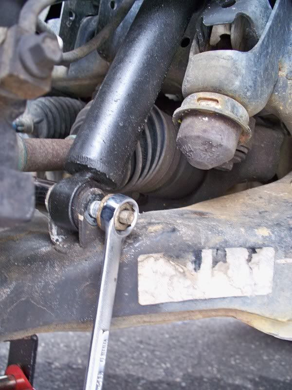

Step 5: With the socket wrench, extension and 18mm socket, place on the "bolt side" of the lower shock mount. Take your 18mm wrench and place it on the "nut side of the bolt" and loosen nut until removed.
Step 6: Push the bolt out of the lower shock mount, use the screw driver that you might have handy and push the bolt the rest of the way out of the shock and mount. The shock will then fall out of place, if not a slight tug on the shock will remove it.
*The shock is not under pressure like a spring or coil, so do not worry about it shooting out at you*

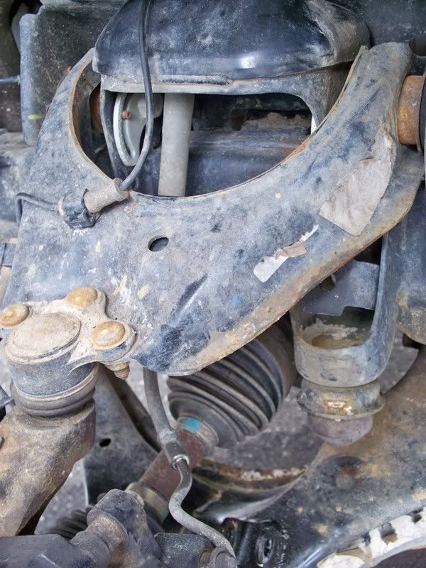

This is what you are left with after these first steps

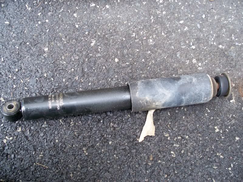

Step 7: Pull out your new shock and parts that are given with it. Take notice the difference between the new and old shock.

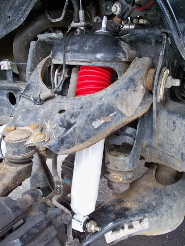

Step 11: With the nut and bolt taken out of the lower mount, place them back into the mount with the new shock and tighten down with your 18mm socket and wrench. Again, no specifications were given for how tight the nut and bolt had to be.
You should now be at this point with your install:
Before the next step, make sure all nuts and bolts are tight.
Step 12: You can now put the engine bay cover back on and secure with the 4 plastic clips that you took out originally.
