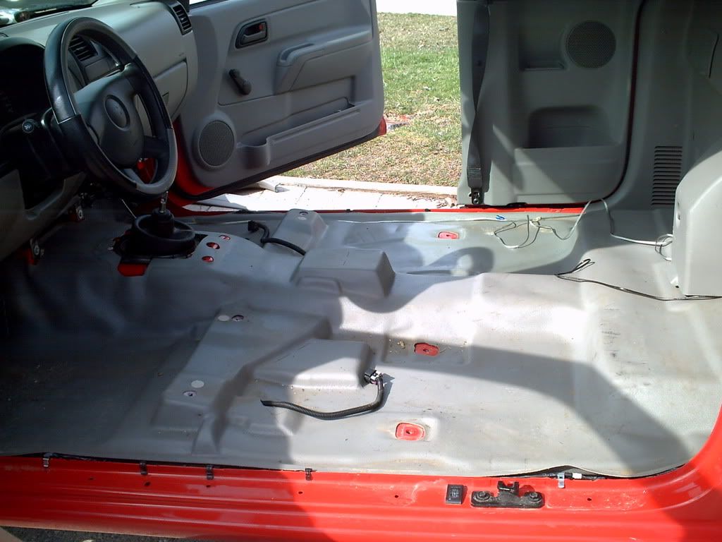

The first step is to remove the seats, kick panels, sill covers and rear panels. I do not have a pic of the seat removal, but if you can't figure out how to remove the four bolts on each and unplug the electrical connectors, you probably shouldn't be undertaking this project.:)
Here is your starting point:

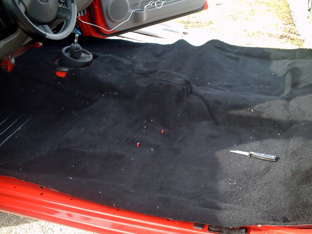

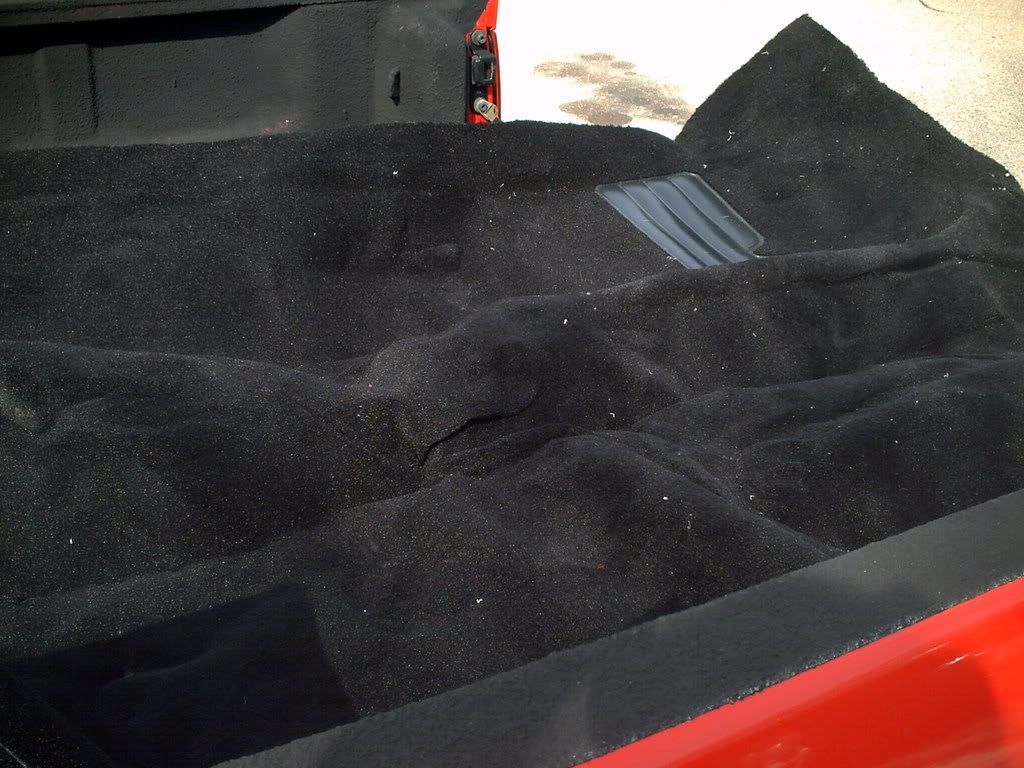

While I was removing all of that stuff, I laid out the new carpet in the bed in the sun, so it would warm up a bit and it would be easier to work some of the wrinkles out. This is a pre-molded carpet, but it still needed a little adjustment:

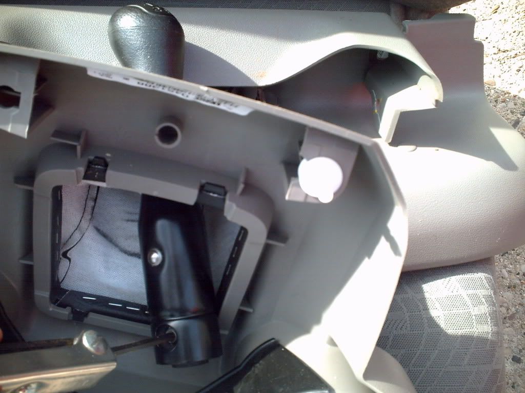

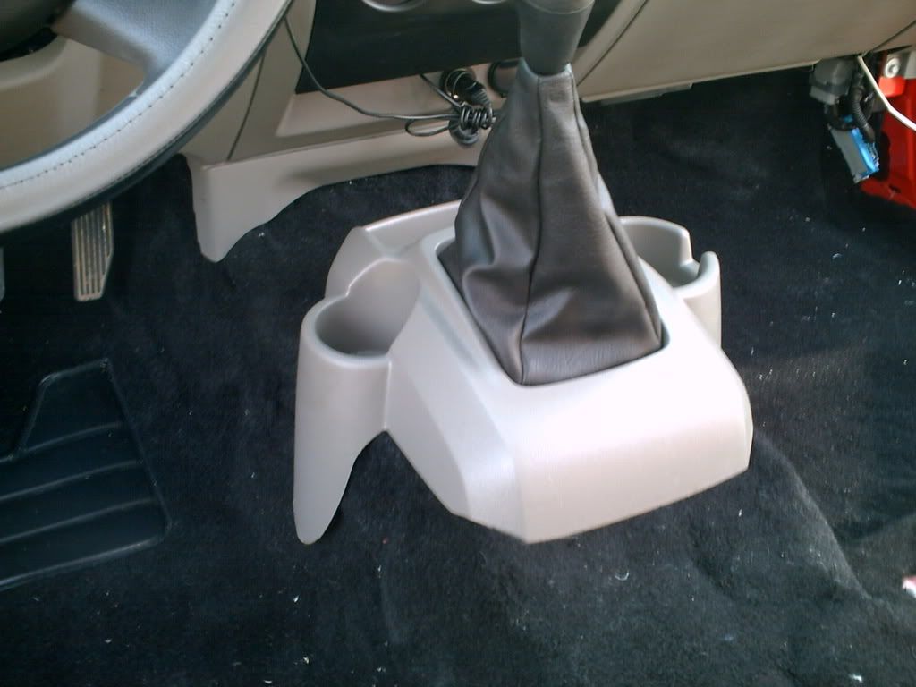

The next step is to remove the shifter assembly:

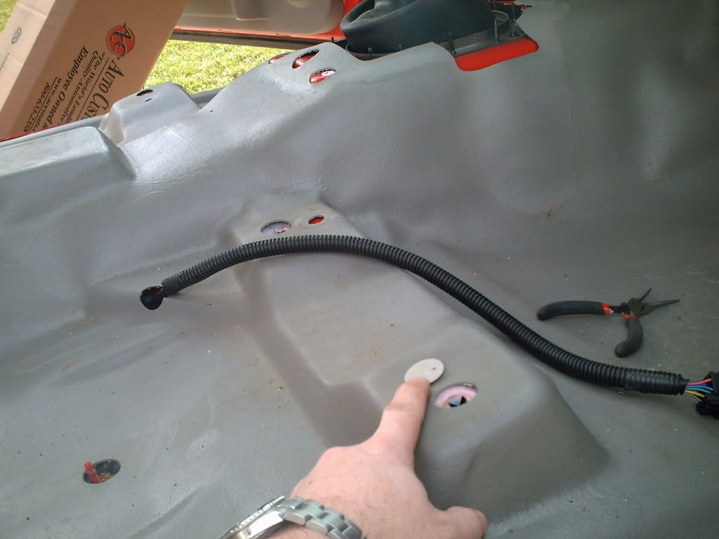

Now, the most annoying part of removing the old vinyl (or carpet): These little plugs are a pain. I pried them up a little with a flat head and the used a small pair of pliers to twist and pull them out the rest of the way:

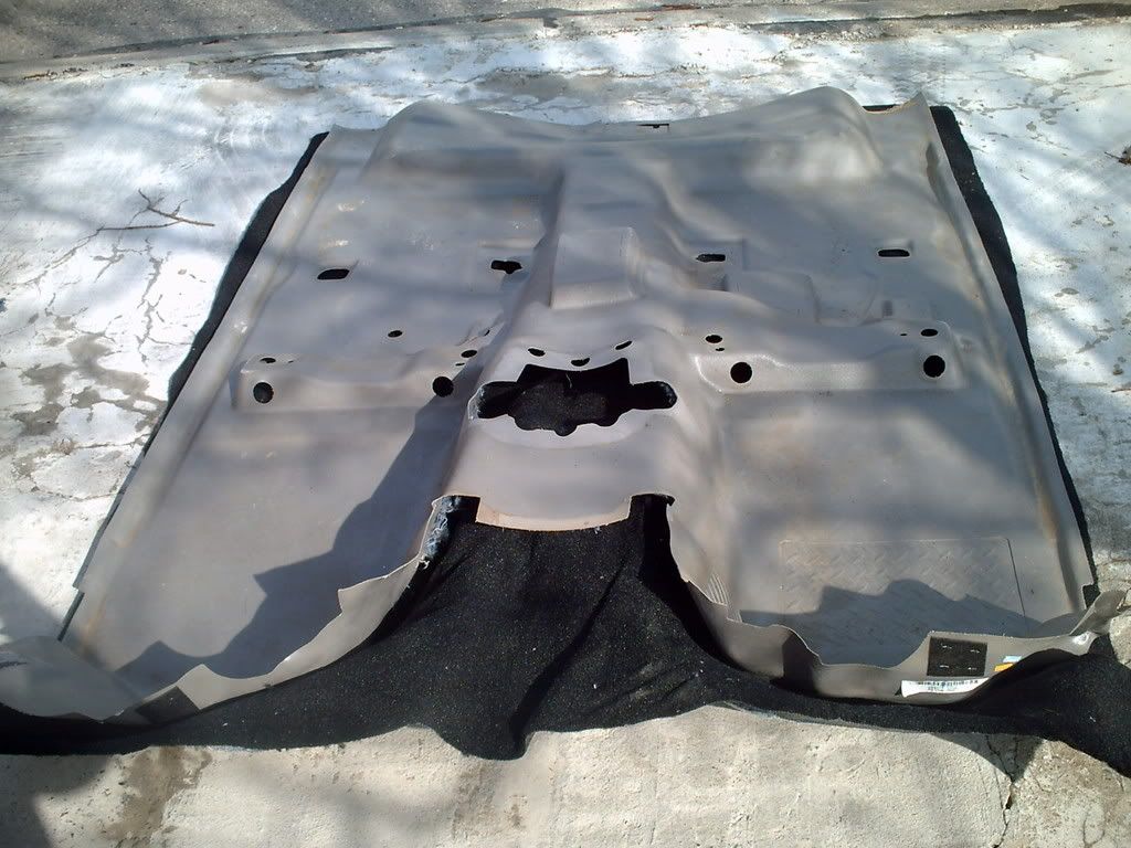

Next, I laid out the new carpet and put the old on top to mark the areas that would need some trimming. I used a very sharp steak knife to do the trimming. (I know it sounds like an improper tool, but trust me, it is invaluable in tight areas and because of its serrated edge.)
Now, lay the carpet into the cab and mold it into all of the little dips and bends. DO NOT RUSH this part. Take the time to smooth everything out so you won't have wrinkles or loose areas.

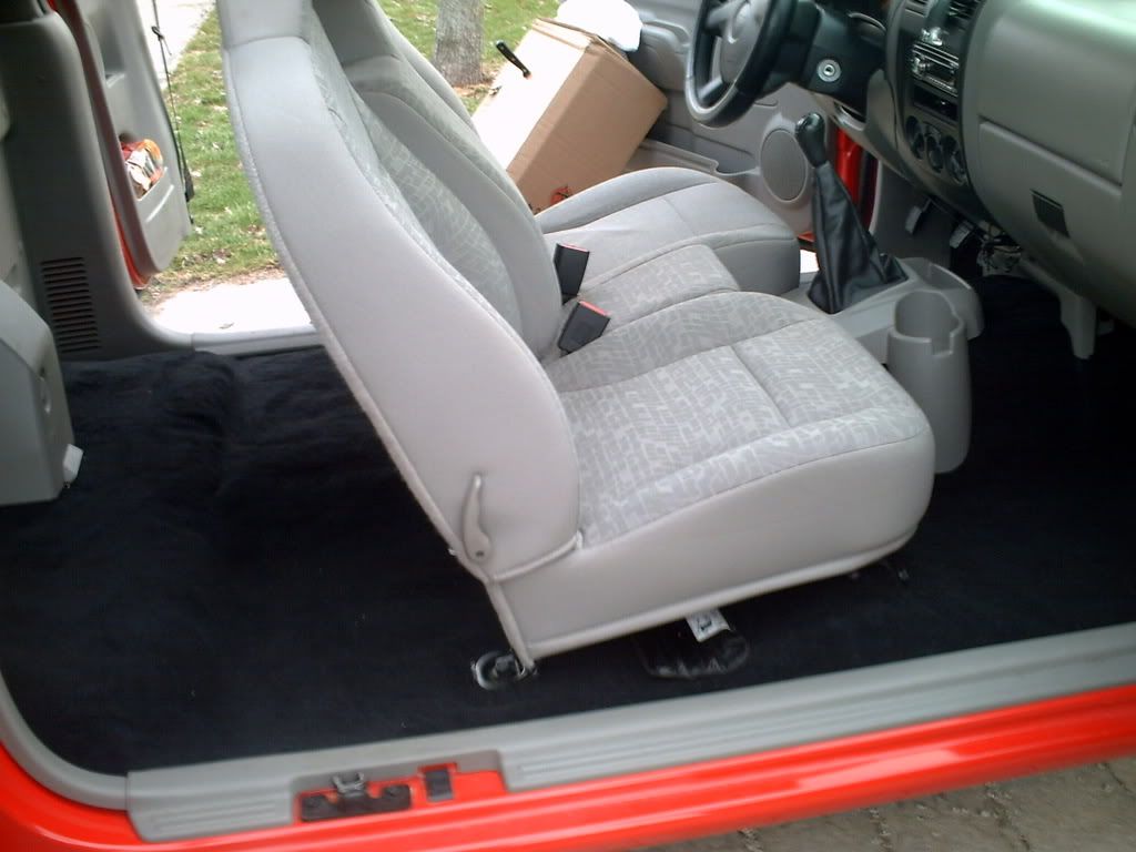

Next, I installed the seats. Notice that I have left a lot of carpet hanging out of the sides of the cab. I did this on purpose. You will trim the edges last.

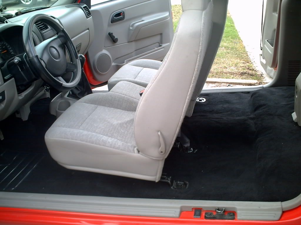

Now, with both seats installed (or all seat in crewcabs) carefully trim the extra carpet on the edges and install all of your trim pieces.
The final result:
And:
Looks a hell of a lot better than before!
