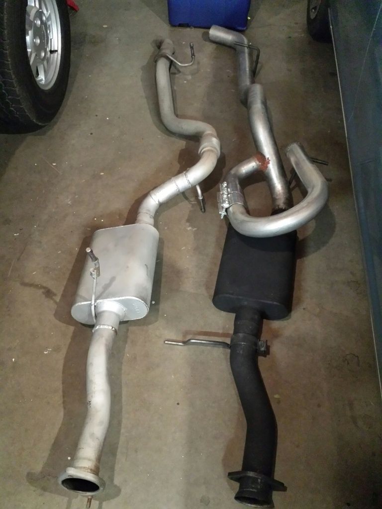

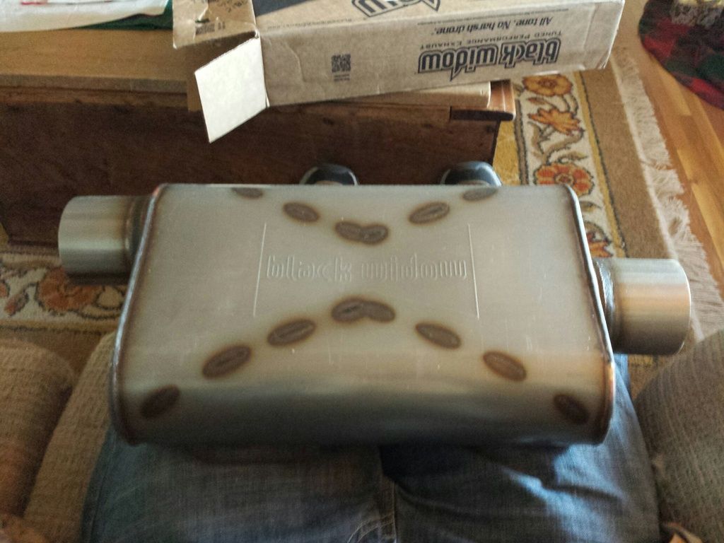

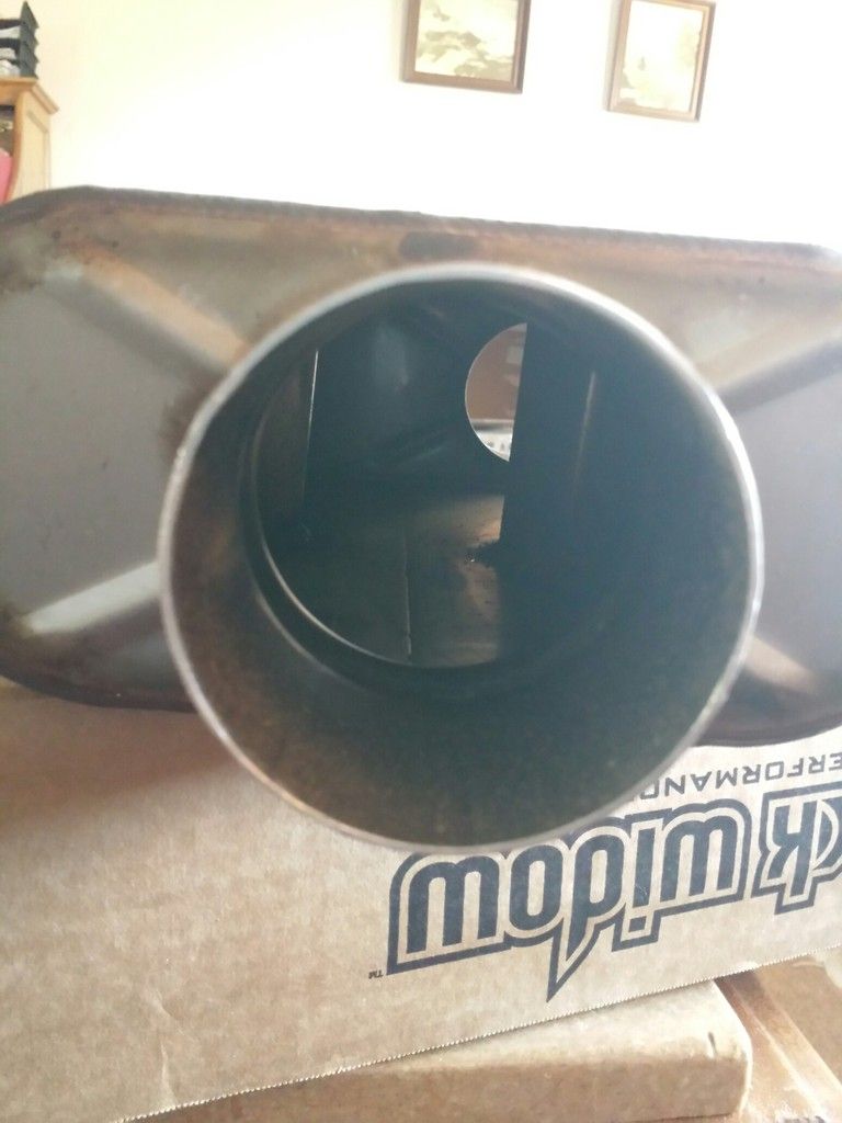

Little something just to update. I ordered a new muffler that's better suited for boost, but I decided to try it out with the 3'' catback.
It's a BlackWidow Venom 250 3''. I think it will do much better than the flowmaster super 44. Plus this is 14ga SS. It sounds very good actually!

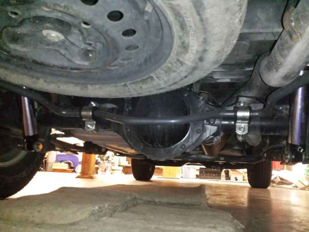

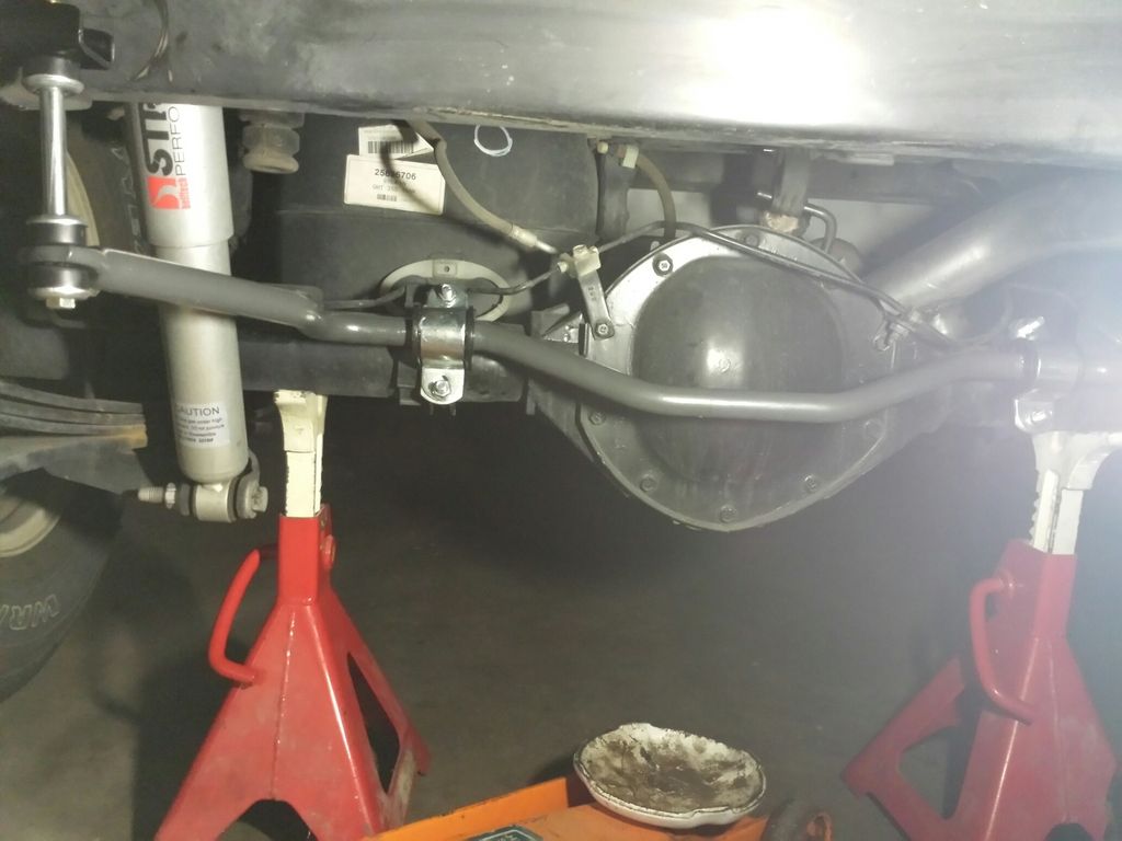

I do have plans in the future to freshen up everything. I'm slowly collecting bushings, tie rods, etc. Everything is actually in pretty good shape but I'm sure it could use some new parts.
I got a good deal on the belltech rear sway bar. It should show up Thursday. I got tired of trying to reduce body roll by using helper springs on the leaf packs. It helps cornering, but it sure does make the rear too stiff.
I also used some silicone spray for the body mounts. It did quiet down most of those squeaks!

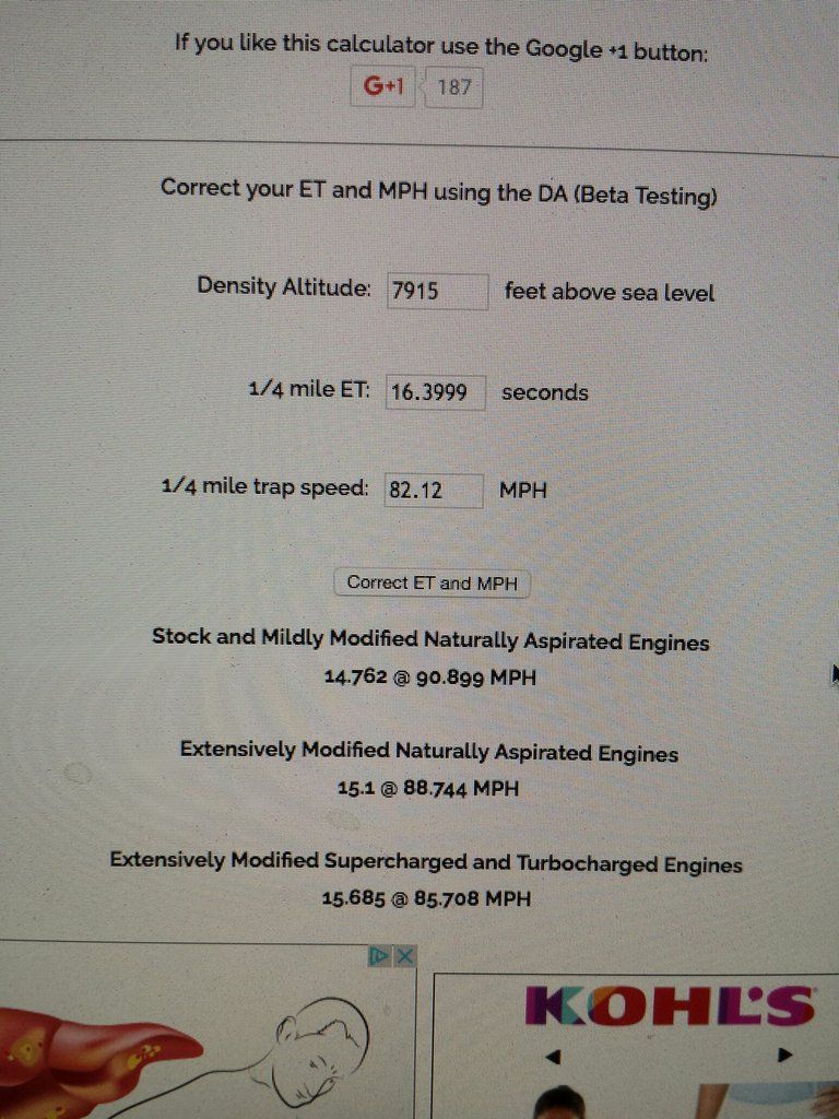

I went to the opening day at the drag strip. I extended my slapper bars so the rubber bumper hits the spring eye and not the spring.
I got my best time yet: 16.3999. My previous best was a 16.6958. Converting to ideal conditions at sea level and comparing to my previous best corrected time, I went from a 14.904 to a 14.762.
I think a little better launching technique and the slapper bars working correctly helped me get my best 60 foot time as well: 2.3200.

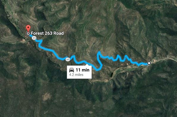

I had a chance to really test out the sway bars and rear QA1's. I went to a work weekend at a church camp I grew up going to and there is a nice stretch of twisty mountain road.
It performed awesome!
I had set the Qa1's on 4 (maybe 5? I forget). I had planned to set them higher for the "testing" but I forgot. It was flat a smooth. I could have pushed the truck much more but there are a lot of blind corners, but for the ones I could see if there was a vehicle, the truck just wouldn't let go of the road! No tire squeal or anything! I'm actually pretty impressed with the goodyear wrangler armortracs.
