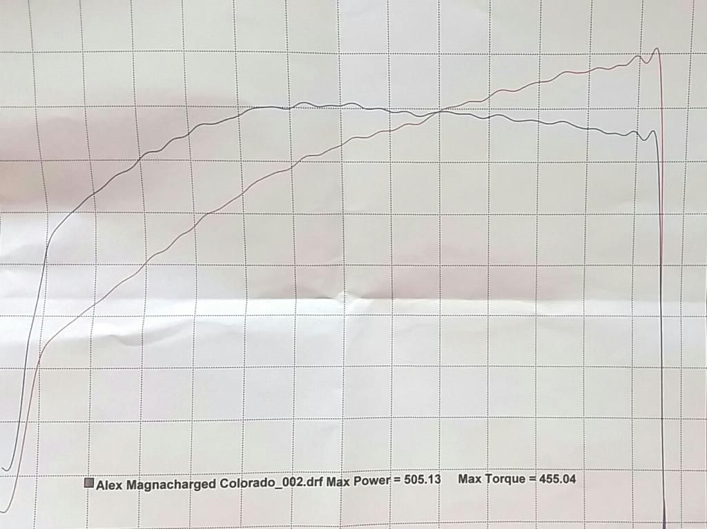

So I got my truck retuned yesterday for my new cam, I ended up making 505rwhp 455rwtq @8psi with my fuel injectors maxed out, that's about 89rwhp gain with the cam swap!!!!! I need to upgrade the injectors and either swap out the fuel pump or install a boost a pump. I know just upgrading the fuel system will get a higher number, but for now that's how she's doing so far by the way this is all with a stock 4l60e lol only upgrades are billet super servos, 300 circle d stall, tranny cooler.
Here's a pic of the dyno graph sheet

Wow great gains! How's traction now? Do you have a high stall torque converter?
I haven't really got "on it" since I'm still in the process of upgrading the fuel system, I'm getting either 60lb or 80lb injectors and fuel pump wise I might end up doing a return style system,, as far as traction I dirint have any before the cam swap lol,,, I installed a 3000k circle d converter also

Damn,that's like 600 at the crank,that is really good on that amount of boost! Zl1's,CTSV's with the [email protected] Are only doing in the 560 range.Nice going.
My buddies new '14 ZL1 put down 490rwhp just after the required 1500 mile break in period

I'm in the same boat as you, I'm researching injectors and a fuel pump but having a hell of a time figuring out what will be compatible. Let me know what you find out, that would help me out a lot. I might go with a LS3 fuel rails sense those injectors are easier to source. What are you going to do about the fuel pump? Also are you going to add a fuel pressure regulator?

I already bought a walbro 450lph fuel pump and will be adding a boost reference regulator,, I will be doing a complete return style conversion, and deleting the FPCM

I was able to make an Aeromotive 340 Part number 11142 work with the 60lb ls2 injectors. The Aeromotive pump is about 3/8 taller than the stock pump but everything else is pretty much identical. It plugs right in and goes into the stock bucket with a little modification, you just have to trim the top of the receptacle were the fuel nozzle plugs in on the buck and trim a tiny piece of the bottom of the key slot of the Aeromotive pump. The injectors fit nice too, they're just a little taller so you have to had washers to the fuel rails. I got it tuned and I'm making over 500 hp to the wheels, and the fuel system is only at 70% of it's capacity. I think I could've squeezed like 535hp out of it but I didn't want to compromise the reliability, plus I still need to pin the harmonic-balancer and upgrade my rockers. I wish I would of taken more pics of this process. This I think is the easiest and least complicated way to do it. I have about 4 hrs driving time on this fuel set up no problems so far.
