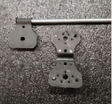

The monitor is supposed to mount on the dash or on the windshield and has a cigarette lighter adapter. But I did not want it there, as it felt like it was too far away to see clearly, nor did I want any wires running down the dash. I noticed that there was a power connection to the rear view mirror, and decided to mount the monitor on the rear view mirror. I found these great plastic hinges that are supposed to clamp onto a rod, and I purchased a threaded rod of the correct diameter. Also since the hinges were plastic, they could be heated and bent to match the curve of the back of the mirror. I mounted the hinges with Scotch Extreme double sided mounting strips (supposed to hold up to 12 pounds), with a short screw just a little way into the plastic to add extra hold. The hinges are mounted far enough down on the mirror to allow access to the tab that flips the mirror to night mode (I did cut about 1/2" off the tab for clearance but it is still accessible).

Seems to be pretty steady, don't see any extra vibration. With it's folded up, the edge of the monitor is against the mirror mount, so that probably helps with the overall lack of vibration. I only drop it down just before backing up, and put it back up as soon as I'm done backing. In the down position, it stays in place because the plastic hinge clamped onto the threaded rod adds some drag.
