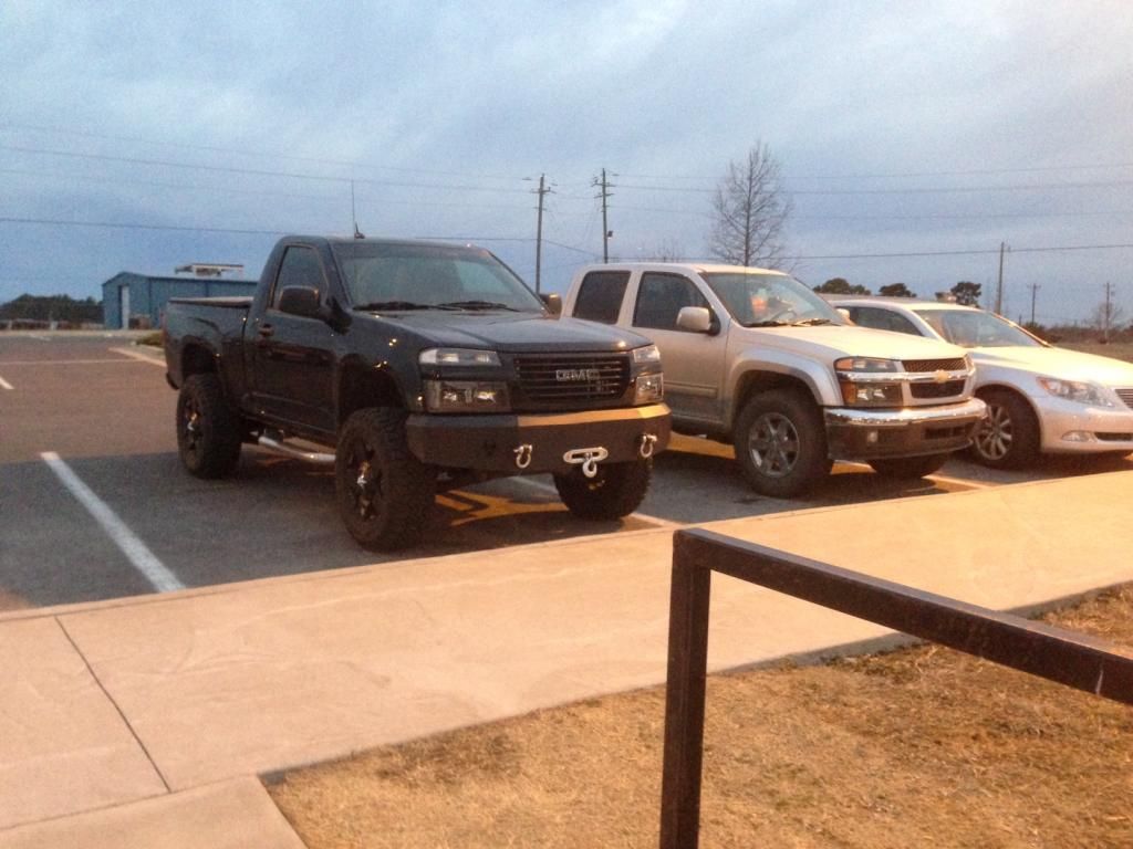

I am running the same size Duratrac tires, with a torsion bar crank up front and shackles in the back, I also done the 1 inch hockey puck body lift (dont think that matters for this) and I have a custom bumper, so I dont know if your air damn on the bottom of the bumper will need trimming, but I have plenty of room. here it is sitting next to a stock Z71
Ok thanks I'm hoping it will work I'm thinking it will but I put them on without the lift and there's no way i can run it without lift and I'm hoping that small of a lift will work what is your backspacing on your rims Excaliber and I love that front bumper. Did you scrub any with your stock bumper?
I never ran those tires with the stock front bumper, my wheels are 17x8 with 35cb backspacing, (5.88 inch)
Oh ok I thought that's what I seen in your pics hopefully it will work
