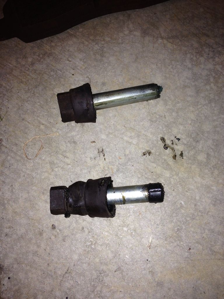

this is the third time this has happened to me since I replaced my front brake pads around 6 months ago. Driving around base and I start to hear clunking, and even grinding while coming to stops. I turn the wheel and look at the brake caliper to see both bolts missing and the caliper moving freely...
missing these bolts:
that bolt into the top and bottom of the caliper:
into these pins:
The rubber grommets are pretty torn up on mine, so I think grease is escaping the pins and allowing them to shake/loosen the bolts. Can anyone confirm/deny this, or provide any additional information to help me nip this problem in the bud? Thanks in advance

I really don't see how it could loosen the bolt enough for it to actually fall out though. I could understand it maybe working itself "un tight" but to the point it literally falls out??

I agree with the little bit of blue locktite on the threads. In additional make sure you are tightening these up properly. If you are having trouble judging the tightness by hand break out a torque wrench. They should be between 30 and 40 ft. Lbs.
Ps I know there is a very specific torque number but anywhere between 30 and 40 ft lbs is plenty. If any one has the specific torque please post it!

They are definitely just not getting tightened enough when doing the brake job. If you don't hold the pin with a wrench and then tighten the bolt you will never get enough torque to hold it. Those bolts are also 9.5mm threads and can't be bought at a normal hardware store you have to go to a specialty bolt place like the nutty company or fastenal or order them directly from the dealer, so make sure when you replace them if they get lost that you use the correct thread size or you will have worse problems. you also have to make sure the pins are greased and boot is seating properly, but that will just seize the pin not cause an issue with the bolt loosening.

Replace the pins and the clips and any other hardware. A hardware kit and the pins and bolts should be able to be had at any autoparts store. I you cannot find them let me know, I will get them at work and ship them to you. I work for Carquest.
2,770 Posts
From the Service Manual: Front Caliper Guide Pin Bolt Torque = 29ft/lbs (40 N.m). OEM (ACDelco) guide pins/bolts available from RockAuto @ 7 bucks per caliper.

I have never had any issue with that, i agree with jeremy. Blue loctite. and tq the hell out of them, I never used a tq wrench, just made it very tight. lol

Just bought some parts from NAPA. Here are part numbers for anyone else who has this issue, and stumbles across this thread.
Caliper Hardware Kit - NAPA Part #83527A. Contains rubber grommets and pad clips.
Caliper Bolt Set (one side) - NAPA Part #83621. NOTE: This also comes with bolts, but I had already installed them.

a 17mm wrench and 13mm socket til its nice in snug......to snug and you'll break them off!
