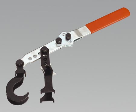

I have a spring compressor tool from when I rebuilt a 305ci small block. I wouldn't be surprised if it didn't work (or worked but gouged the cam lobes).

You might want to try using an OHC lever type valve spring compressor but the cam base circle may interfere with removing the lifter from its bore.
