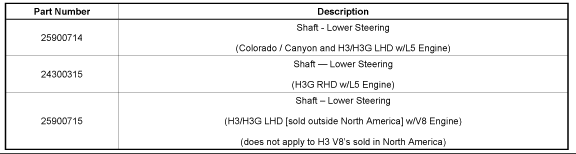

Bulletin No.: 07-02-35-006E
Date: December 02, 2008
Subject:
Clunk or Knock Noise Heard and/or Felt Through Steering Wheel or Brake and Accelerator Pedals (Replace Lower Steering [Intermediate] Shaft)
Models:
2007-2008 Chevrolet Colorado
2007-2008 GMC Canyon
2007-2008 HUMMER H3
Excludes H3 V8s Sold in North America
Includes H3G Vehicles Built PRIOR to Serial Number 422858 (LHD) / 425990 (RHD)
Condition
Some customers may comment on a clunk or knock noise being heard or felt through the steering wheel and/or brake and accelerator pedals. This issue may be more prevalent in hotter temperatures.
Cause
This condition may be caused by a slip/stick condition in the lower steering (intermediate) shaft.
Correction
Important: When replacing the lower intermediate shaft, follow service procedures found in published Service Information (SI). Be sure to ALWAYS:
^ Keep the hub straight when removing/attaching the lower I-shaft to the upper steering column.
^ Pin the steering column using the J 42640 - Steering Column Locking Pin in its straight position prior to removing the lower I-shaft. Keep the steering column pinned until after the new lower I-shaft is installed.
Failure to perform these steps could result in a mis-alignment of the upper steering column to the lower I-shaft and cause DTC C0710 and "Serv Stab System" message to occur.

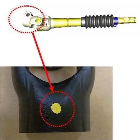

so is there a difference in this part over the stock one so it wont do it again? Has anyone tried and noticed a difference? Mine has been doing it for a while and I want to order the part tomorrow. Thanks.
1,141 Posts
1,141 Posts
Put my new steering shaft in last friday. Took me roughly 10 minutes lol. The stock one was toast at 39k miles. Hopefully this new one doesnt do the same thing... But as of now all is good!
