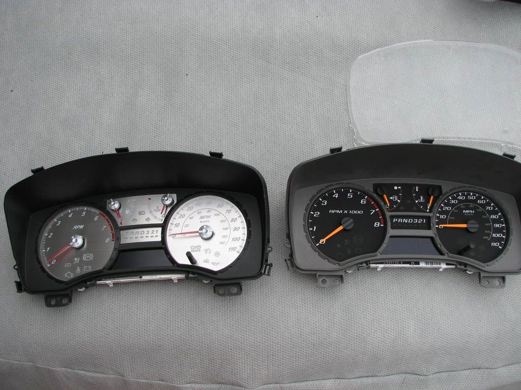

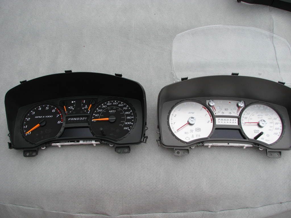

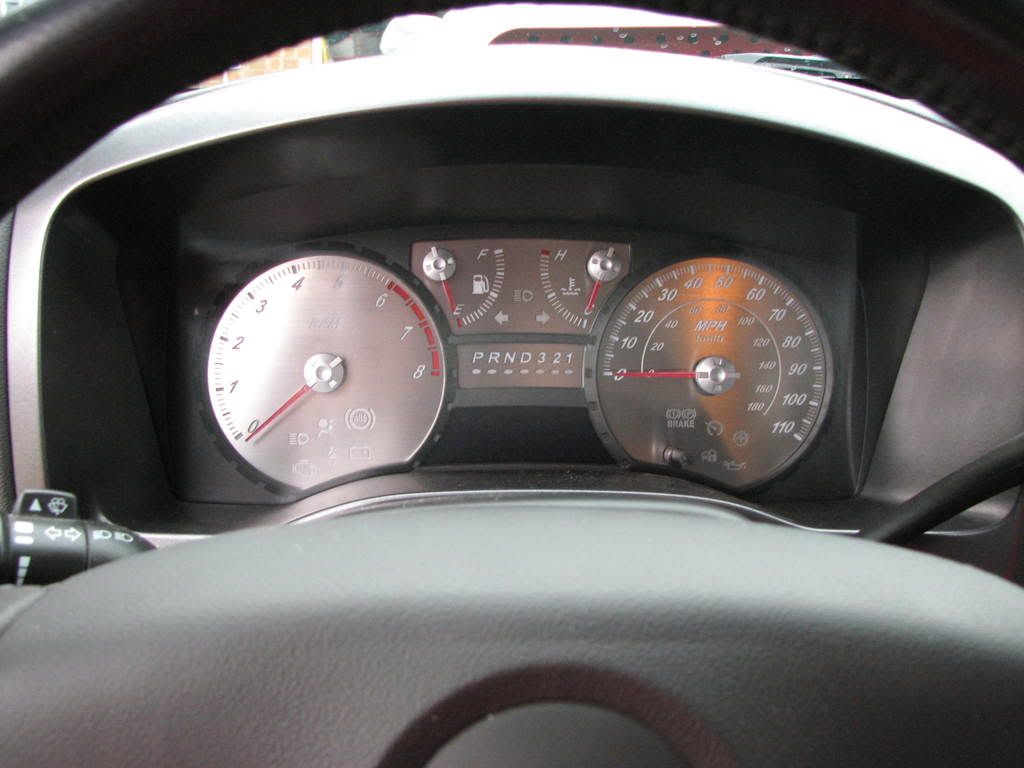

Well I bought a new gauge cluster so I could put it in while I do my LED setup
however I noticed the bezel that goes around the gauge face was darker than mine, so I decided to switch them to show the stainless gauges off better
Before
Side By Side Before
Side By Side After
After
What ya guys think?

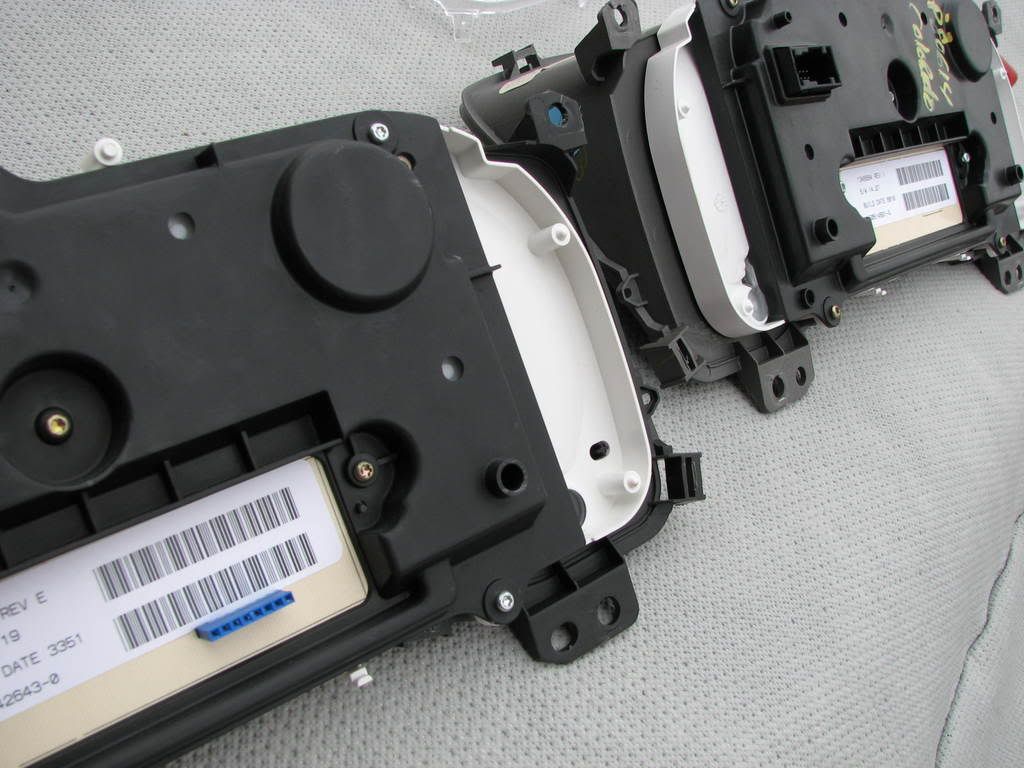

anyone know what the heck the blue thing is on the back side of my factory gauges?
HO IT
2,153 Posts
The black was definitely the way to go, looks good.
Your mileage will update after you drive around for a while. The miles are stored in more than one place.
