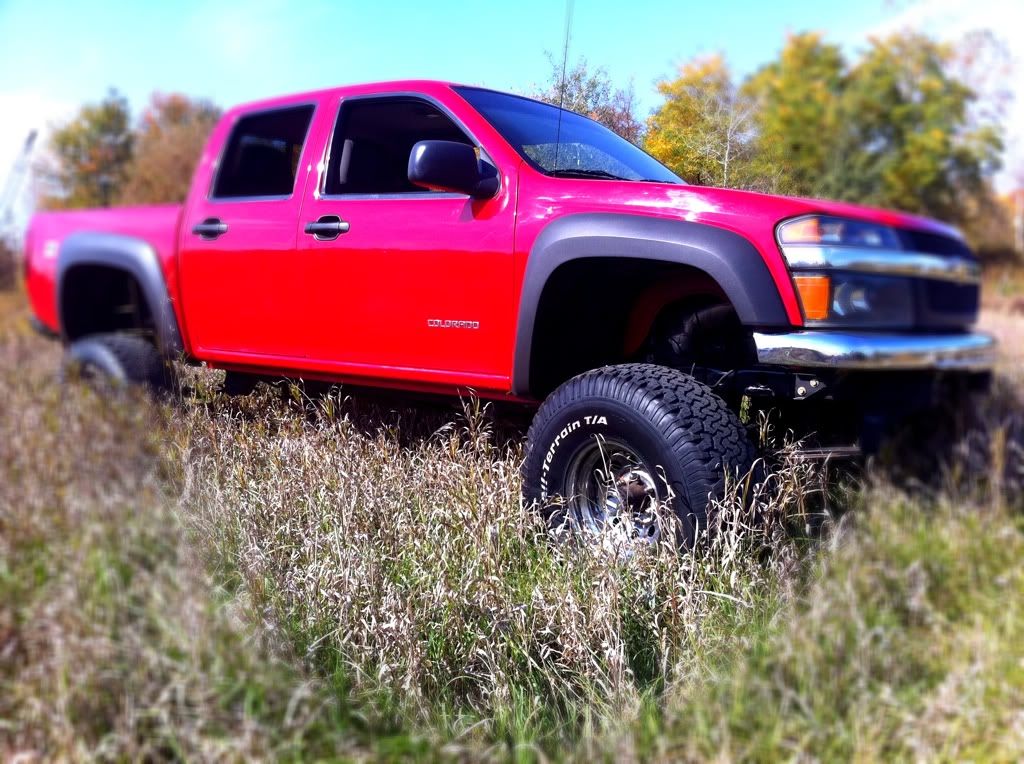

Thx racer!!!!!!!! As for more pics her ya go oldies but new ones with coils after MESM fo my show and tell lol I haven't even been driving around town with it lol I don't want pics to leak lmao

Careful lol I have 2 Shafts I also am runing 165 coils and have not posted pics yet until MESM and here is a pic with the 4x4 you can see it in this but its there lol I will post all my other pics after the meet lol and yes they r both long travel shafts
Looks good. I used to work at a local 4x4 shopas a fabricator and toyota mechanic. Built a bunch of link suspensions for toys and jeeps, not too many chevy SA/link conversions though...
You running hydro assist or anything? You running a toyota steering box?
No just the coils and air shocks I spent 2300 in parts and also a set of 185 just cus lol I'm liking the 165 as money comes I will upgrade as I go an yep the yota box I moved it about 3 inches forward to make room for the coils and I went with some thick ass tubing for the 3 link and panhar bar
