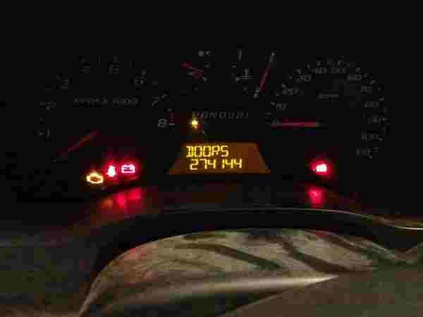

I bought an Old NAPA Parts Delivery truck with 274k on it for my LS Swap Project.
single cab, 2WD, base model, Z85 4 banger.
Here she is, looking all sketch in the dark...
