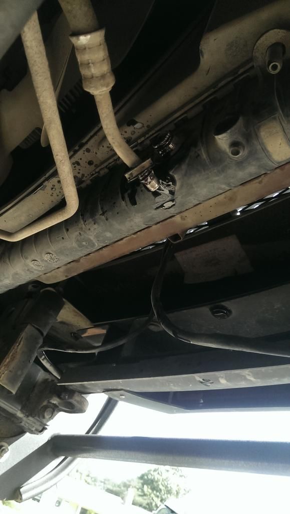

just try this: disconnect the tranny hose on the right of the cooler (bottom of your radiator if you have no external cooler, output of tranny), have a bucket to collect the oil (start engine), and have someone to maintain the hose in the bucket, then start the engine. No need to leave it too long, if you have oil flow you should have a lot coming out. (in case no flow, we will see if it is due to the pump (pressure test), BOOST valve, or TC/input shaft. let's try.
Ok ill have to try it in the morning. raining and dark out. appreciate the help man
Well eventually got a chance to try what you asked. I got no flow at all in any gear. Only had engine on for a minute but barely even drips
