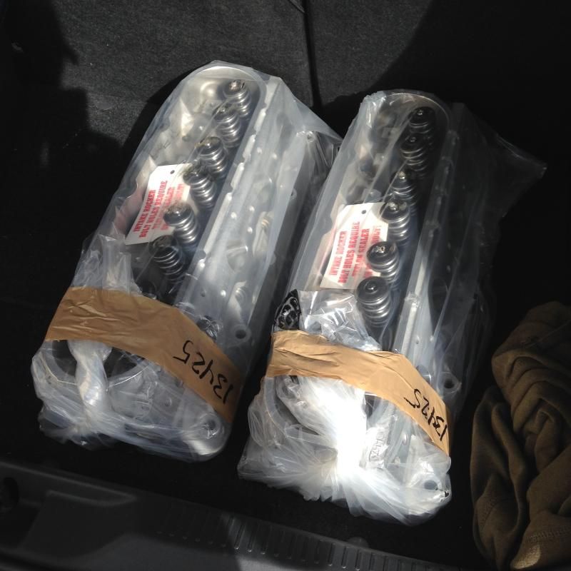

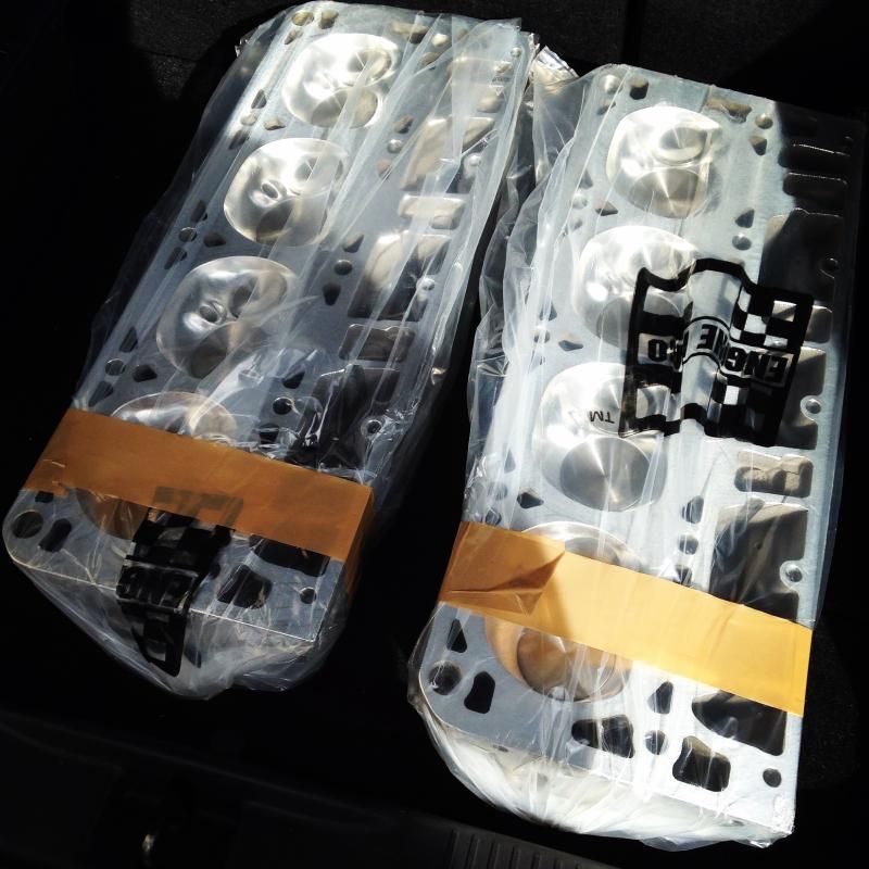

Finally got my heads back, now tearing down the motor putting my cam in and installing the new heads. I wanting to upgrade the injectors and fuel system. I'm going to install 60lb injectors. Having a hard time figuring out which way to go with the fuel pump, any suggestions?

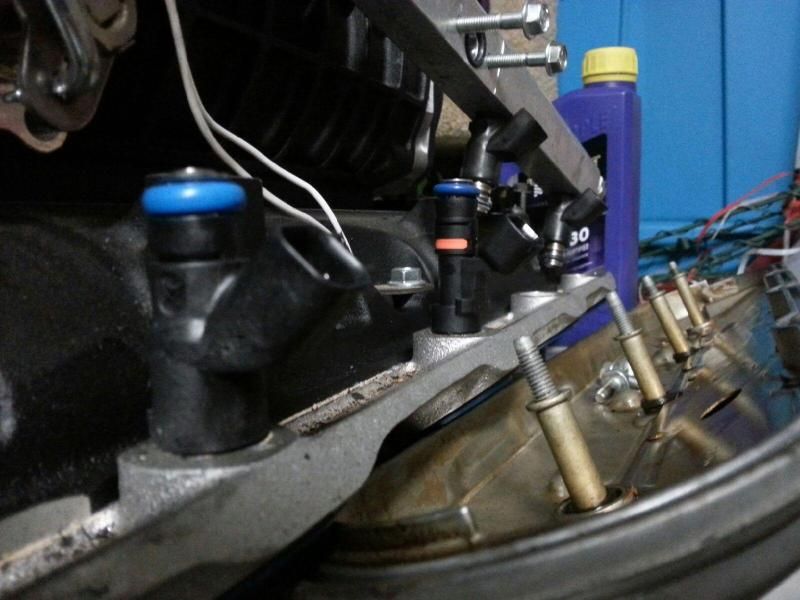

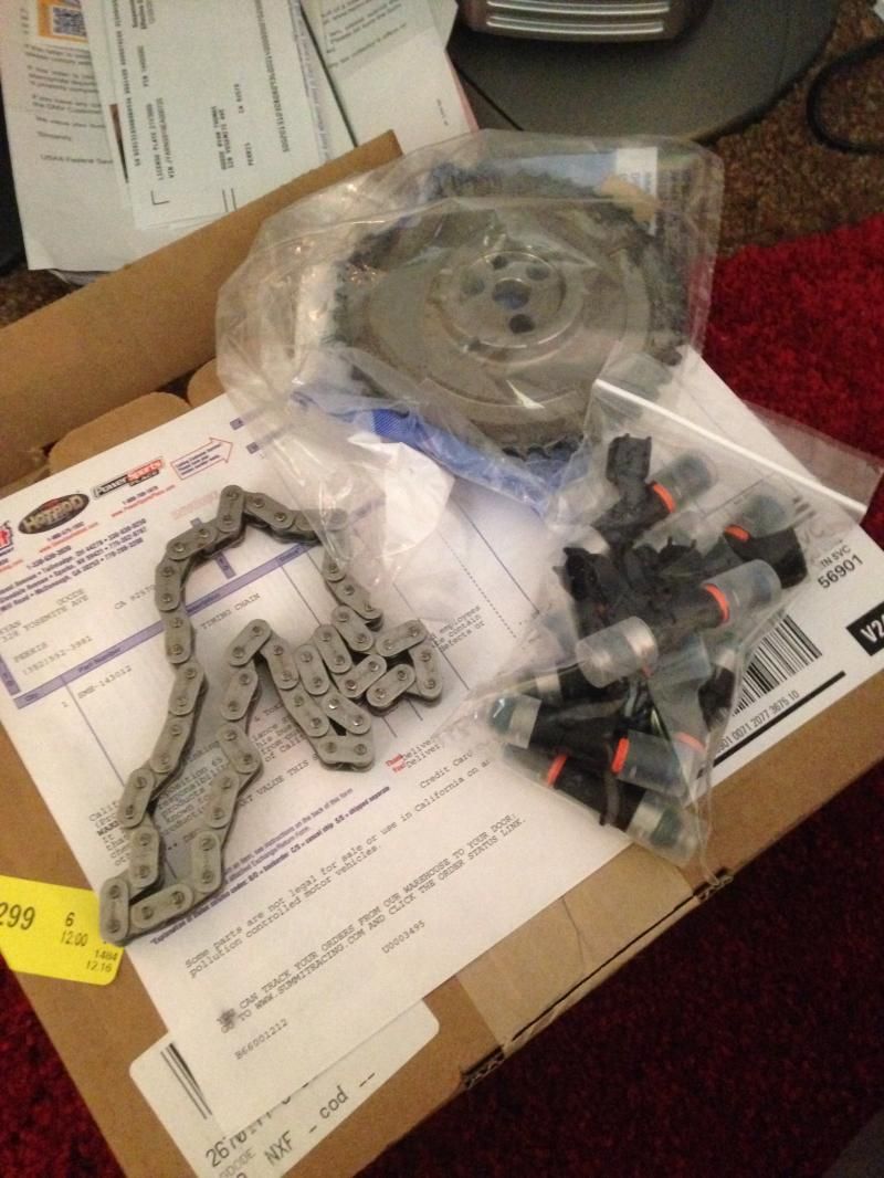

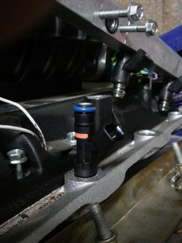

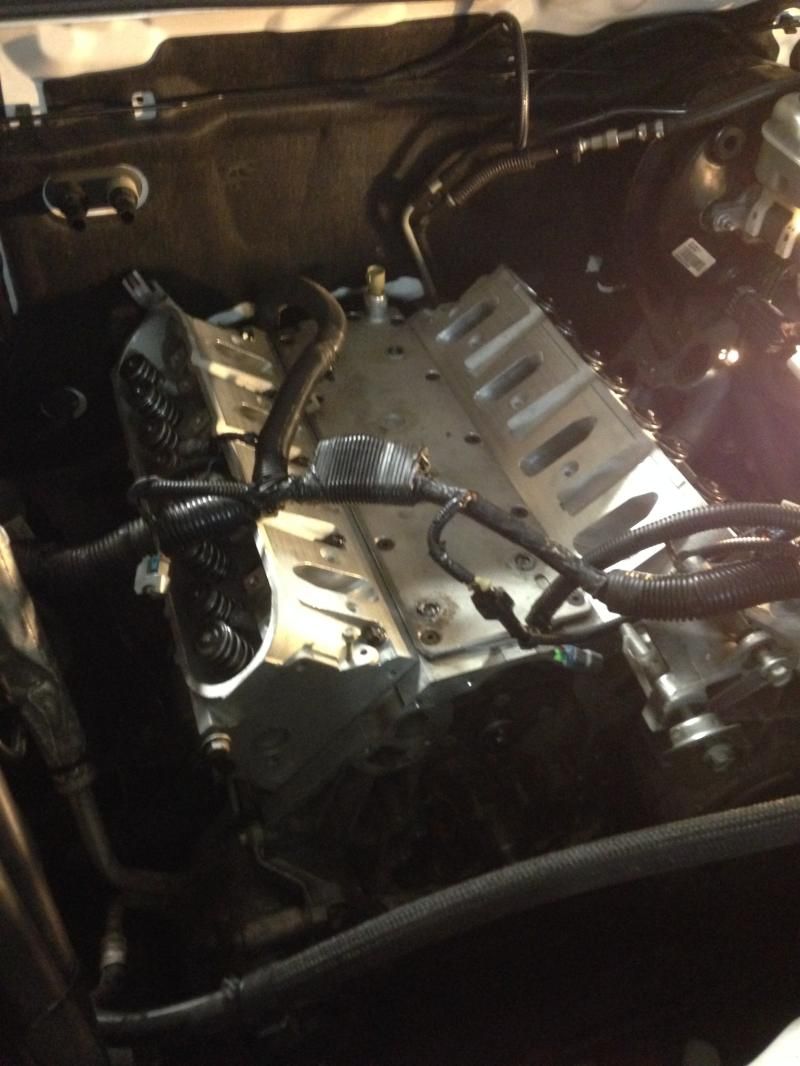

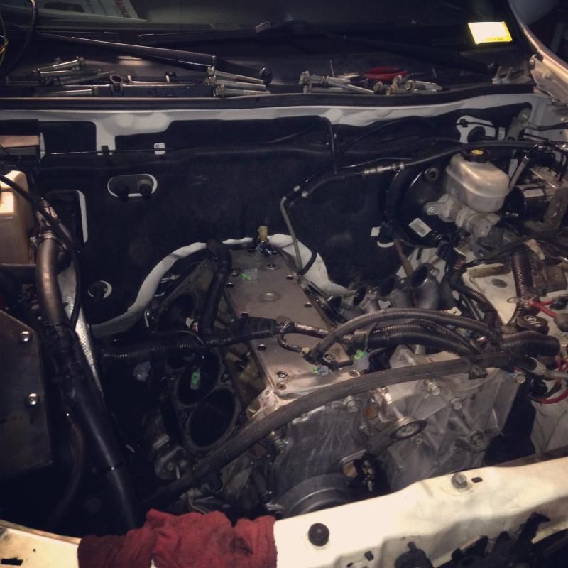

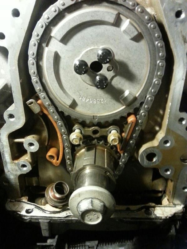

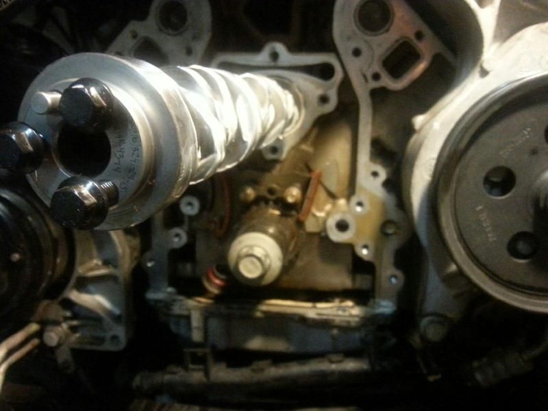

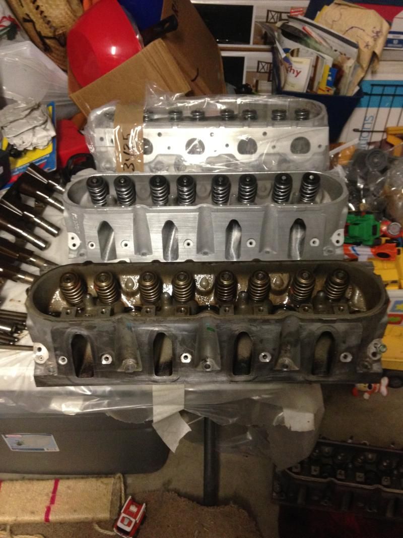

Heads are on, and cam is in. Bought LS2 60lb injectors, which look like they will work fine with the Magnuson fuel rail and supercharger. I also bought an Aeromotive in tank fuel pump. I'm going to put the engine back together with the original fuel setup first, to make sure it starts and runs fine. Then I will install the new injectors and fuel pump, so I can troubleshoot it easily. I also installed a stronger LS2 cam chain.

Swap the dampener. Every one of the ones like above I have seen explode. Go to the ls3 part number
Timing chain Dampener? Good idea.
yes, the one installed is a death trap.
+1 on wat Cory just said on the chain dampener. Caused my single dowl cam to break the dowl and bend every valve on my old 6.0 canyon.
I like the LS2 timing chain swap.
Funny enough, I mentioned that same mod in another thread and everyone was trying to flame me for mentioning it....
