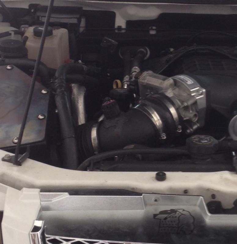

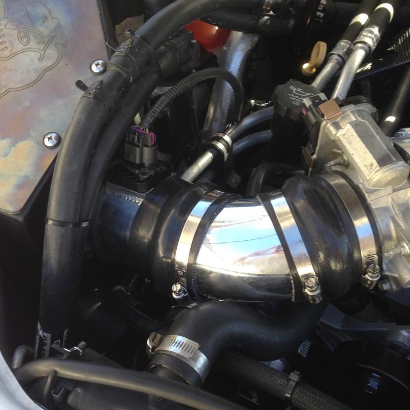

Nothing is wrong with the oem sensor just the location I had it in. I had to modify my volant intake to use with the magnacharger. I had my sensor to close to the throttle body, I have a much better setup now.
Notice the difference in postion for my mass airflow sensor.
Previous setup:
Setup I have now:
