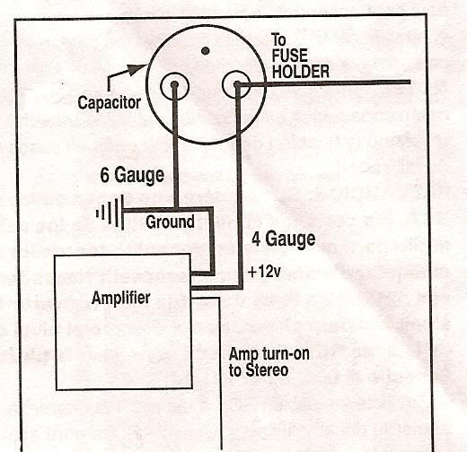

i never had experience with them but i always thought they go in the power wire between the battery and amp, but when i got one it came with this:
can you wire it either way, is one better than the other, or am i just stupid?
also would their be any diffrence between wiring like the one above or like this: (notice the ground)
i dont think it would matter but like i said, i dont have any experiece with these, so any help is apreciated.
that should be the same way to ground.. no matter what that wire is hitting ground.. doesn't look any diff.. i don't know much about audio.. but i mess with wire alot.. no matter what that wire is hitting ground..

Generally you want them close to the beginning of the power supply chain, and some recommend not fusing them, but it's not that big of a deal where exactly you put it, as long as it's got a large wire feeding it. I used a position off of my distribution block to keep it fused and used a really high value fuse so it could pass plenty of current.

Yea before i got my first capacitor i too used to think that it went inline between the power wires... guess not. Shouldn't matter which way you ground it so long as its a good ground.
2,643 Posts
Capacitors are not meant to be wired in line. When I had one if my last car ( damn I need to put it in my truck ) I had it wired so that the ground from the capacitor went to the body, the positive from the capcitor went to a distribution block.
The distribution block had a 4-gauge power wire coming from the battery ( fused with a 200 amp resetable circuit breaker ) into it and then the amps were fed from the distribution block with only the fuses actually on the amp.

Well, at least not the capacitor in this example. Other caps (like for crossovers) can be in-line. But I think Turbizzy didn't mean literally in-line (in series - with the positive hooked to +12V and the negative hooked to the amp's input which would be REALLY BAD - DO NOT DO). Smoothing caps like this are wired in parallel with the load (amps).

thanks for everything guys, i figured the ground would be fine cause i work with wires a lot to, but iv never messed with a cap.
thats what i would off done if it didnt have any instructions :true:
2,931 Posts
Right. Before i actually installed my first cap i thought it was wired in series to the amp's power feed. Then i found out its actually wired in parallel, tht makes sense since the cap is actually just basically a battery thats meant to take abuse so the car's charging system doesn't.
