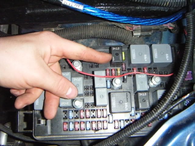

1. Pull your dimmer (Beam Select) Relay

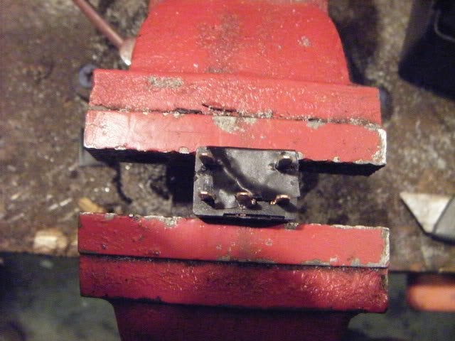

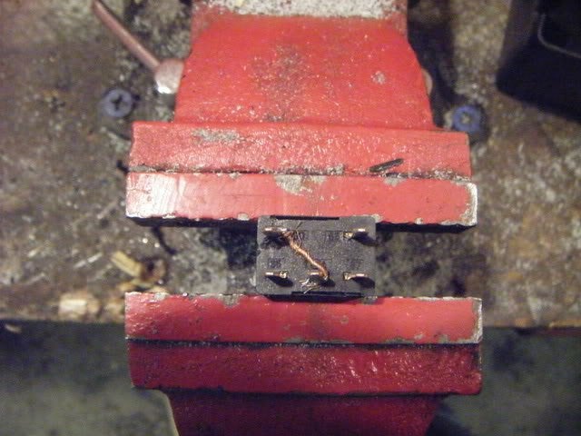

2. On the bottom of the relay ther are five prongs with numbers. You want to take the two prongs numbered 30 and 87a. Cut a jumper wire and solder the jumper to each prong. Then cover with electrical tape.

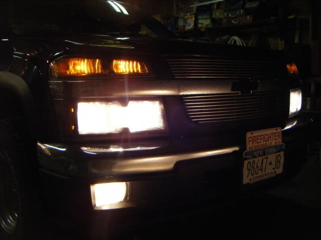

Before:
After:
