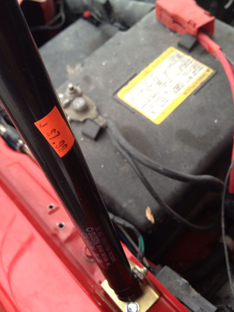

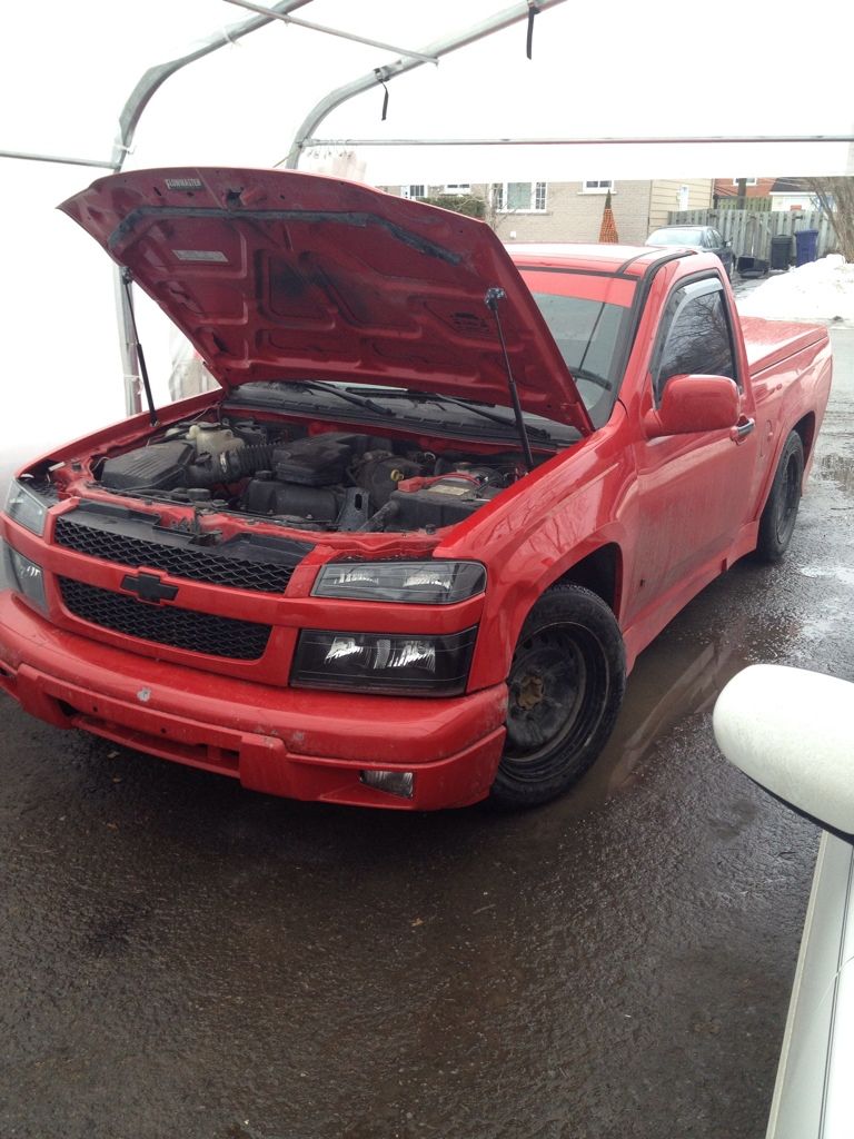

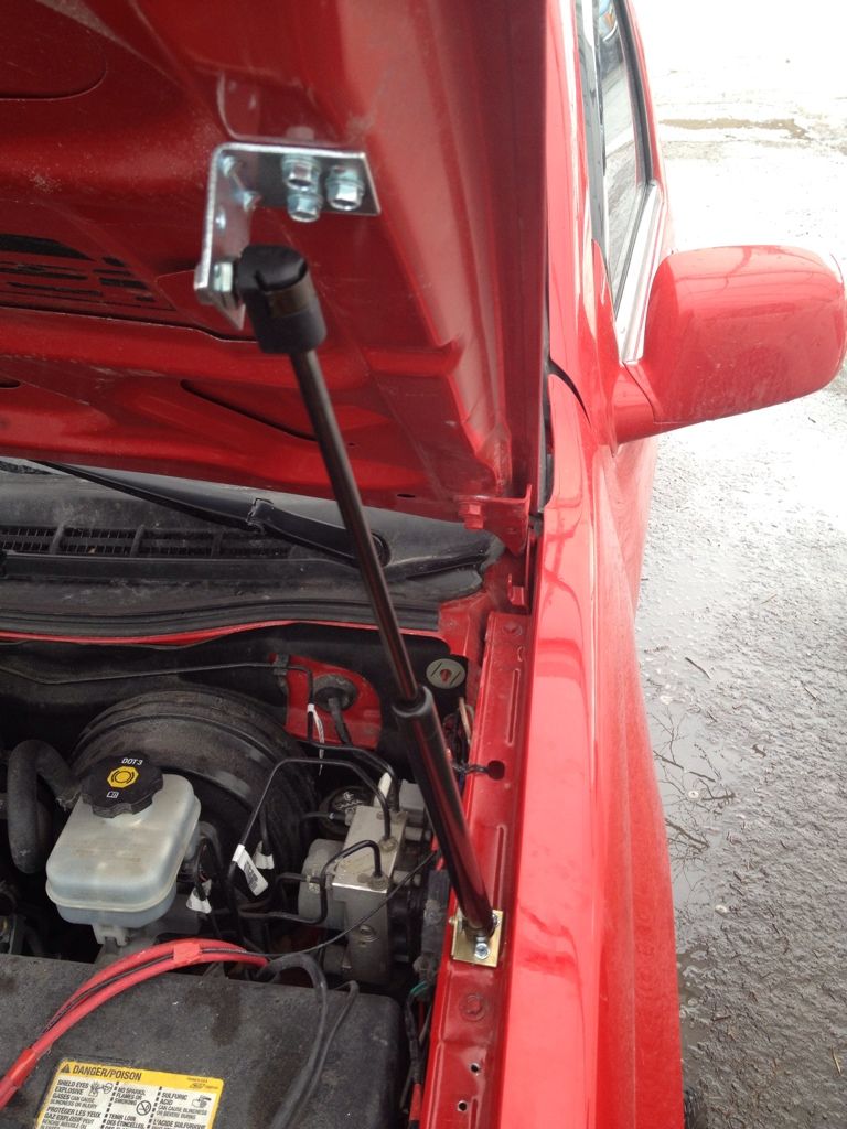

Here is how I did it..
Total cost 20$
I just have to paint the hardware and it will be perfect!

thanks guys!! just make sure if you do this to grab some strut that are at least 40lbs..
and those are 12inclose 20in open
#18 ·
Well those at 30pounds are making it alot Easyer to lift from poped to like 3/4 open they they start to really lifting the hood by their self.. I guess 40 or 50 pounds would lift it from zero...

Thanks !!!
Well Im ordering some 50 pounds from eBay with some better braket and I'll do the how to for ya!
It's really fuking easy btw specially if you have the mesuremts and the same strut/bracket.. Piece of cake!!
