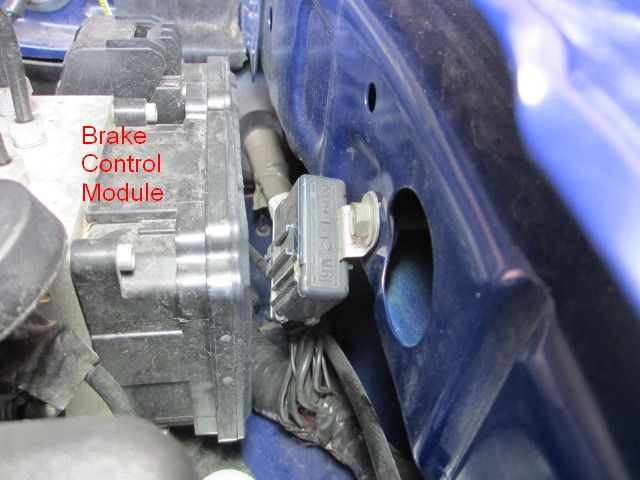

That's a major bummer. I am really surprised that the starter wasn't the problem. If there is any such thing as a "bright side", to what has happened, it is that you have eliminated the starter and the battery from the equation. When you have relaxed a bit and feel like trying something else, there are a couple of things to do. Something is interrupting the circuit, either on the power side or ground.
There are two relays in the start circuit. The BCM signals the Run/Crank relay to close, which provides power to the Start Relay. The ground for the Run Crank relay is G105, the infamous little black box, on the fender wall, aft of the battery. If you aren't familiar with it, let me know and I'll post some pictures.
The Start Relay is grounded through the PCM. There is less chance that the problem is there, but the ground for the PCM is on the left side of the engine block, just forward of the Crank Position Sensor, below the starter.

These are pictures of G105. A bunch of different grounds in one location. If there is sufficient access, try to open the box and check the condition of the terminals inside. The "cover" in only held on by two molded in tabs and the friction of the pins. I used a small screwdriver. At the very minimum, remove the bolt and clean the mating surfaces and tug LIGHTLY on the wires to check for broken ones.

I believe it's a Clifford rsx3.5. Viper and Clifford crossbred a couple units. It's literally tied into everything and whoever done the install knew what they were doing because it's very neat and well put together. I will tell you after chasing and cleaning all the grounding points you mentioned, that soon as I got them hooked back up, it started up just fine with both the key and the remote start. I cycled it back and forth nearly 20 times and not one problem. So maybe it was just crusty grounds.

Okay, that's good news. In the start circuit, I think that ground point just affects the Run/Start relay, which could cause the engine not to start. If you didn't move anything in the fuse box, this time, maybe you found the source of the problem. If you also moved the relays, there may be a bad fuse box connection to one of those. Keep us posted.
