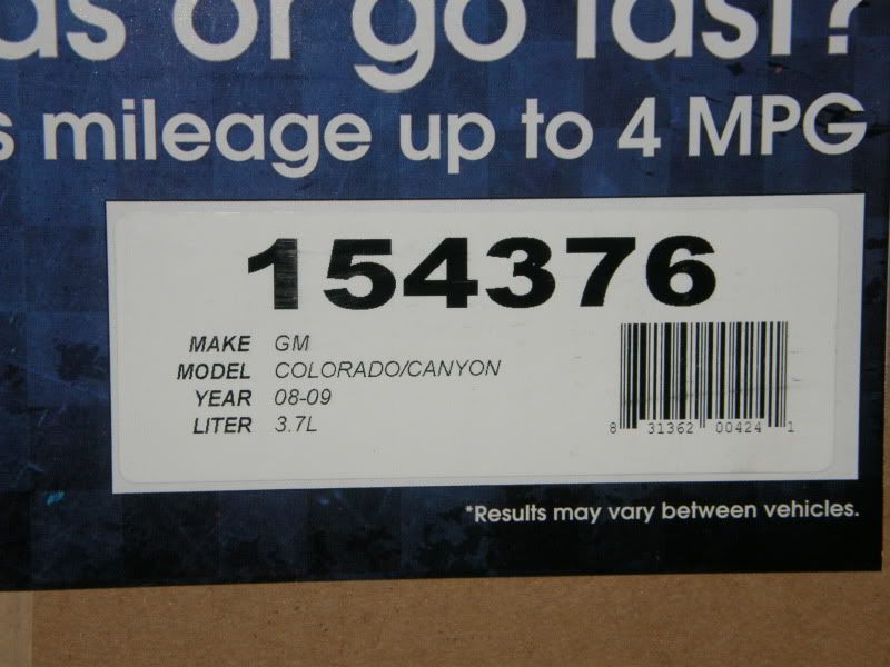

I really like the idea of the Volant intake and really want to like mine, but after aborting the installation due to various fitment issues, I'm just not sure anymore.
The first problem is on the Volant website the 2007 - 2010 2.9L PowerCore filter intake is listed with part number 154376. When mine arrived the part number on the box matched that but it was listed as an '08 - '09 3.7 intake. I emailed Volant and after a few days with no response called their tech support line (which is only open Mon - Thu) and the rep said that it was probably a typo on the label. I eventually saw on the enclosed spec sheet that it was for a 2.9. OK so far, I guess.

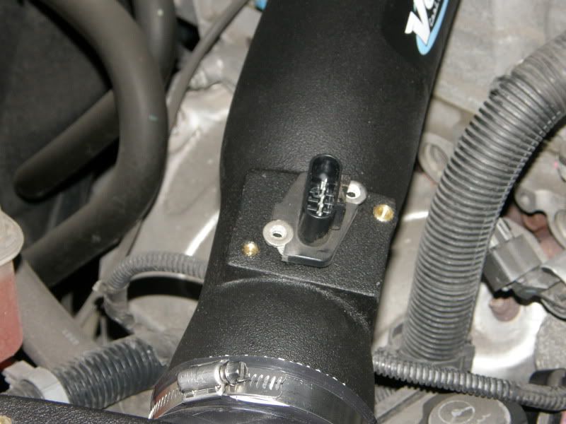

I went to install the tube and the throttle body end silicone coupling was at least 1/4" larger diameter than the throttle body opening so I used the coupling off the K&N which was a perfect fit. The last thing was to install the MAF sensor which I could not do because the threaded holes in the tube were way to wide for my narrow MAF mounting screw holes. It's as if the MAF required an adapter plate like the one that came with the K&N intake but there wasn't one in the box nor did one appear on the instructions.

looks like you got a 3.5l 04-06 tube and box......they changed the design of the maf sensor, and 07 up had extra hole in side of box for some smog pump thing..... take pictures of the box. also the throttle body is most likely smaller on the i4....Im pretty positive you got a 04-06 3.5l intake

Interestingly, there are a couple of small self tapping screws included in the hardware package with no explanation of what they're for. I'm wondering if their intent is to use those to attace the MAF sensor to the tube? I can't imagine any intake manufacturer installing it in that fashion but you never know!

The opening on the maf location looks right. I think the self tappers are for the maf to the tube.
Be extra careful not to strip the plastic. Also make sure you have a good seal.
Another option(that should work )
is to run the ssk maf adapter plate. It will mount to the 2 threaded holes. Then the maf sensor will mount to the ssk plate.
Didnt even know that volant came out with one for the 07.
We put a 06 on a o7 with my maf adapter plate.
I would try it like it is. If it does not work, then try something else.
Let us know how it goes.

Thanks for the suggestions, Ron. At this point I have nothing to loose (other than a little time) by mounting the MAF sensor on the Volant tube with the self tappers. I can also see how close the K&N tube shape matches the Volant and perhaps mate the K&N tube to the Volant airbox. I guess the thing that bothers me the most is the need to use self tappers into plastic to mount a critical component like the MAF sensor. I'll give this a shot one night after work, weather and other around the house projects permitting and update this thread with the results.

I finally got this installation completed but I had to get creative, especially in light of the poor fit of the Volant intake tube and the need to use self tapping screws in the plastic tube to secure the MAF sensor.
So....I used my K&N intake tube and mated that to the Volant airbox. Now I've got cold air and the reliability of the K&N MAF sensor mount. But I also don't have a used K&N intake to sell now. Oh well. I'll try to get some pictures up later today.
