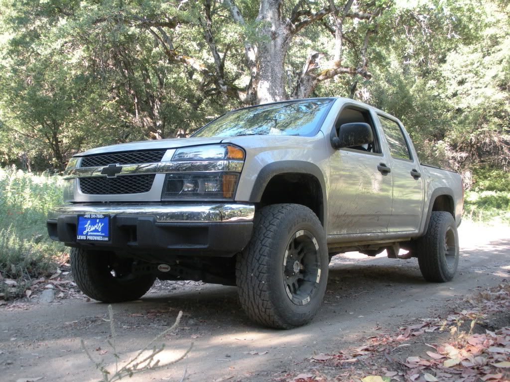

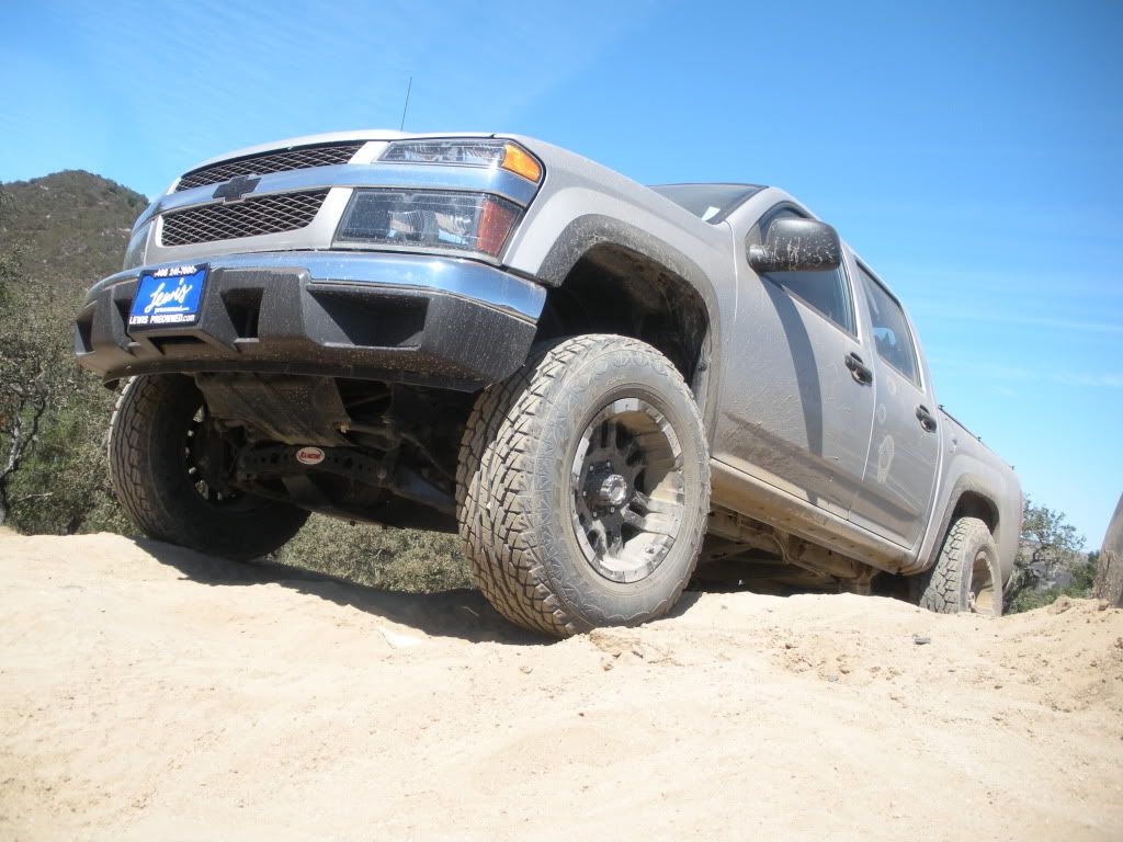

My truck came with 17" Moto Metal 951s, but the offset is too aggressive for me. I have put Falken Wild Peak tires on the wheels, they have about 8000 miles on them right now.
Im willing to trade for almost anything with a higher offset, these are -12. im looking for closter to +10. I would want to trade for similar tires, or have them switched out at a shop.
I like the black "D" window steel wheels, but im open to almost anything. not interested in anything chrome.

you know you can't run stocks with the lift right? what im finding rancho says to run a 17x9 with 4.5" back space, if your wheels are 9" you are about as far in as you can go at -12 offset, in a 9" wheel with around +10 offset your backspace will be almost 5.5", so you are going to have to run a 1" spacer by their measurements and puts you where you are now. basically you need a skinny ass wheel and tire with low backspacing to bring it in any over what it is now
