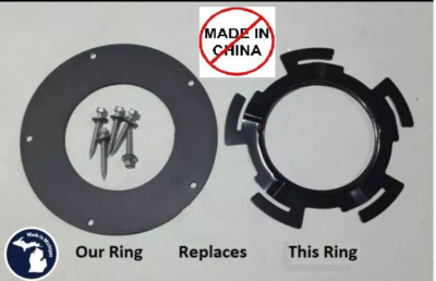

Hello everyone! I was hunting down my large EVAP leak and after smoking it and seeing it pour out of the top of the tank, I dropped the tank and found the fuel pump locking tabs rotted off. I tried the repair kit they sell with the seal all TWICE. I made sure to grind the metal tabs down flush on the tank, clean and rough up the plastic surrounding it very well, then a final clean with alcohol before assembly. I then let it dry / cure for 12+ hours before installing it back in the truck. I feel like it stays sealed until 180-200 miles after and then I get the gas cap light. (Thinking that when the fuel tank pressurizes to do the EVAP test it blows out the seal from the pressure ? ) I live in NH so I need emissions in working order to pass state inspection unfortunately. No junkyards around me have anything that's in better shape, I saw a few on eBay for $800 +.

I don't think those ring repair kits have even a 1 in 50 success ratio. That said, did you check the filler neck? Connected to the neck is a small vapor tube, where it's welded on pin holes can develop. They can be so small that you can get an intermittent code.

I found a few posts online with people using the repair kits, few YouTube videos too, I thought it had a better track record then that but apparently not Haha. I did check the filler neck and all vent lines, they checked out well. Thanks for the heads up on the tank years!
Mine was rotted so bad that every time it rained I had to crawl underneath and pull the fuel filter to drain the rainwater from the tank.
I used this kit on mine last year. I found the trick is to not torque the screws down like you're torqueing on metal, and I used the entire tube of sealant on both the underside of the ring as well as all over the top. That was 1 or 2 years ago.

I replaced my fuel pump, replaced o ring, since I didn't have a snap ring I drilled 4 -1/4" holes in New fuel pump where "0" ring is compressed , then having someone hold fuel pump in place , drill 1/8" into the gas tank threw the center of the 1/4 holes then get all 4 screws started then tighten screws evenly.
If you want, put silicon on before tightening screws for a better seal ( I didn't an it didn't leak) but that's up to you !!! I've done 3 like that an never leaked !! ;)(y)
