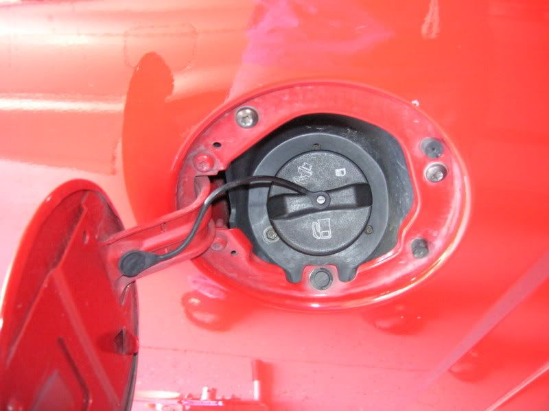

3. Remove the gas cap to relieve any extra pressure in the gas tank.

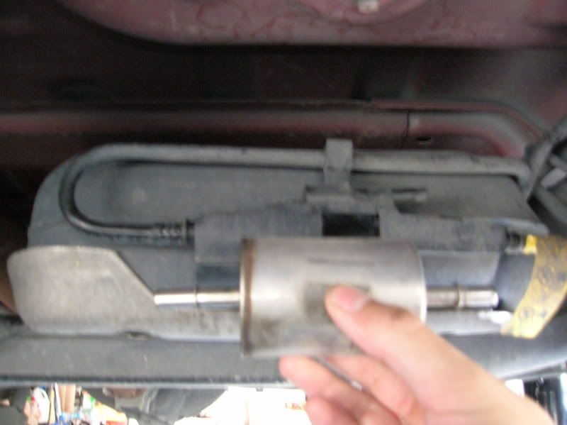

Towards the rear of the cab you will see this, the left side is the inlet(from the tank in the rear) and the right side is the outlet(towards the engine)

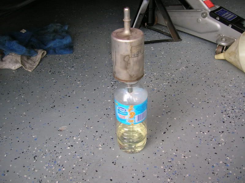

5. "Look at the connectors on the hoses attached to the filter ends. See the two little plastic squares? Push those in to remove the lines from the filter. Kind of like a childproof cap on medicine bottles. I suggest removing the inlet hose (the one that comes over the top of the filter) first. That way you can leave the outlet hose connected and reduce your fuel loss. Have a rag handy because you will lose fuel from both the hose and the filter."(Sarge)
I lost about 1/4 cup from the inlet side and then 1/4 cup from the outlet side. There was roughly 1/4 cup in the filter itself!
6. If the new filter has plastic clips take them off, you will not need them.
7. Make sure the filter goes on the correct way, inlet on the left side and outlet on the right side. It should slide into the holding bracket and sit nice and tight. Also make sure when reconnecting the lines that you hear a click so you know each side is locked on tight.

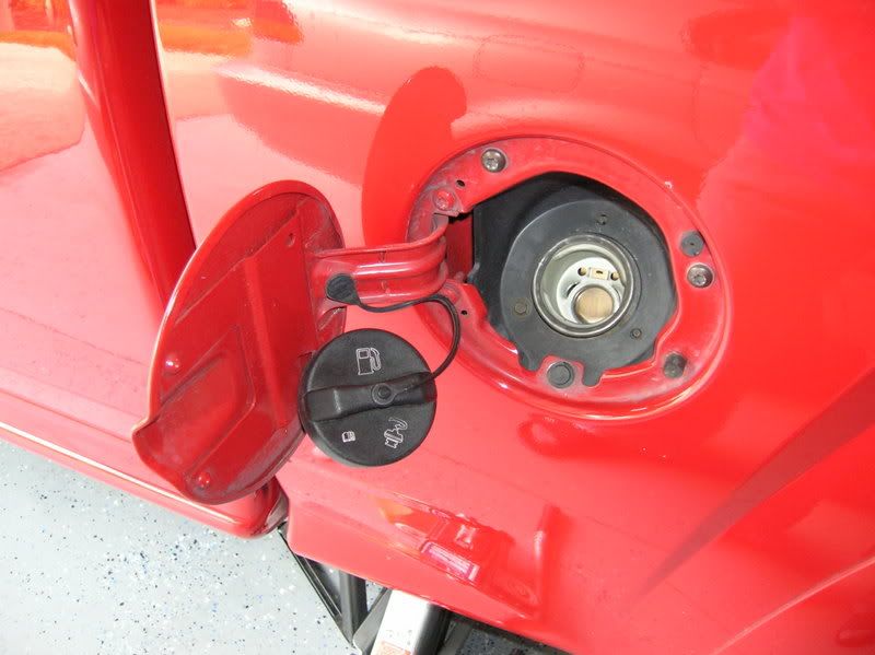

8. Now lower the truck, put the fuse back in and screw on the gas cap.
