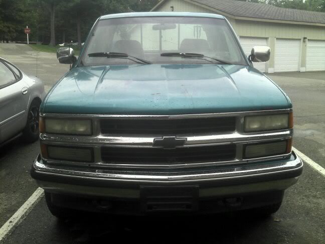

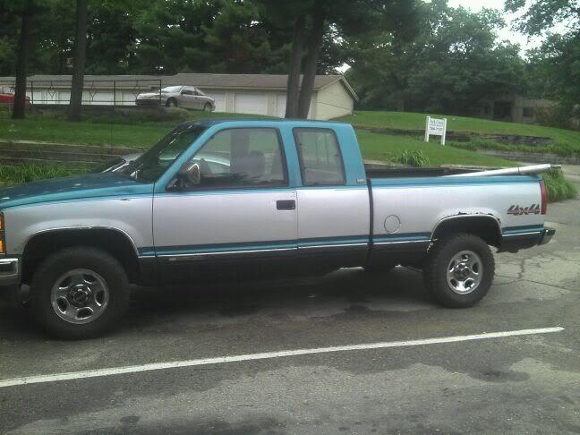

TOW RIG

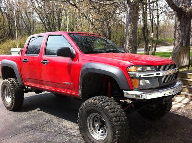

THE RADO

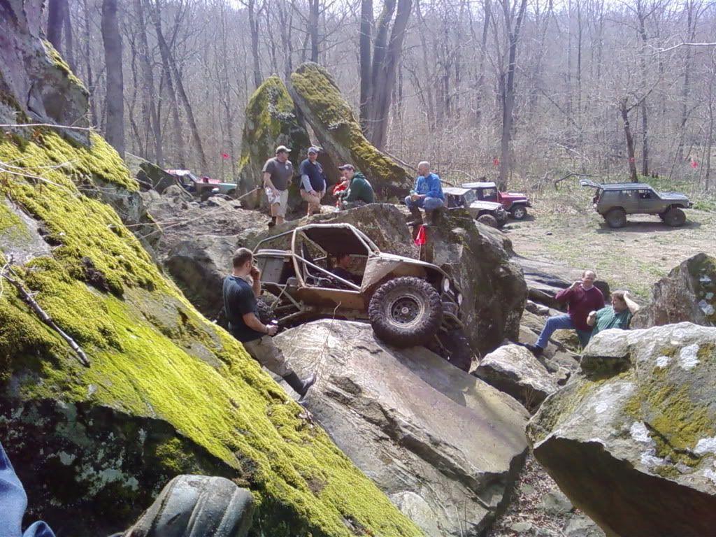

THE CRAWLER

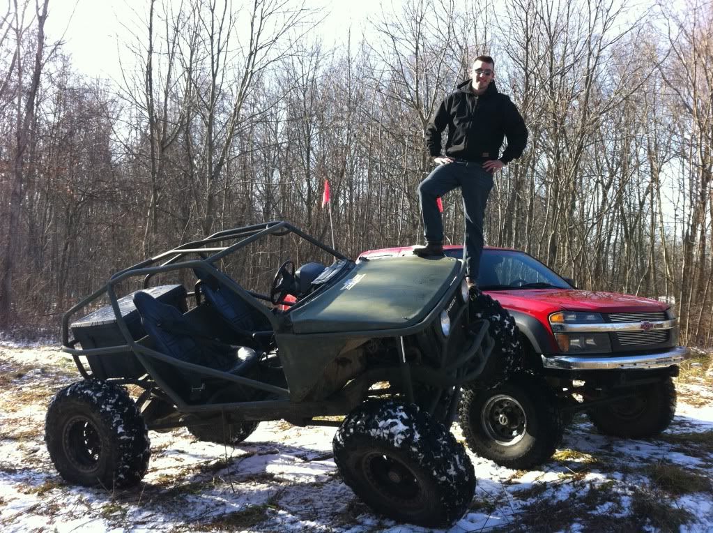

Rock Buggy Specs
1991 Geo Tracker, 1.6 8 valve Tracker motor!@#
with Doug Thorley header and K&N universal air filter from Auto Zone
1990 Geo Tracker automatic transmission,4.24 Trail Tough Gears,!@#
1996 Geo Tracker transfer case, 1991 rear output modified to give both 2 and 4 wheel low
High pinion Dana 44 front, 1979 Ford F150 center section, 5.38 gears,
Lockright Locker, Warn Chromoly axle shafts, inner shaft would be from 1975 international Scout II length,!@#
from the ball joints out are 1979 Ford F150 including outer stub shafts
High pinion Dana 44 rear, 1979 Ford F150 center section, 5.38 gears,!@#
outers are 1975 International Scout II, including shafts, wheel bearings,ect.!@#
welded with disc brakes, disk brakes are 1985 Camaro front calipers and pads, rotors are from Jeep CJ 7
3 link coil front springs are from Jeep TJ, 4 link coil rear springs, I don't know remind me to give you a spare
1975 International Scout II steering box, ported and tapped with PSC ram assist,!@#
power steering pump would be from early 80's Chevy truck, tie rod ends are from mid 80's Chevy 1 to

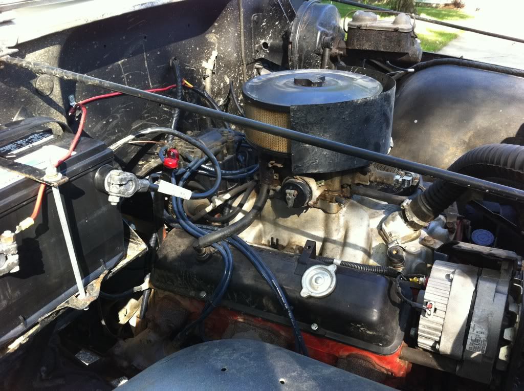

THE WHITE BEAST
82 cj 7 on 42 tsl swampers brand new with the nubs and all it has Dana 44 front and Dana 60 rear both r locked it has a 355 bored 30 over and a 208 t-case it is a eye catcher!

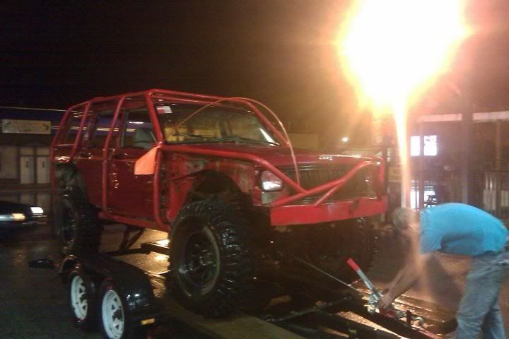

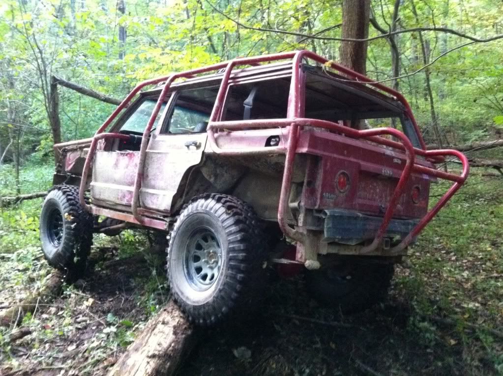

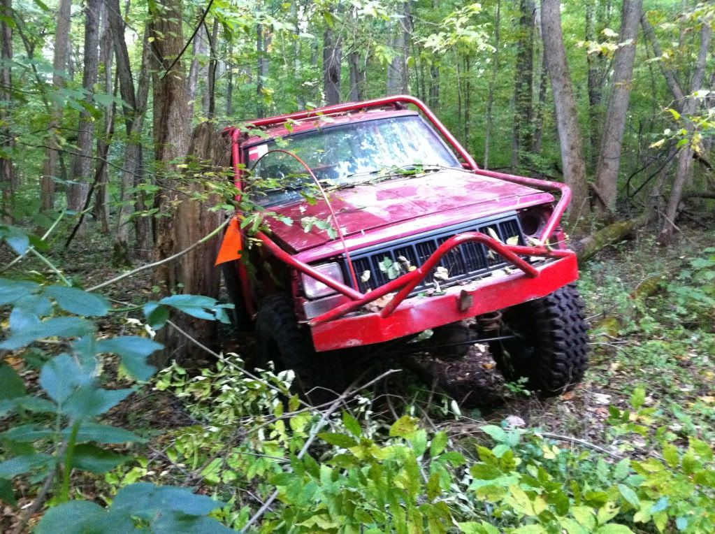

RED ROCK THUMPER
91 Xj
91XJ off road rig. It has new 37's with new rims, New lift jack, SYE, 6.5 inch long arm lift, and a complete exo cage and front and rear tow points, It aint pritty but it wheels great. It also has a aussie lunch box locker in a D30 and a welded 8.25 in rear
