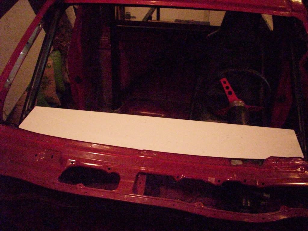

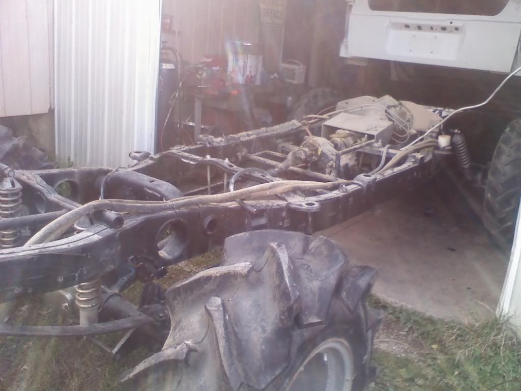

Hey there everyone, I've been on here for a little bit now and havent started the build thread I did for my Colorado, so heres the pictures of where it all started.
Heres some pictures of when we first started switching the Avaitor over to the Colorado body and pics as we went along. I have more of them, just not on my work computer
This is when we put an S-10 bed on it to see how it would look

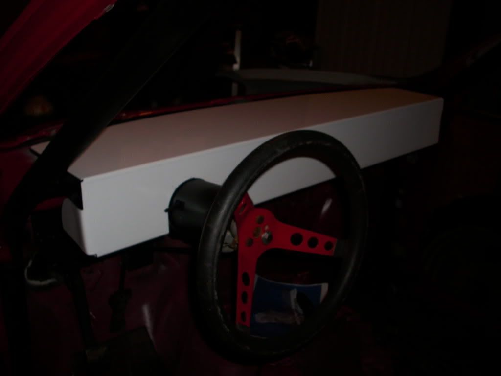

Picture of the dash I designed

The start of the New Dana 60 and stuff from last winter

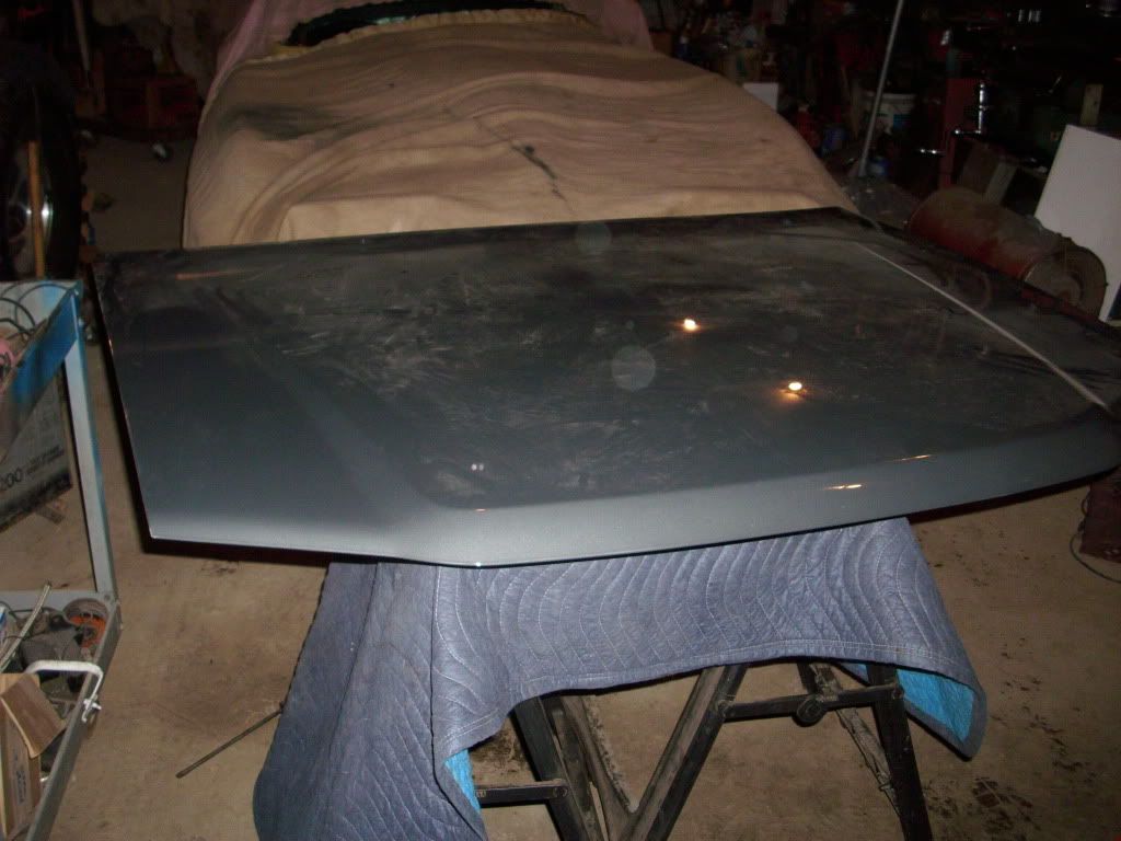

To me it looks like he kept the stock fenders. The body is lifted high enough that it flows over the tires, which are forward the usual axle placement. Without the front bumper, it just kind of hangs there.

Thank you everyone for the comments, it really means alot! The truck has been a work in progress over the last 2 years and its come along nicely, but not with a few bumps along the road, but it makes it all worth it when I stab the throttle at the races :) We ditched the Dana 44 over the winter and swapped to the Dana 60 b/c we kept snapping axle shafts every time we launched off the line with the 44" tires, and those were even the Ground Hawgs up front! We put a spool in the 60 with Boggers up front now and its been good minus a couple stripped ring and pinions. The motor is a 565 BBC running at 14.5:1 compression on 114 octane VP racing fuel. We also spray 500 HP of nitrous to it just for an extra kick :D
The fenders up front are extended 7 inches, but unfortunately I do not have any pictures of when it was getting done. I have a buddy of mine that did all the paint and bodywork and he chopped them up for me. I don't have the patience like he does when it comes to bodywork lol. The only reason we had to change them was because of rules for one of the classes I run it. The middle of the wheel well had to be centered over the axle to be considered in "stock " location, so we changed it around to work for it and it actually isn't too noticeable without looking closely. I wanted to toss a bumper up there, but I decided to keep the weight off and keep the truck on the Jenny Craig diet lol
