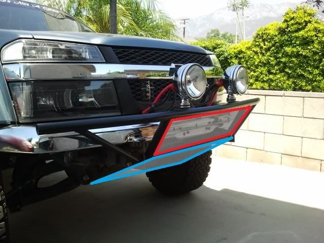

So i designed and built my bar finally, now the question is the skid plate.
Want some feedback as to if i should go with a skid plate only on the top portion, (outlined in red) or go all the way down (outlined in blue with the red portion).
I no going all the way down obstructs my oil filter accesibilty but Ive thought of that. What ya think
Heres a different angle
#4 ·
run some bars down to inbetween your a arms and run it all the way down for sure. what good is a skid plate if its only above your frame. plus extra strength in the front never hurt anybody. jus weld tabs so the skid plate is removable so u can still access under there if needed.
#8 ·
thats what i was thinking with the tabs. i bought them ahead of time. just wasnt sure what i wanted to do when i built the bar
and i cant really tell but IMO id drop the top bar a little below the headlights. maybe to where it is aligned with the top of the bumper that way its out of the way of your headlight beam. but i cant tell how high it is now.
it is below the headlight beam, just the angle of the camera makes it look above it. good advice though man
#5 ·
#10 ·
theres alot of ways to do it. i like the tabs only because you can easily take it off to clean it up or work under the truck. what i have seen alot of ppl do is drill holes along the down bars and just pop rivet them. either way works ive personally never pop rivet a skid plate on any of my bumpers but i dont see why it wudnt work.
