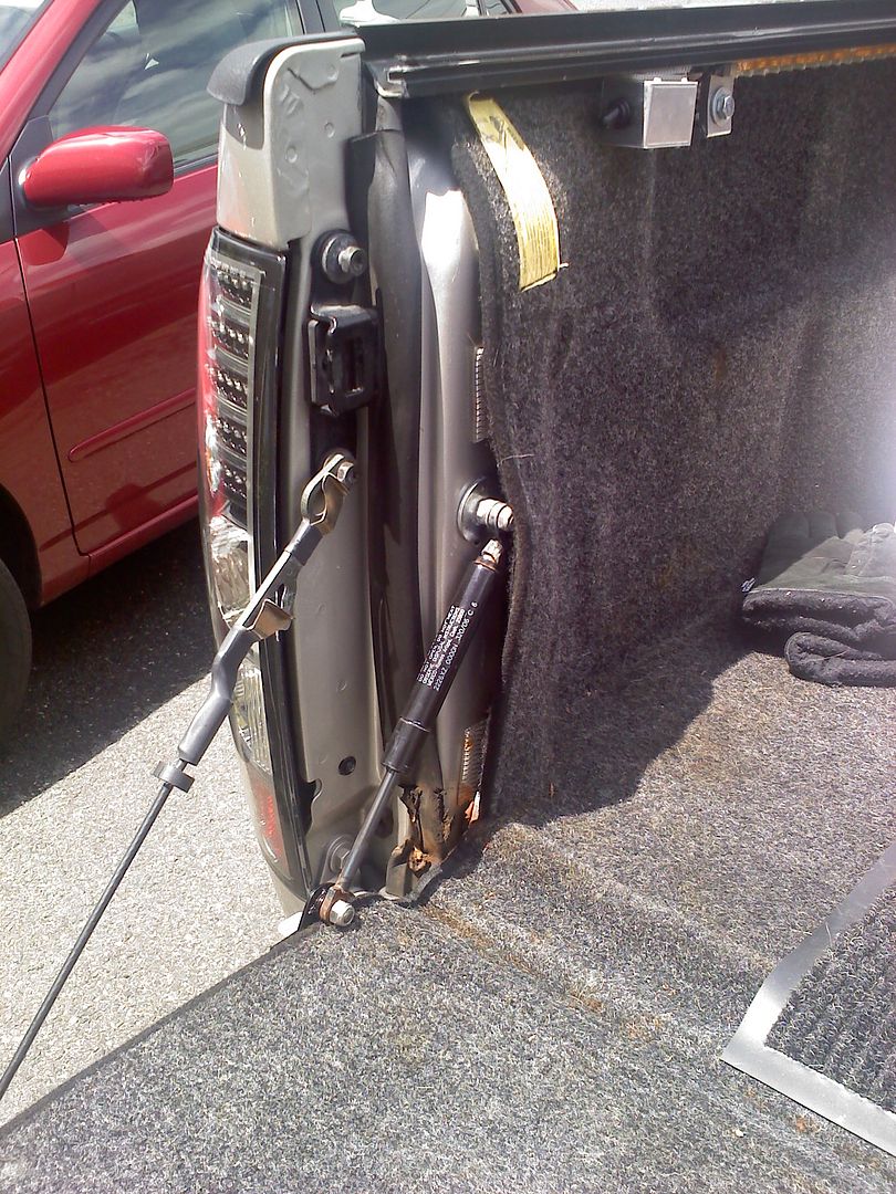

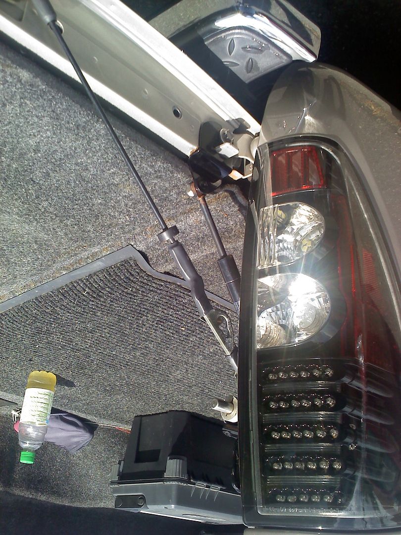

Step 1. Remove driver side tail light. Check hardware list, pre-assemble and mach up upper shock mount location.
Step 2. Drill a 5/16" hole approx. 9 1/4" from bottom of cargo bed.
Step 3. Install upper shock mount.
Step 4. Install lower shock tailgate bracket.
Step 5. Install Shock. DO NOT OVER TIGHTEN.
Finished:
