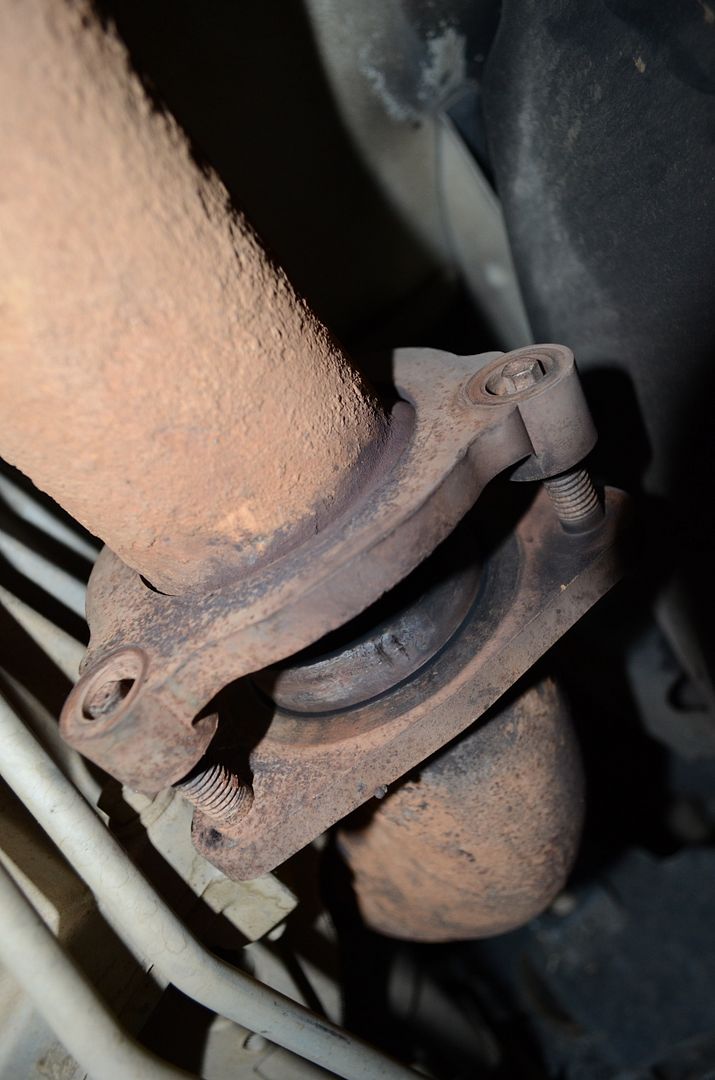

Using the prybar, if needed, break the collecter flange away from the bolts
With the flange apart you can see the old gasket in there, it may also fall out when the flange is pulled away.
