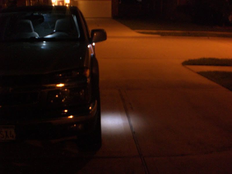

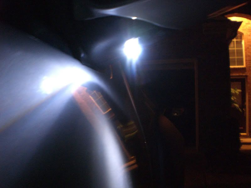

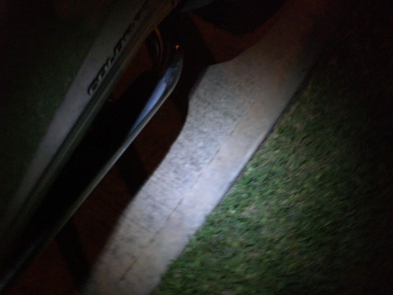

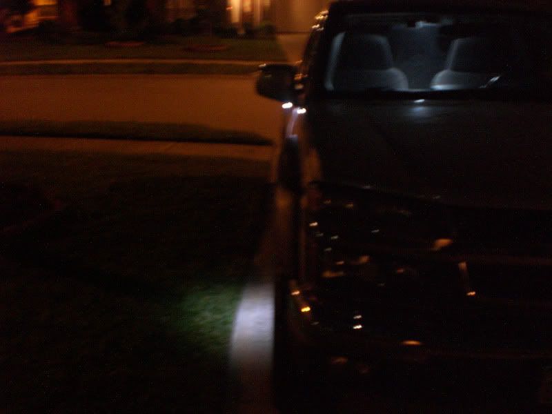

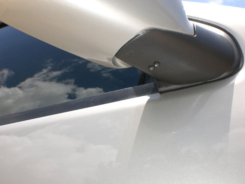

After 3 days of wiring and installation. I finally finish my Puddle lights. After seeing these on most luxury cars. I decided to put them underneath my side mirrors with a slight fade ON and a slow fade OFF. Hopefully i can get some night pics and better night video. Garage is not dark enough during the day. Wiring these was such a PITA getting all my wires for the turn signals and lights through the door boot.
