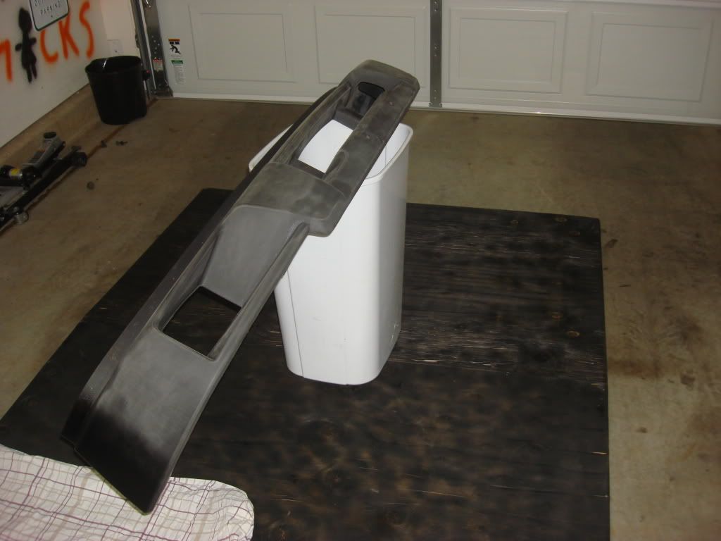

Painted the front valance.
5.2K views 20 replies 13 participants last post by  rocketcityrado
I know it looks subtle, but I like it. It was a pain in the ass taking that thing off!!! I will paint that grey plastic crap on the rear bumper later this week.
#8 ·
YES. BE FUCKING CAREFULL!!!!!!!!! I broke EVERY SINGLE TAB, push them thru from the back!
I used Duplicolor Prep Spray, then adhesion promoter, then Bumper Paint.. all duplicolor..

well.. since someone mentioned it..
I have painted my mirrors, front valence, rear plastics (before I put a rollpan on) wiper cowl and handles.. all the same way
heres what I used:
