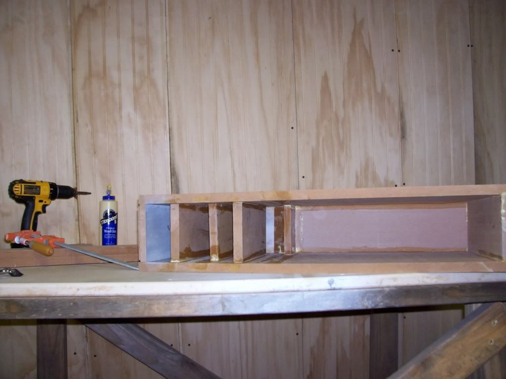

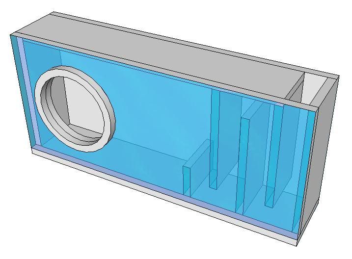

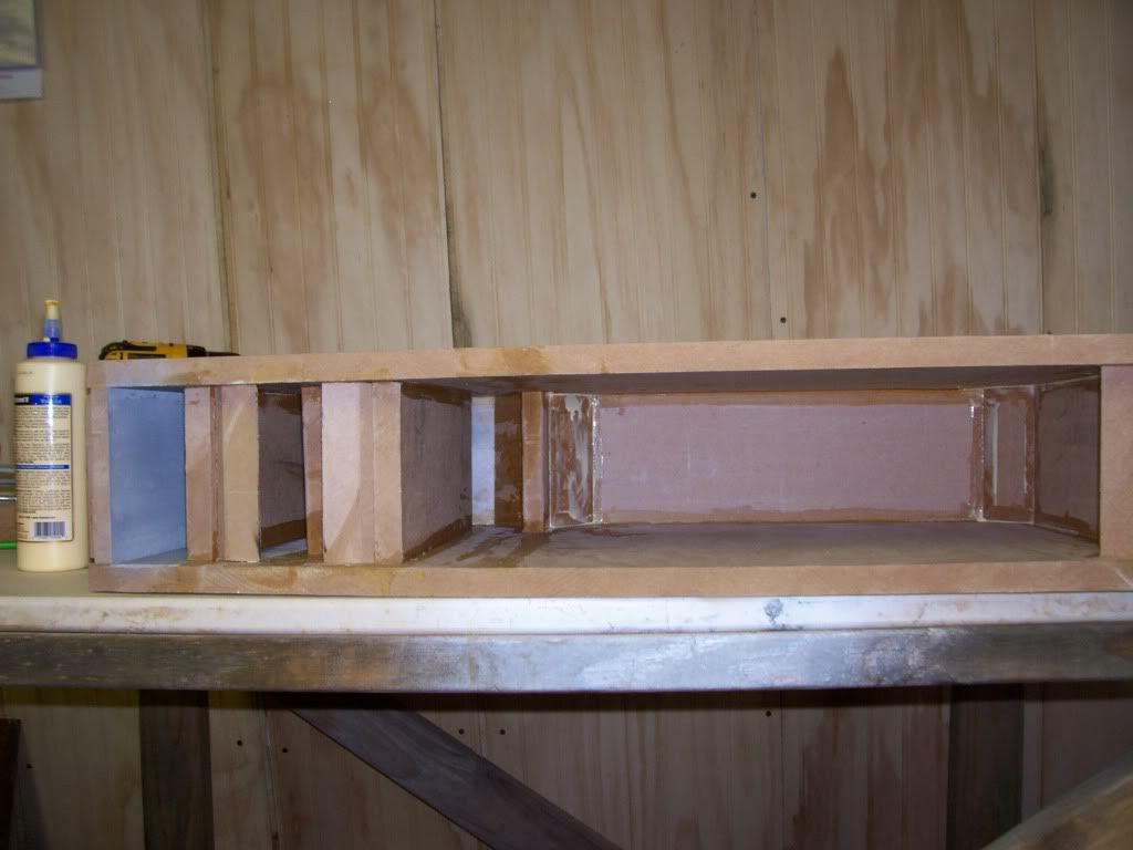

I don't know the specifics of it all, but I know that the length of the port, which I'm assuming is what you mean by the baffles, determines the tuning frequency of the enclosure. Properly designed ported boxes allow the subwoofer to hit the lower notes better than a sealed enclosure.
#7 ·
interesting.... so whats the benefits for making a "pathway" for the air to flow?
#8 ·
If, by "pathway", you mean having all the turns in the port, that is called port bending. Basically, the port needs to be longer than the enclosure will allow in a straight line so you bend the port to make the correct length fit. The length is measured along the centerline of the port.
If you are referencing the angled pieces in the corners of the port and sub chamber, they help diffuse the dead spaces in the corners and create less tubulance in the moving air. It also strengthens the corners of the enclosure. This increases the efficiency of the enclosure.

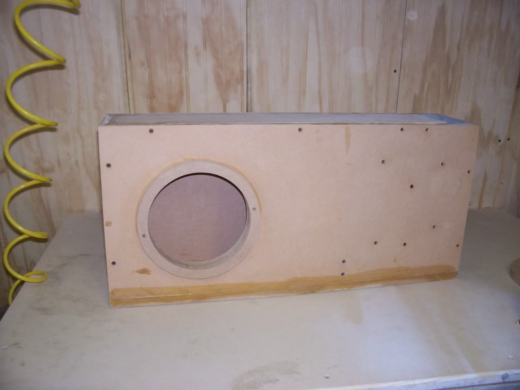

#23 ·
At this point, that is a final picture of the box.
I already have the box installed as it is in the picture, but I am going to pick up some black carpet and cover it as soon as I have some more spare time.
All of my wires still need to be hidden as well. After that I will snap some pictures and a video.
