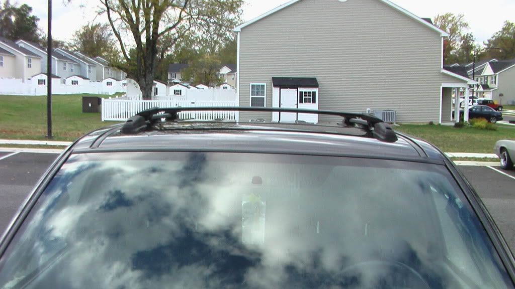

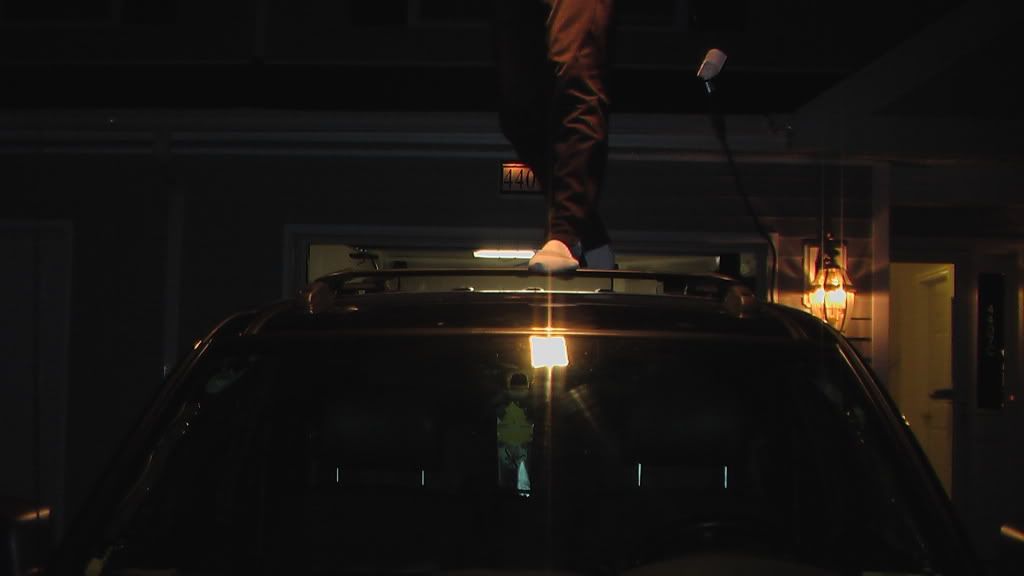

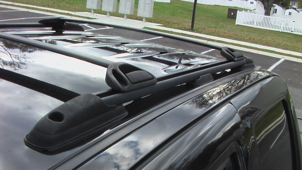

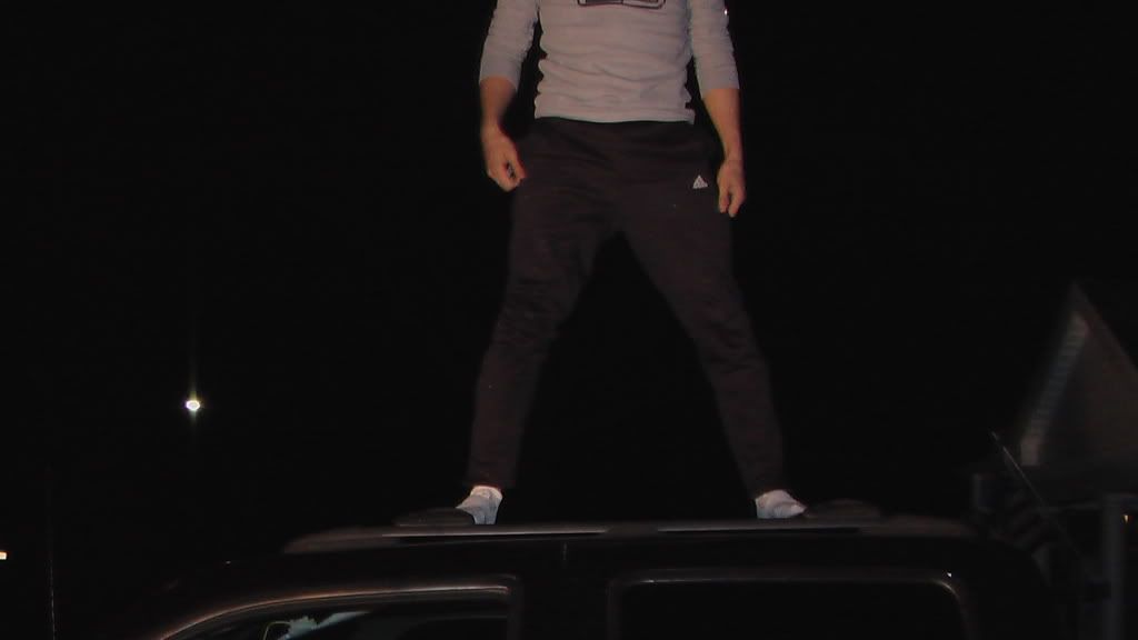

I started with the stock rack from a Chevy Blazer which almost worked but I could not get the right angle for the mounts so I kept looking around. I finally found a 2004 Chevy Avalanche with a roof rack that worked perfectly from a junk yard for $25. I had to make a few modifications to the length and width but once I was done it mounted nicely to the roof, sealed up with no leaks and holds plenty of weight. I was so sure of the weight capacity I had my wife take a few pictures of me standing on the rack without it warping at all. I weight approximately 170lbs and I am sure it could hold way more. The 6 Large mounts dispurse the weight very well.

fbody4life - The rack is mounted to the sheet metal. The roor supports are on the other side of the gutters and there was not enough room to mount anything there. Also, if you pull down your headliner you will see that pretty much anything that is aligned with the gutters towards the outside is covered by the airbags. You could mount the middle mount on the roof support that goes along the width of the truck but the other two supports are to close together and there wouldnt be much purpose for the rack.
