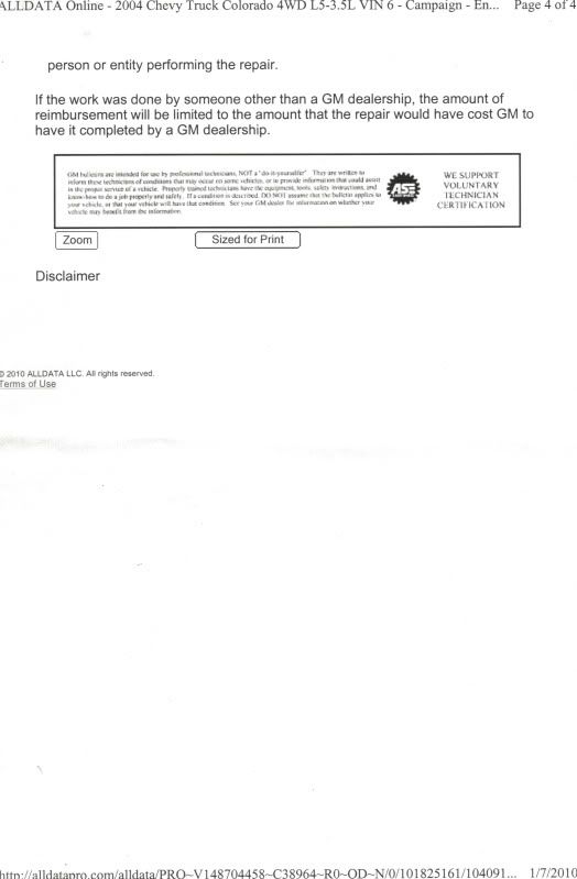

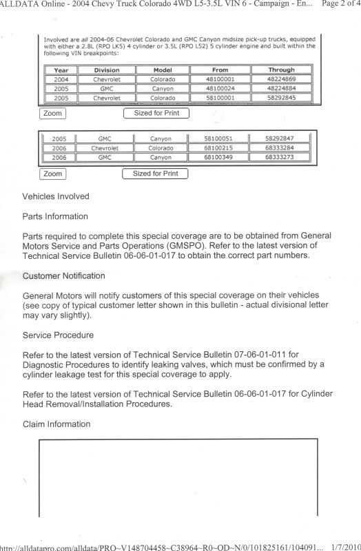

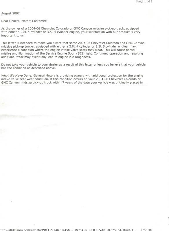

Disclaimer
The Following is a GM direct letter to owners of the Colorado's and Canyon's listed years 04-06, both 4 cylinder 2.8L and 5 cylinder 3.5L trucks. Breakdown of specific Vin inclusion as follows.
Note: This condition may be diagnosed through several DIY methods.
(1) let the truck sit at idle for about 30min. if equipped with aux. and access. equipment such as A/C, systems, lights ect. Enable all. Observe trucks idle; a rough idle should lead to further diagnosis.
(2) A compression check can be used, though more invasive than a cylinder leak-down test. Either will work. Observe compression/pressurized cylinder for a decline in pressure within, be sure the cylinder is at TDC on the compression stroke as you are testing it.
***WARNING*** If you are not experienced in performing these tests bring you truck to a dealer, leave it to them. It is free as covered in attached Scans of the GM direct Recall, and letter to owner.
LETTER TO OWNER
RECALL INFORMATION
