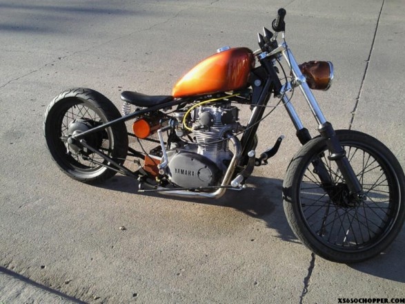

Ok thanks the more I have been looking I keep coming back to the yamaha xs650 and get a hard tail kit and I would like to do a springer front so would the yamaha xs650 be what I should look for or is there a better option and if the xs650 any years to avoid or look for?
Your plans look like a carbon copy of mine. :lmaop:
I believe the electrical ignition started in 80 or 81...right Brad?
Anything from '74-'83 is good. The real early ones '71-'73 had a different frame and other one year only stuff. And like Joe said, '80-'83 is best because of the electronic ignition.
Thanks for the info now I know what years to research it looks like there are plenty out there for sale cheep
