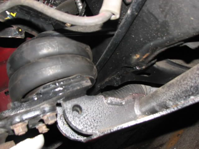

Bad news is, I'm about an inch to an inch and a half from laying out. Good news is I finally took out(most) or my front fender wells and started painting my wheels. I'm hoping some balljoint spacers will do the trick??
ohh, I was thinking it was in November. I will go, if I have my truck still in Dec. Maybe I might still go because who is buying my truck is my friend. I decided to keep it and finish it up and get a few things fixed, and when I do sell it to my friend I will still get to see/drive/work on it. Might be a v8 swap in the future... I think what is keeping me from laying out is the balljoint binding.

the second pic shows how close the lca is to the lca frame pocket. check there. i got lower running stock lcas and bjs, then i did the lcas like you got. if you look were they mount to the frame, i bet your hitting.
i also suggest running belltechs upper angled bj spacer. will help you quite a bit.

Ya, there too fast.3/8 down, 1/2 up, it jumps off the ground an inch when I have full psi and hit it up lol. I hope the dumps slow down a little more once I put on shocks, if not i need to get a dump control or a smaller fitting. Im going to try either getting some bj spacers made from a machine shop, making some, or i might see if i can order the ones from belltech, I hope that does it... I mean worst case I guess I will just need to put some bag brackets on my stock control arms and get the balljoints

i think you'd be better off with stock arms and balljoint spacers, but i'm an idiot.
also i think you are going to run into problems in the future if you want a wheel that's bigger than a 17 or 18 because the balljoints are probably maxed out. look into getting some uniballs.

ya but a 20" rim with a 30 or 35 series tire depending on width is about the same height if not a little higher than my 17s. I just dont want to raise the uppers or pie cut them because I dont want to throw off the geometry and I dont want much camber when layed out, because I like to roll about a 1/2" off the ground as much as I can and that with a lot of camber and my tires would be gone in a month lol. I really need to switch to my stock ones, I just dont feel like having to put brackets on them lol
