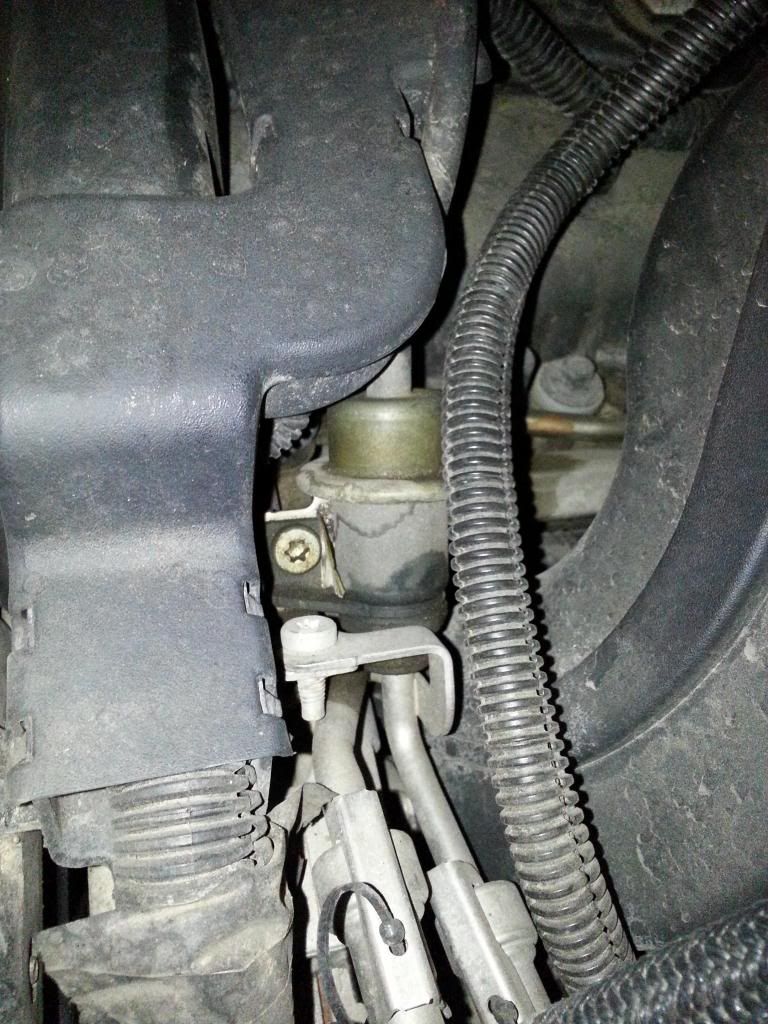

The Fuel Pressure Regulator is located on the front drivers side of the engine. The easiest way to find it is to follow the small vacuum hose from the intake to the top of the regulator (see the picture below). The part circled is the fuel pressure regulator found on '04 and '05 trucks. Starting in '06, GM started using a returnless fuel system and newer engines don't have this part.

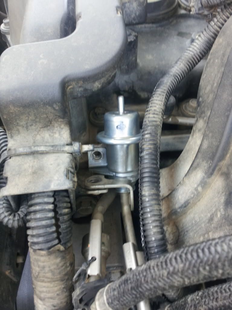

This is what mine looked like (didn't get a picture of it covered in gas):

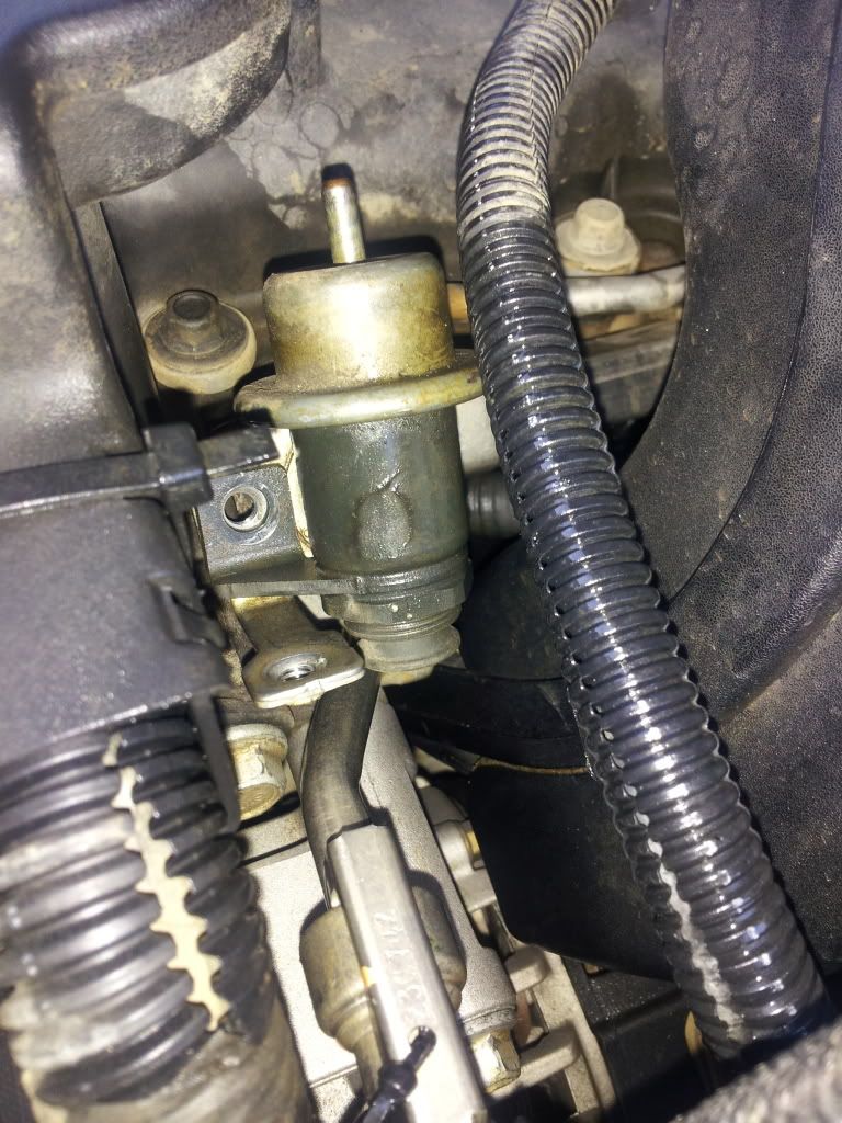

or like this (with credits from xkmacx86)
A way to test the fuel pressure regulator is to remove the hose from the top of the regulator that connects to the intake and start the truck and see if fuel is coming out of the top of the regulator. When you remove the hose and there is fuel in the hose the regulator is bad as well.

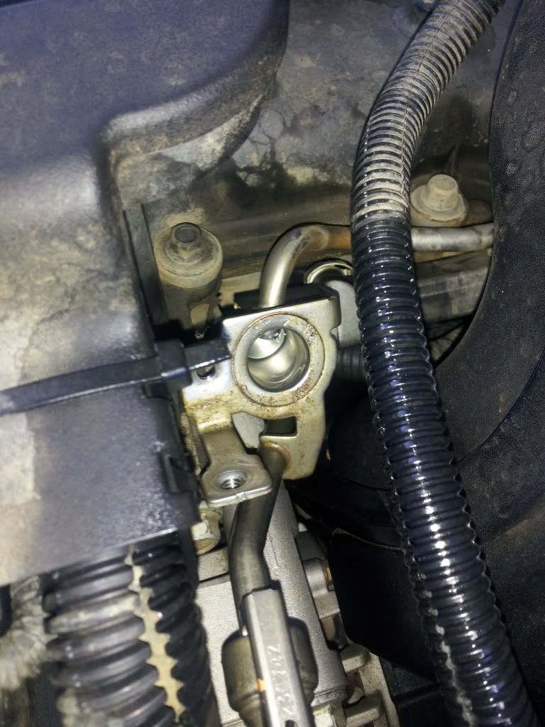

Then pull the regulator out, watch out for gas coming out on this one as there is pressure behind the regulator. You can put a rag around the regulator so the gas does not spray every where.
To install the new fuel pressure regulator the reverse of removal.
