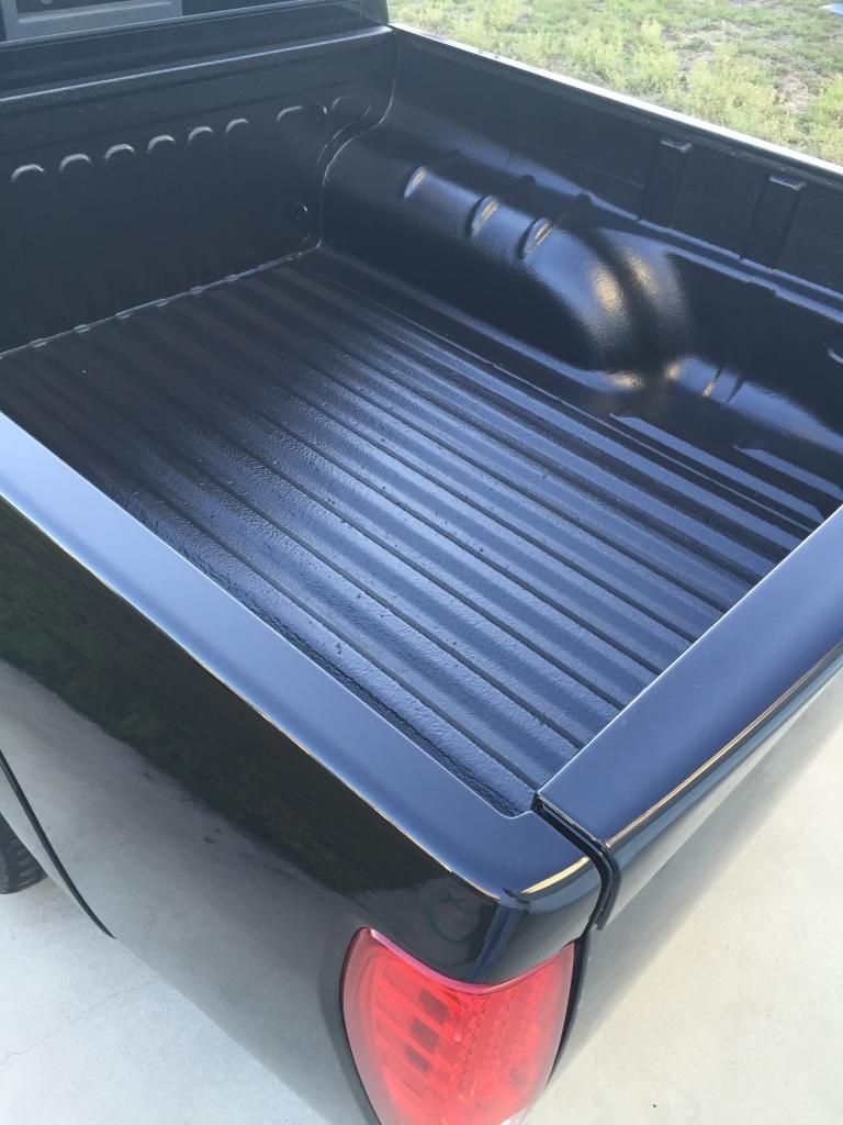

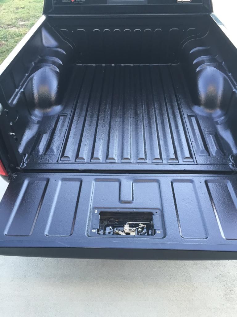

Great idea! I recently did my bed, and so far I'm happy with the out come. Of the people that I've shown it to, they all say it turned out and looks great. I purchased the standard black 1 gallon kit.
Obviously I have the 5' bed, but the 1 gallon kit would have been plenty for the regular 6' bed. It seems pretty durable though I haven't hauled anything to test it. My only advise is to either order an extra roller applicator (kit comes with 2) or thin the mix out good before the second coat. The first roller is only good for the first coat. I thinned the mix out before the second coat, but it was still thick enough to tear up the second roller quickly and leave small pieces in the liner. If I had another roller or thinned it more I could have made it look more evenly applied. It was a good weekend project though, and I'd do it again rather than paying 4x as much for a Rhino or Line-X.

If your question is directed toward me, then thanks, and it will take a good weekend. The prep is whats important. I probably over did it by starting the scuffing process Friday night, and scuffing and cleaning a bunch on Saturday. I went over it again Sunday morning before actually applying the liner. All in all, I scuffed the entire box at least 5 times, but it was probably good after 2-3 times. Have a friend or two help to speed up the process.
After prep work is done, clean one final time and start applying. It took me less than an hour per coat (2 coats), with about two hours between coats. I did have a couple helping hands during application which was almost needed, but not necessary. The directions supplied with the kit will cover everything else important for doing it.
I wouldn't recommend trying it during winter, though it can be done according to the website. It will take longer to cure in low humidity, colder conditions. I felt like I was taking a risk by applying it with mild autumn southern weather. But I'm 100% satisfied with the outcome so far! Hope this helps anyone wondering
