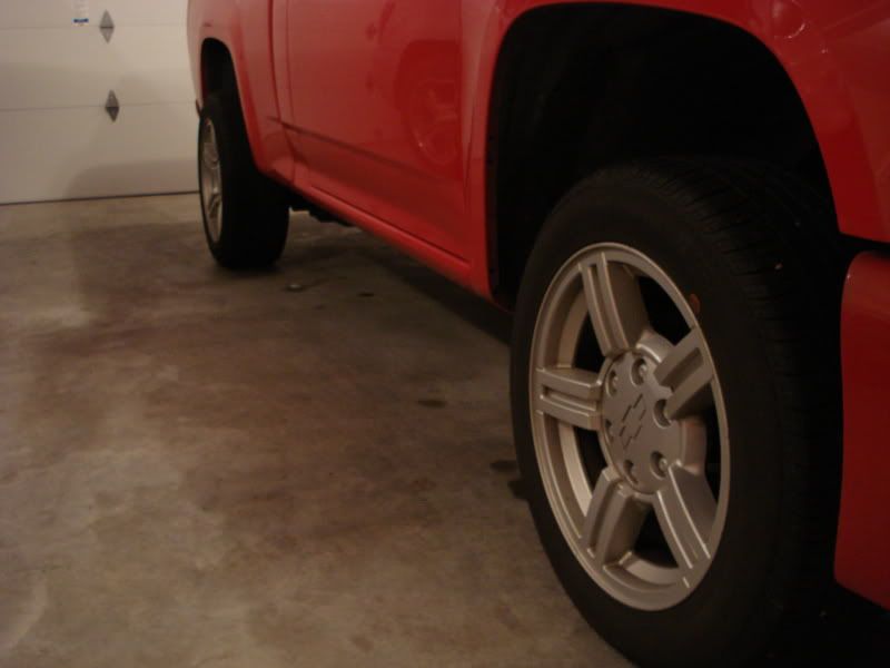

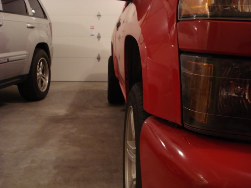

Well I took out my ZQ8 rearend and put in the 4.11 out of a 4x4 Z71 today. I thought they were exactly the same until right before I put it in and double checked my measurements. It is exactly 2" longer (1" on each side). It dosen't really bother me thought I prefer it this way since I'm putting on Z71 flares) I ordered some 1" wheel spacers for the front on ebay in the mean time for the next week while I have the ZQ8 wheels on I get to sport the psudo Porsche look, at least its red! lol
Rear end works great you can definatly tell the difference with the stock size tires on. Once I get some 31's or 32's I think it will be about right. It also added about 1/2" height to the rear.

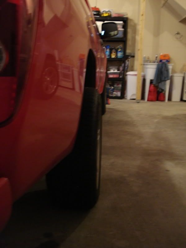

Has anyone else had this issue? I checked mine with some of our race car stuff and it's 1-1/8" out on the drivers side and 1-1/2" out on the passenger why is it uneven? Just crappy QC at GM?
O'well I like it b/c I'm going to make the front match and the passenger rear and space out the drivers to be even.

Oh ok cool. I did a search and found out that the passenger side sticking out is a problem (sorry should have done that b4 asking). I ordered a set of 1.25" wheel spacers for the front off of ebay and got a (2) 1/4" shims off of there for less than $20 to make the drivers side match, may need longer studs not sure yet.
Like I said it prefer that it sticks out I've got Z71 flares on order and was wondering how to fill them out.

only it you move it laterally and dont be smart about it. most of our beds are narrower than the cab. when i bought my truck i noticed it was flush on the pass side and inset on the driver side. so i losened the bolts and slid it over a lil. now you cant tell it was ever off
