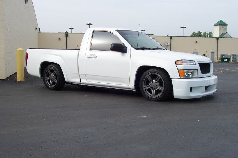

well ill add to the info.
20x8.5 silverado SS wheels
245/35zr20 nexen n3000
3" djm arms, z85 coils cut for 1"
4" djm blocks and removed leaf from z85 leaf pack
4/6 roughly when it lays axle on frame. as pictured its 4/5 with helper leaf and air in shocks.
